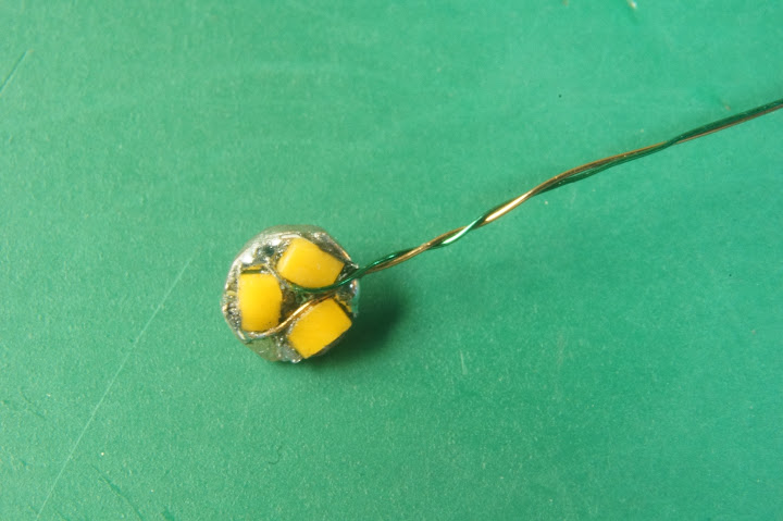

I have no idea if this thing works.
But just to show you the scale, here it is with a MT coupler spring from a 1015.
This is at the very limits of my skills and sanity.
I will still have to find a good high resistor so as not to damage this-- if it even works.

Here is how they are wired.
I made two cuts on the tiny circuit board (black dashed lines.)
Polarity is indicated.
Brown wire is the positive (goes to blue on decoder).  Soldered in two spots as indicated.
Green wire goes to negative and white or yellow.  Soldered only at the end (top).
At this moment, I have no idea if I have solder bridges and thus a short.
So I don't want to test this with my decoder and burn it out..
Later tonight, I will probably hook this up to a 10 k variable resistor (pot) and hook it up to my analog track.
Make sure I am at 10k.
Turn  on the track power, and gradually lower the pot until I see life.
First goal is to see if all three even come on.
If they do, then I can work with my decoder.
« Last Edit: July 15, 2015, 04:29:07 PM by u18b »

Well, your praise was a little premature.
There was a moment when it worked.
Not sure what happened.
So tonight, I made another one.
Took me a little over an hour and wasted 2 LEDs.
Put a big old 10k resistor on it.
And it worked.   Light was a little dim, but it worked.
Then I moved the wires trying to position it for a photo- and gone.
Short?  Don't know.  But that was two in a row and a lot of time.
Soooooo........
After using between 6 to 8 hours working on the headlights, I'm ready to move on.
Not all was wasted.
I'm going with two LEDs behind a blackened disc.
That was acceptable.
Thanks for everyone's input.
It was worth trying.
