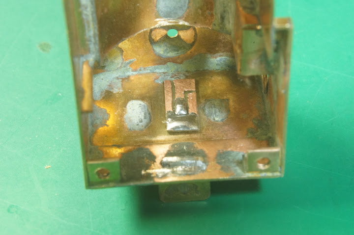

Time to work more on electricity.
The original NJ EP-2 had a terrible jumpering setup between Cabs.
They mounted a socket in the vestibule, and then had a jumper wire that ran between Cabs thru the boiler room.
It was great- when new.   But the wires broke eventually, and it was crap.
So it is interesting in these new EP-2s that Kumata deleted the whole thing.
Hmmm.  Too bad, because the concept was good.   The problem was the implementation.
So I cut a hole in the shell in the vestibule.
I then took a TCS micro plug and socket.  Here is the socket.  And a homemade circuit board.
The board is divided in half- one part for each pin.
Socket is mounted on the insulated side.
And then soldered to the back side.
Laid on the inside of the shell- with the socket projecting out.
And ONE trace is soldered to the shell.  The outside edges.  That still leaves that upside down L insulated.
I insert a plug and get my multimeter to check for continuity.
The two pins are isolated.
And the bottom pin has continuity with teh whole shell.
Now to make the jumper wire plug that goes between the Cabs in the boiler room.
Since the Cabs are charged, we have extra power to ONE motor pole but not the other.
So I solder a red wire to the insulated pole of the socket.
Cut a groove for the wire in the weight.
Install the weight with the wire underneath.
Trim the other end and add a plug pin.
This now plugs into the wiring harness over the motor.
THIS is where Kumata goofed 30 years ago.  The permanently soldered the jumper between the shell and the motor.
But you HAVE to take the loco apart- so this was a real pain.
Now, it is no problem.  Like most of mire wiring and construction plan, everything is modular.
Hook it up and take it for a test run.
Now runs much better because we have doubled the electrical pickup to each motor.
Each motor now draws juice from 8 wheels on one side and 6 on the other.
Performance is much improved.

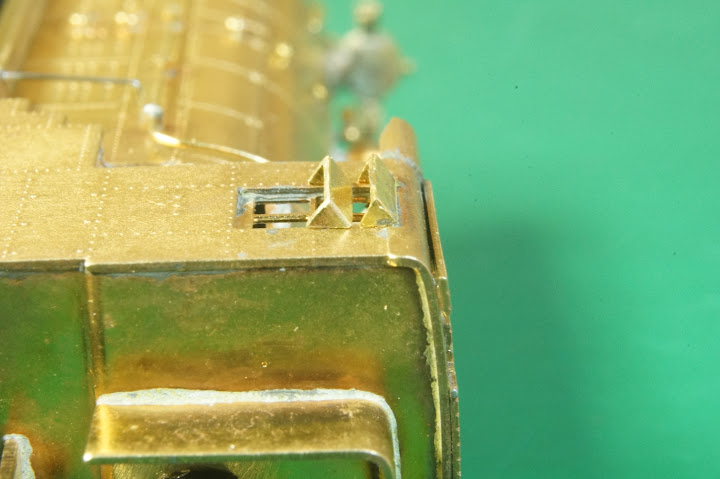

The shells are about finished.
This photo shows both noses.  You can see I has added the grab irons at the curve of the nose by the headlight.
Also the socket on the upper right of the nose.
(failed to mention those earlier).
I used the resistance soldering unit to raise the horn.   While MUCH more stable, it kind of looked dumb and unrealistic laying right on the hood.
Here is the way the plain model looked before I started detailing it.  Note the lifeless horn on the right.
(also highlights the details transformation-  this one almost looks Spartan without all the extras, LOL)
Raising looks better- even though it is a bit fragile.

So I had an idea.
That light leaking is a hard problem to fix.
What if I made sort of a barrel insert for the light.  That might help the leaking.
So I took some smaller brass tubing that almost fit inside the light housing.
I cut a piece, placed it in the motor tool, and filed it thinner while spinning.
I bought some really tiny LEDs off ebay from a vendor in China.
They were very reasonably priced, and much smaller that the LEDs I had been using.
One problem I forget to mention in the post above was that the light was not evenly distributed.
One fiber optic "bulb" was much dimmer.  That's because of the LED placement below it.
So I thought two LEDs might help.
I then take my thinned tube and tin it and solder it to some very thin brass sheet.
Trimmed up and smoothed off.
Marked and drilled holes.
And then trimmed it.
This looks like it might work.
But it still had problems, just like before.
I know this is not as close it could be.  But this is just a test to see if it is worth pursuing.
I concluded it wasn't worth it.
Light leaked out less, but it still leaked out- especially at the bottom.
And once again, the light blended together.  To be honest, it really would make little difference in real life.
While I know that more progress could be made, I concluded I had too many EP-2s to do.  I can't be spending 4-6 hours added a divided headlight to most of them.
