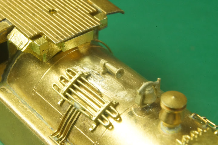

My guess- (it is only a wild guess) is that this curved thing held the very unique steam whistle that was part of the early EP-2 identity.
So the million dollar question for me is-  what is Supposed to be there in the early 50s?
The problems are numerous.
1.  I have collected as many photos as I can.  But it is still not that many.
2. Often times, the angle of the shots is not good enough to tell anything.
3. And lastly.  The area is black.  So it is extra hard to tell anything.
Look at the following photos.
E-4.  A end.  Bad angle.  Far away.
Hmmmm.  This is a little better.  E-4.  Fuzzy.  Don't see a horn.  But that (whatever it is) looks too small to be the hump in question.
E-4.  Wrong end.  BAd angle.  Ignore my notes on the photo).
E-5.  Correct end.  ALMOST a good angle.  But all that blackness.  Can't tell anything for sure.  Ahhhh!
E-2.  NOW we're talking.  Clearly the hump is gone and the horn is installed in its spot.  (why can't I find shots like this of E-4 and 5???).
THIS is actually the photo I can't get away from.
Knowing what to look for.... I think I can just BARELY see a horn up there on the B end.  The back of the horn is at the red line and the green points to the bell.
So since  I can't shake the feeling that by 1950 this loco would almost surely have a horn on BOTH ends (like E-2), I decided to go with my gut.
The hump is coming off.
I'll post how it goes.
(I hope I don't ruin the model   :scared:   :facepalm: )

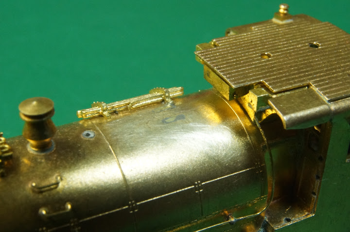

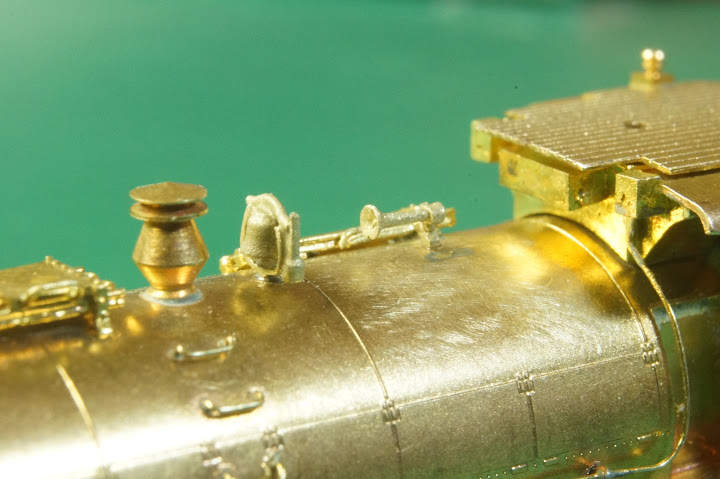

I  used my resistance soldering unit to heat up and remove the curve.
This left two mounting slots in the shell.   Hmm. I wasn't counting on that.  I'll have to fill them.
So I took some brass stock and inserted wedges.  I then soldered them from the inside. I used the resistance soldering unit to make certain I had a good joint.
With the underside firmly secured, I used a motor tool with a cut off wheel to Carefully cut the stock brass down fairly close to the shell.
I know.  It sounds crazy and very risky.  And I was very very careful.
You can see that I came close to messing up- but that one spot was OK.   :scared:
I then used files to VERY carefully make the area even.  Fine sand paper smoothed everything out.
It turned out actually better than I expected. Plus, since the area will be black, any slight imperfections should not be very noticeable.
Now the tricky part will be to mount a brass horn. The tricky part will be soldering it in place since I don't want to melt my good patching work thus far.
The last step was to use a motor tool to cut the excess brass and solder from the inside of the shell.
You can see the spot that needs to come down.
I confess I hated risking ruining this fine brass model.  But all turned out well in the end.
And now the horn on the B cab looks great.

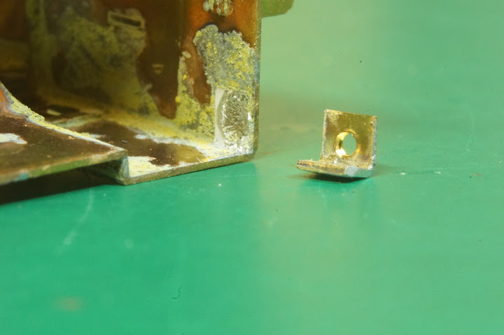

You can see how far out of alignment it is.  I figure the cab on this unit somehow got build not close enough to the nose.
Now, it is not uncommon in these kits to have the holes not line up perfectly.  But usually it is off by a few microns.  A few passes in the hole with a round file to elongate the hole if fine.
But in this case, we are off by a full millimeter or two.   Opening up that hole would make it huge.

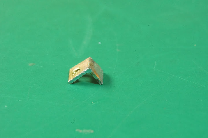

So I decided to fix the brace.
Here it is.
Grabbing it with the resistance soldering electrodes got it off fairly easily.
I then took a file and cleaned up the shell, trying to get most of the old corroded solder off.
I then took some K&S brass channel stock for making a new brace.
The hole would need to be moved outward.
I figured drilling and tapping would be easier before cutting.
I tinned the back and the side with solder.  I used a little bit extra on the back.
This is such a little piece that it is hard to hold on to.  Adding a screw helped.
