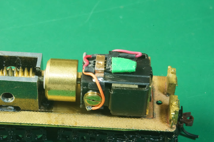

Just when I thought I was through discovering tweaks.....
I stumbled upon a great improvement.
That micro socket is both a blessing and a curse.
It is great for making the electrical system modular.
But the thing comes loose and flops around.
I tried superglue.  It broke loose easily.
You can see here that I added some epoxy to help hold it down.
Better, but a little leaked into the socket one time (yikes!).
And it STILL breaks loose.
It also adds to all the stuff up there.   It is really crowded in there-- even such that it can be tricky getting the shell to lie down and seat properly because something does not settle down right.
Inserting and removing the decocder is what places so much pressure on it.
So here I am building the next EP-2.
The basic mechanism is built and it runs well at this stage.
Time for the wiring harness.
That socket is tiny and a bit fragile.  I wish there was a way........

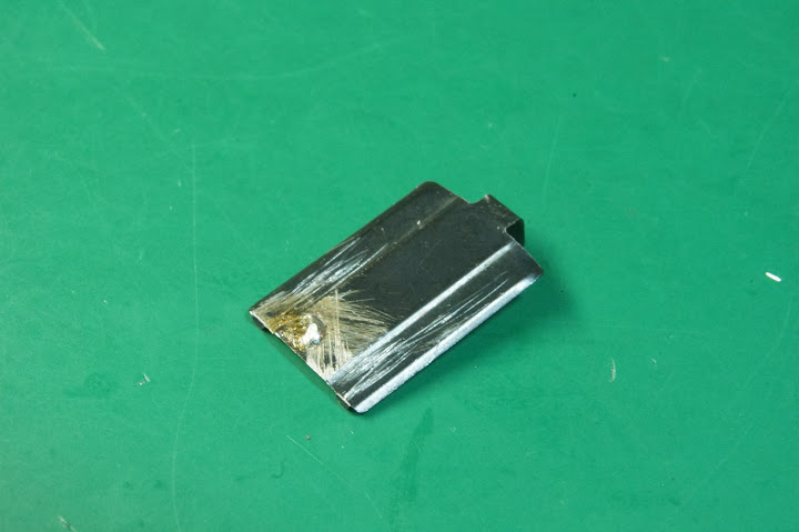

Wait a minute.  An Atlas SD50/60 pick is sitting nearby.
I wonder if I could solder a brass strip over that socket.
Bend so that it is snug and the sides are SHORTER slightly than the socket.   That way it will be tight.
Here is the normal spot where I normally solder the black wire for the socket directly to the motor cover.
But I noticed the backside does not lay flat..........  so why not solder to the underside.  Thus making more room up top.
So I scratched the paint to get a good solder surface.  All the way to the edges.
And here is the new spot underneath.
Outside edges are fluxed and tinned well.
I then use the American Beauty resistance soldering unit to squeeze the parts together, and soldered tight.
That is pretty tight.
Now to do the black wire for the frame.
Folded under and soldered.
Wow.   This worked.  This is SO much better.
Here is the harness assembled with an analog plug in place.
Now I need to do this several more times!
