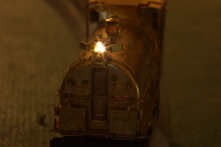

With renewed efforts... I tried again.
I cut a much cleaner disc.
Blackened it.
And did not use fiber optics at all.
Made the holes bigger.
With the exposure cranked down, you can see three lights.
This is more what it looks like to the naked eye.
Better.

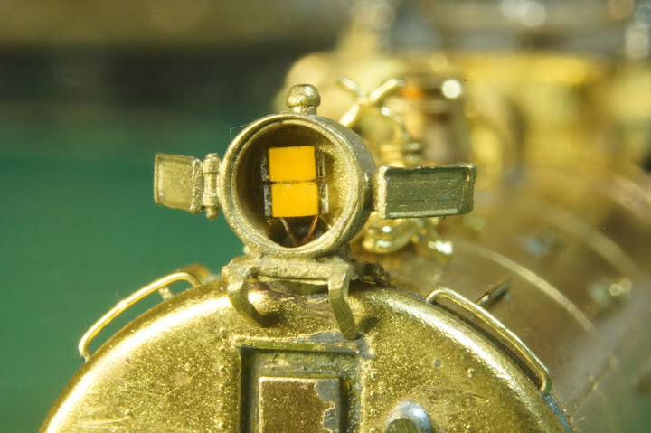

The difficulty with the TCS LEDs (for the current 3-light EP-2 project) is that they are fat.
So recently, I was searching ebay and saw some pretty cheap SMD LEDs direct from China.
So I tried them.
These have about the same footprint as the TCS LEDs- but with no tiny circuit board.  And they are much thinner.  Which is good for getting the 3-hole disc on top of it in this project.
And they are CHEAP.
They were so cheap, I ordered 500 more.  I figured at that price (less than 2 cents each) I could burn thru them and not even worry about the offerings to the carpet gods.
(At that price.....quality?  Failure rate?  Don't know.  I did wire up a pair and just left it in the layout for several hours to see if it would burn out/fail.  But I saw no problem).
In my latest application, here is two of them mounted in parallel.
So as you can see, with a little filing, I MIGHT be able to get three in there.
But it would be hard.
And....  I'm thinking it would be so blindingly bright that the effect would be diminished.  You would not see three lights-- just one REALLY big and bright light.
What I would have to do is a lot of experimentation to find just the right resistor to lower the brightness of three- so that you could actually see three lights.
Edited:  Besides, that does not even consider the FOUR headlight version!   That will be when I make E-2.
