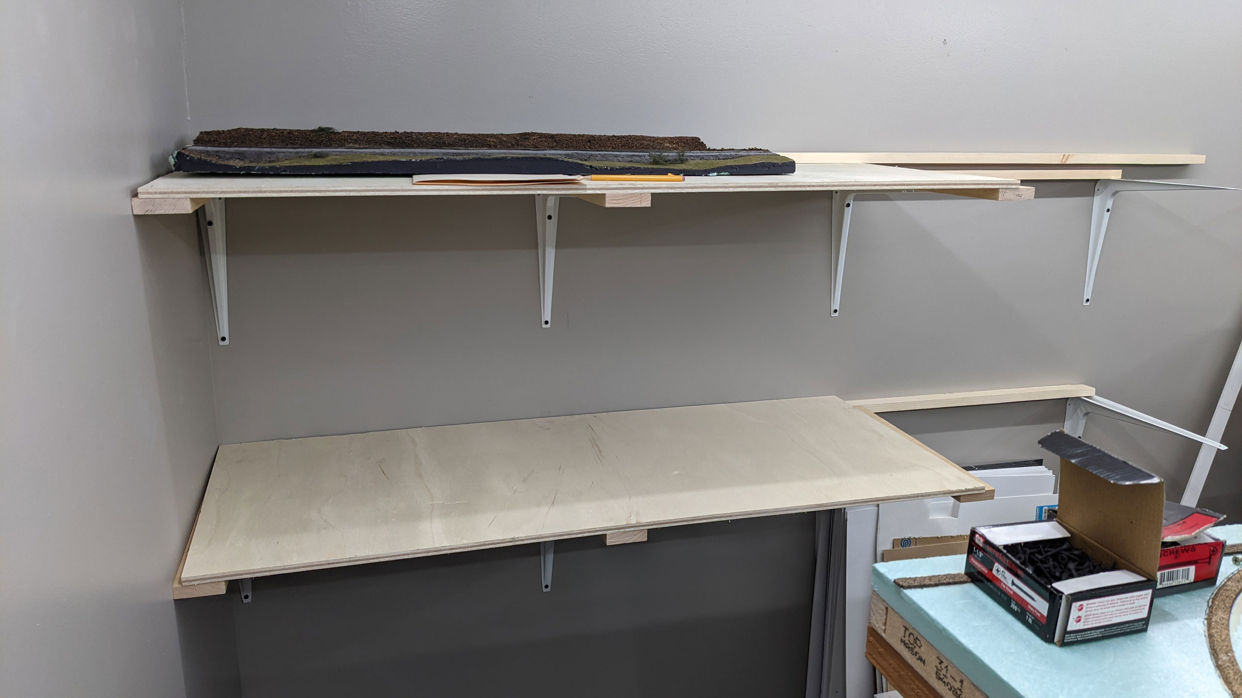

I think he means that if you push them UP they might pop up. The weld holds them in that orientation while the forging (?) of the metal bar holds the regular load force.
Ah. Nevermind.
I'm on the fence about those brackets. On one hand, they're SUPER sturdy looking (in the downward direction). On the other hand, they're also heavier than the benchwork they'll be supporting.
Well, I will add that I've had plenty of brackets just like the ones you are currently using on the wall fold up like paper... bear in mind that you may have occasion to lean on the benchwork harder than expected. Wouldn't want you to end up on the floor along with your CR rolling stock...
That's exactly what I was talking about. Was an accident, but it did happen. I have those brackets in both garages for storage shelves and they have been fine. Just something to keep in mind.

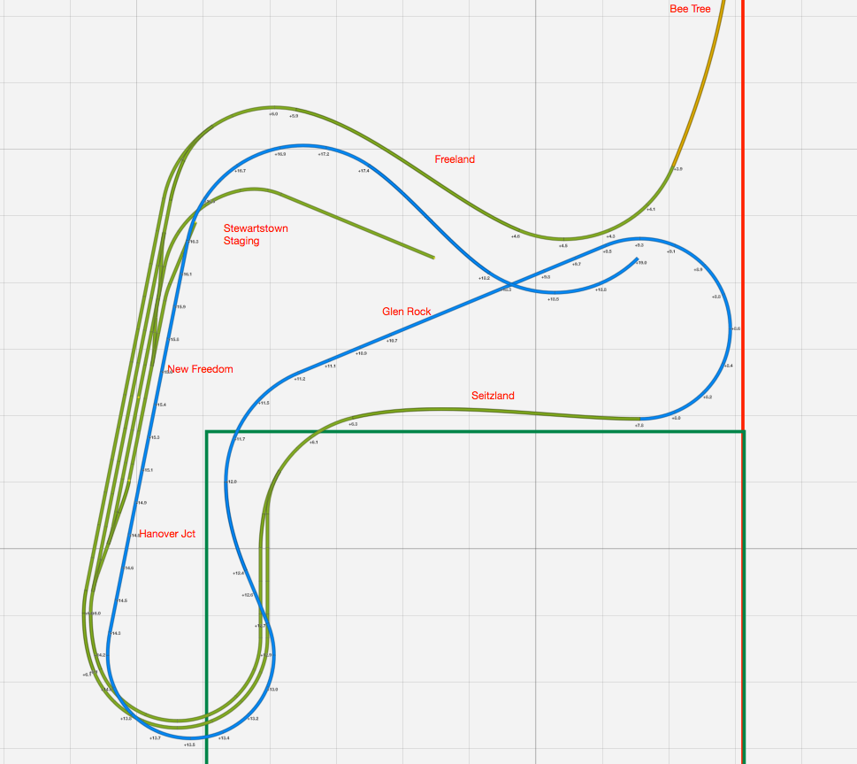

More progress.
First some virtual updates.
After getting some things going, I realized I wanted to try and open up the aisle a bit, so I canted the peninsula back a few degrees so there's only a 36" pinch point at the very end. I also cleaned up some of the looping and added a few more straightaways. Lastly, I started placing some town or location names for orientation.

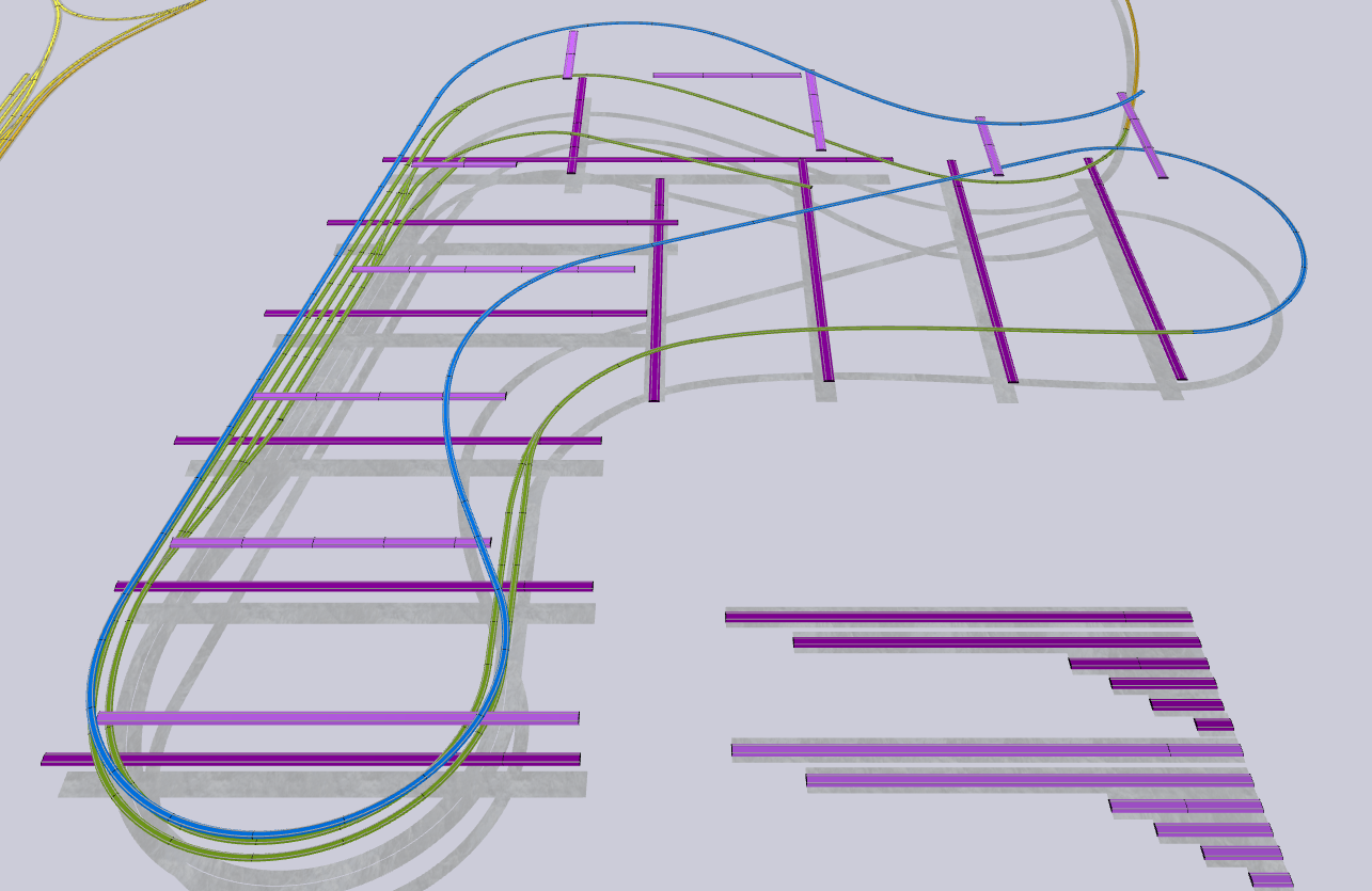

Next I started doing some benchwork planning for the peninsula. I'm thinking it'll be a version of L girder with risers to support cookie cutter roadbed. Annoyingly, RailModeler Pro's benchwork options suck. So I decided to just use HO track to represent the girders. It generally works. Now I know what I'll need girder wise, at least.
And finally, some actual physical progress yesterday. In addition to stocking up on foam, I also got the deck and supports in for the first lower deck panel.
