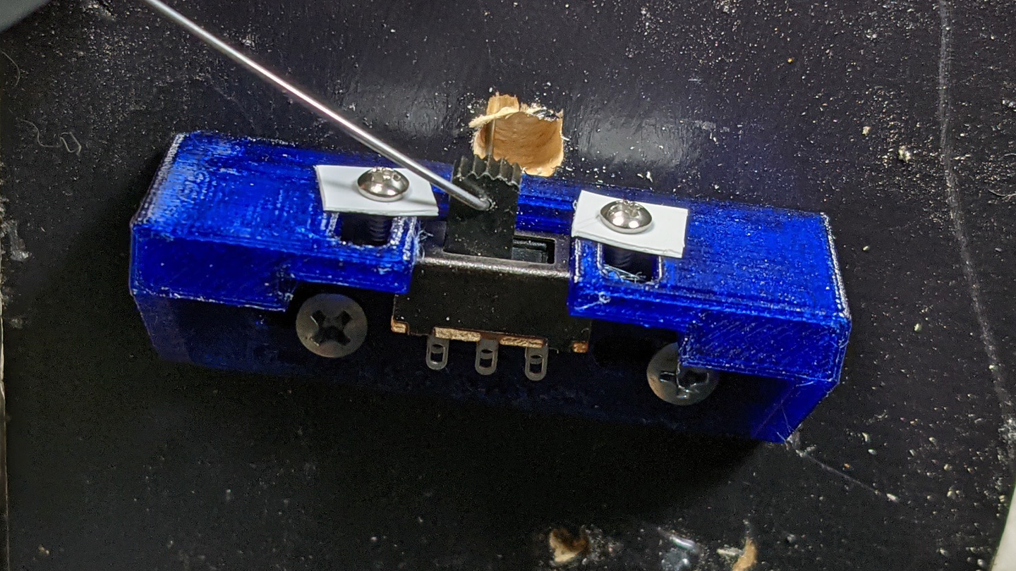

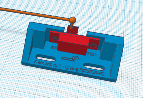

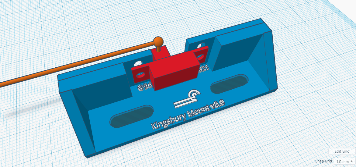

I'm in a bit of a holding pattern while waiting for my AC unit to arrive so I've been working on some other fronts.
Specifically, working on the under-table mounts that I'm making to make implementing @skytop35 's slide switch solution. These make it easy to mount everything with screws AND importantly, give me the ability to make minor adjustments (a trick I loved on @rodsup9000 's awesome Tortoise mounts).
The original concept.
To reality.
And now to refinements.
You can see my original print left the screw holes way too large (hence my ghetto a$$ washers) and was larger than really necessary. I also need to get some of the Dude Bro hardware to test fit it and see what I need to do to accommodate it.

Did you get the throw distance and force vectors all straightened out?
  • Posts: 26152
  • Respect: +11679
Re: The New Northern Central
« Reply #348 on: March 26, 2021, 10:50:15 AM »
Yeah. It seems to work fine. The only way to improve it would be to use a larger switch since the ones I got off Amazon were smaller than the ones that @skytop35 used.
