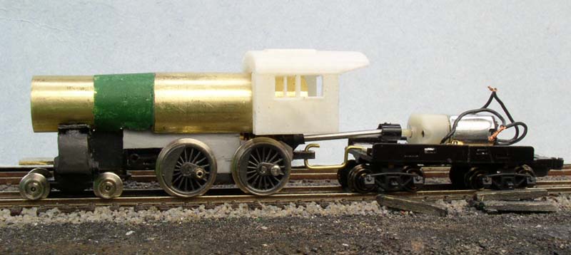

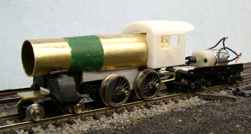

« Reply #62 on: May 25, 2020, 09:20:48 PM »
Well, here's where I'm at.    I decided that although the one driver isn't perfect, it means I need to snag another Rivarossi 4-6-2 main driver, which I don't have.   I have about everything else including extra Bachmann axles.   But, I can always swap that out in the future, meanwhile, I have kept building this thing as there are a lot of other mechanism, fit, and drive issues to solve.
I made a raw brass boiler out of K&S tubing and tapered it with Squadron, filed smooth.   The cylinders are the original Rivarossi, filed to shape as they are the right dimensions but need tapered to the inside.
The pilot truck is 'good enough', particularly when it has to clear the cylinders.   While I've turned the driver flanges I haven't bothered with the pilot truck yet, that can be later as well.
Today I fit the brass pilot deck, cylinders, and test fit the brass boiler on the heavily cut-down Bachmann chassis.   And I test fit the resin copy of the Trix cab, which is too long, but you get a feel for the overall dimensions pretty quickly.
The key dimensions - wheelbase, wheel diameter, boiler diameter, top of rail to top of boiler....are all dead-on to my PRR drawings.   As well as the tender wheelbase and length from the rear driver.
There's lots and lots of room in the boiler to add weight and rebalance it to the axles.    So... I'm roughing out the critical issues here and test-running it to see how this goes.   The one good thing is that the pilot truck clears the cylinders down to a 9 3/4 curve.
I hope that you reconsider.
Those look comically small. They are bout 25" in diameter (with the flange being 36" diameter!). Turning the flanges down will make them look even weirder.  If those tiny wheels with huge flanges clear the cylinders, larger wheels with smaller flanges should too, and would look 1000% better. I think that low flange 28" or 33" wheels would work and look more realistic.
It pains me to see someone spending all that time to  almost scratchbuild a model while leaving somethgin very visible  (like pilot wheels) looking so unrealistic.

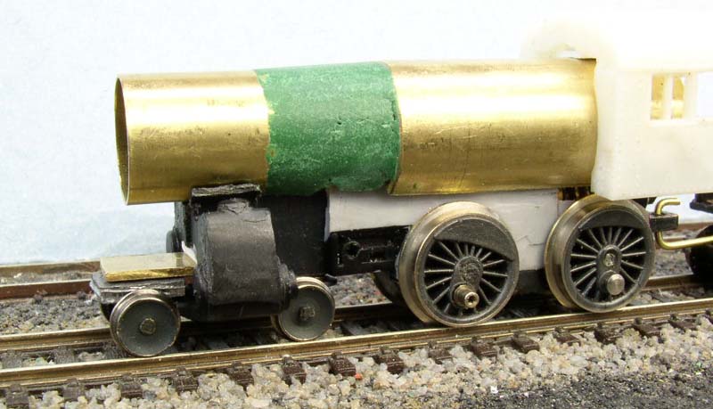

I just scored a broken junker 4-6-2 on the auction site last night, which will give me a bunch of parts, including another main driver set and another pilot truck.
The main driver is already planned to go to Narrowminded (Mark) so that he can do a better job of mounting the driver on the Bachmann axle than I can with what tools I have.
The second pilot truck, or more accurately the frame, allows me to experiment with putting in bigger pilot wheels with smaller flanges and see if they will still work.    I wasn't sure how much room I would end up with under the pilot deck; I think it will work, worth a try anyway.  But even on an 11" curve, the deflection of the pilot truck laterally is ...wow.  It's really moving around under there.   Nothing against improving appearance, but the darn thing still has to run well or it's just not worth doing.

Randy, when I made my SP&S 4-4-2 out of one of those Rivarossi frames, I put Fox Valley 33" wheels into the original pilot wheel frame.   I did have to ream out the circular passages in those little "fingers" that hold the axles in, because the FVM axle is thicker than the original Atlas axle.    You need to be really careful there, because there isn't a lot of metal to spare in the fingers.  I think I used a little 1.5mm chucking reamer and just twirled it inside the circular openings with my fingers.
I had to add an insulating washer behind the "dead" wheel in each wheelset, because it kept finding a way for the back of the wheel to graze the frame and short out.  I buzzed off the pointy ends of the axles with a Dremel as well.
Here's a pic.  It does fit, and it can definitely make it around 15" curves.  I don't know how much tighter it could go.   11" is probably pushing it.

« Reply #70 on: May 27, 2020, 08:03:56 AM »
I don't need 9 3/4 but I do need 11" for the modules and my reversing loops.   But with a second (expendable) pilot truck we'll give something like this a shot.

« Reply #72 on: May 28, 2020, 05:05:23 PM »
I got a set of those Fox Valley wheels from somewhere, at least I think they are Fox Valley by studying the dimensions and photos.   Also have some of the narrow-tread BLMA that have thinner axles.   When I studied it, I think it will work, at least worth a shot here when I get the second pilot truck in.  If nothing else I'll then have two interchangeable pilot trucks, one with wheels that Peteski can tolerate looking at without pain and another one for when I actually have to run it!

« Reply #74 on: June 09, 2020, 08:53:40 PM »
It is with great reluctance and with tongue firmly in cheek that I feel obligated to announce that....
Peteski was right.
I was highly skeptical that this would work; the spare junker pilot truck was modified with the FVM wheels and the points ground off per Max.   When I first tried it, it derailed on about everything (ah-HA!) and I decided to add just a little slip of lead on top of the lead axle.
Damn.  Works great.   Now this is a pretty crude test of the idea, but it's still a tracking test at this point, and I put it through the entire layout and it neither hung nor derailed.   So....  I have to admit it.  It worked.
Mark (Narrowminded) now has my spare driver set now and is attempting to make a more cocentric set than what I could with my tools.
This really runs pretty well.  After I get the wobble out of the lead driver set I think I have a winner, at least for the drive.
