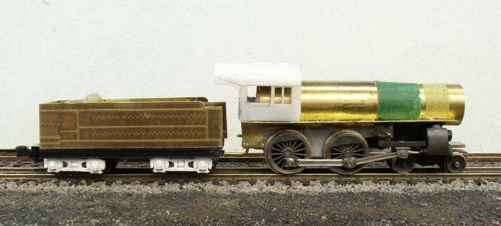

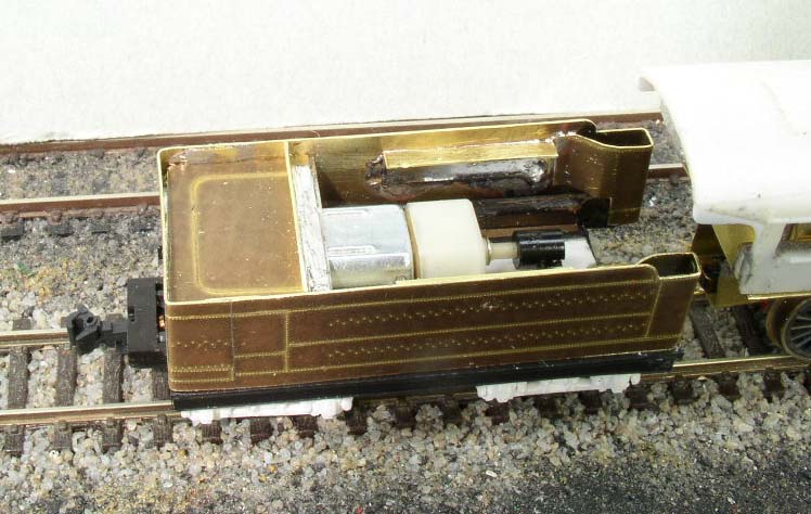

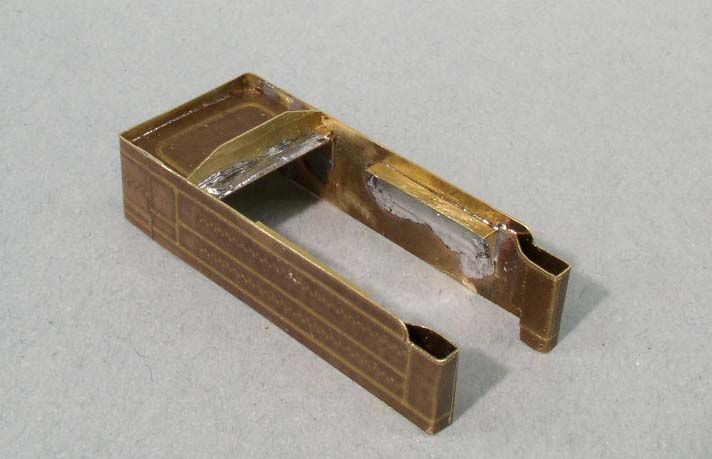

  • Posts: 3283
  • Respect: +3005
Re: PRR D16sb research for a build
« Reply #95 on: November 22, 2020, 10:52:30 AM »
+7
OK, some progress shots.
Now that the locomotive is weighted up, I need to load up the tender as well for the final electrical contact tests.
And that starts a chain reaction that I need to get the tender body made to figure out how much space I have and where it is.
When I did HVRR #5, I used etched brass tender sheets from RLW, which wouldn't seem to work as they are Nn3 parts, but I discovered they work for small steam, were wonderfully done, and were fairly easy to work with.   I'd ordered doubles because I didn't know what I'd have to splice, and now years later those stashed sheets are coming out.   What worked was the dimension of the sides - this is a small tender, and I had to splice in more material to get a 10' wide tender and slightly longer.   That's all soldered up here:
I really like working in all brass when I can.   It's taken me years to get my soldering skills up to par to splice sheets.  And yes, I know I need to add those diagonal rivet lines that show so well, I'll add Archer rivet lines much later.
Here's how it looks from the top, fitting around the motor and gearhead:
As you can see, there's room in there for lead, on the sides, and I'll hammer it out and add it probably today
And here's what this all looks like from the side.  I was really pleased that 'in the end' the edge of the tender lines up with the bottom edge of the cab window (when you add weight and depress the pickup springs) and the trucks are 'tucked up inside' the frame edges as they should be:
Now, I used black styrene .020 sheet to make the sill edges and drop it over the frame edges there.   Those truck sideframes are Shapeways, filed the Kato truck sideframes off and added them.
So far, so good.  And you can see how I modified the cab roofline, shortened it in height and length, and filed the windows out.
Hey, you guys got me the drawing source, without that this was just a someday dream.  But this is about a 9 on the 10 scale for difficulty against my skills and tools.
« Last Edit: November 22, 2020, 11:04:54 AM by randgust »

« Reply #96 on: November 22, 2020, 08:57:33 PM »
Loving me some PRR “Dolphin” trucks. Are those the ones I have that use Bachman needlepoint contacts?
  • Posts: 3283
  • Respect: +3005
« Reply #97 on: November 23, 2020, 08:33:54 AM »
Nope, those are Kato caboose trucks in a shortened Kato caboose frame, filed off and replaced with the Shapeways printed sideframes.
I also got a PRR slotted pilot and the water scoop for the tender from Shapeways, although I'm not exactly sure that was standard equipment by 1927 on the survivors.
This is the third small tender I've built this way, all of them are just wonderful performers, and the fifth use of the RLW etched tender brass sides.  And, of course, putting a gearhead in the tender goes back to Chris333's first effort on the Atlas 2-6-0.
« Last Edit: November 23, 2020, 08:36:29 AM by randgust »

  • Posts: 3283
  • Respect: +3005
« Reply #104 on: November 24, 2020, 11:05:13 AM »
Remember your settings here are only your settings here for this site - not a universal browser setting.    You'd have to have a hacked image posted to Railwire.
What baffles me is that unlike other websites, if you have a non-secure image posting link, at least you get the empty image box showing so you know there is an image there you can't see.   My signature shows that way here but my other posted images don't, and that's a Railwire-exclusive mystery.
Meanwhile, back at the project, after loading up the tender with lead and reassembling the driveshaft again, I ran it around the layout some more.  The lead dampened a lot of the tender/motor vibration and you can hear it clicking over rail joints.  Mark's (Narrowminded) precision work on the drivers and axles was a real turning point, as the fixed wheelbase on this thing is so short than any irregularity on the drivers is magnified, and it's running flat and smooth.   I've done so many special builds that didn't really perform the way I expected (remember the TP56 critter build on the Roco truck?) that it's just a complete relief that this is running the way I'd hoped it might.
