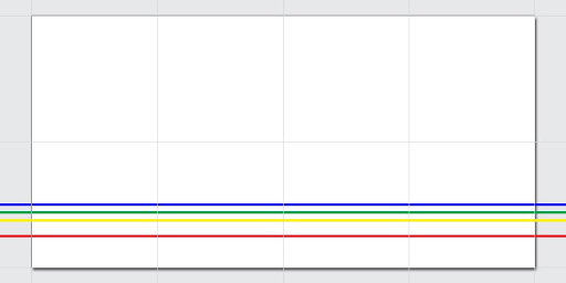

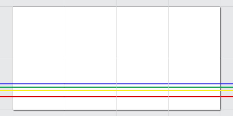

So I think I figured out how to deal with the track spacing thing tonight.
The BANTRAK onetrak standard for track spacing is the NTRAK 1.5" for compatibility sake. Extrapolating that out to the full 1-2- -4 spacing, we'd use up a lot of space. But what if we used that for the 2- -4 part?
See:
The Red Yellow and Blue are regular NTRAK spacing, the green would be my suggestion for where to put the additional track if using the onetrak spec, and making the red and yellow the two through mains carried over from the spec.
Wouldn't that put the yellow and green tracks only 0.75" apart? That's way too tight--only 10 feet in scale. Lots of equipment is 10.5 feet wide...
...unless I'm misunderstanding the diagram, which is quite possible.
See:
So that leaves your spacing between yellow, green, and blue as 3/4" each? Why not just leave red and blue at standard Ntrak location, and space Yellow and Green at 1" between them? (so it would be RED-1"-GRN-1"-YEL-1"-BLU ) Then to drop in with a regular Ntrak layout, you only need a custom joiner made up from an 18"R atlas snap track, cut in half with half reversed, to shift the Yellow 1/2" backwards. (each module builder *could* build a pair of 12" adaptor modules if desired, but it's not actually necessary.) People could even build their modules as the 3-track version if desired, leaving a 2" space where the Green track would be.
I'd also label the Green track as Brown or Orange to differentiate from the established Ntrak Green line, but that's just personal opinion.

I really just picked green because it was between yellow and blue...
I don't think we need to go 50% between the two, but adjust the spacing so that it gives the correct illusion.
Okay, so..... that still doesn't change the fact that 3/4" between mains is not sufficient. 1" is tight, but works out to 13'4" center-to-center track spacing, which is actually prototypical.
By that logic, with a 4-track mainline (with or without track 3) works out to 3" center-to-center on the outermost tracks. Red-yellow-blue are spaced 3" across the group. What's wrong with moving the yellow (and green) to equal spacing?
