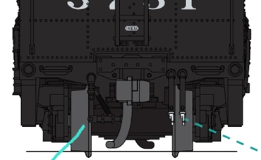

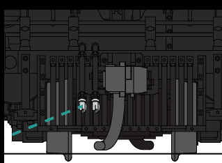

A little more info on those ala carte MU hoses. According to BLI tech support, the reason they don't come preinstalled is that they interfere with the play of the couplers and drastically limit the radius of curves the engine can handle. Thus, they are included for static display purposes only.

robert3985
  • Posts: 3607
  • Respect: +2005
Re: BLI N-Scale Announcements
« Reply #141 on: October 01, 2026, 10:39:44 AM »
-Mark
That explanation maybe works for the brake & steam lines on the rear of the tender, but, if no helper is ever going to be used (or if the engine isn't going to push, or pull a train in reverse with the train coupled to the pilot), mounting them on the pilot, and mounting an N-Possible Coupler in the pilot's coupler pocket isn't going to limit anything.
And, if the buyer's layout has larger radius minimum mainline curves, such as 18" or larger, maybe they won't interfere either.
I would be informative to know the minimum radius at which they won't interfere.
Just sayin'...
Perhaps one day, manufacturers of N-scale "scale" train models will make brake hoses and steam lines out of a flexible, durable material, such as rubber or neoprene...or a super flexible black 3D resin.
Seems like I remember a rumor that one manufacturer (Atlas maybe??) had promised rubber brake hoses a few years ago...which would make them extremely durable as well as flexible enough so that interference with coupler swing would be minimized, maybe eliminated.
