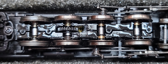

On another note, anyone else notice the middle two drivers don't actually touch the rail? This is most evident by running in one direction, stopping, and reversing direction. The third driver will spin in the air until the slop in the rods runs out and then the fourth driver will begin to turn and actually drive the loco. Is this typical of BLI steamers? The only steamers I've owned up to this point have been the Kato GS-4 and FEF-3, both of which have suspension of sorts to equalize the drivers, and the 3751 clearly has no such engineering.
Am I seeing a (perhaps somewhat too thick) traction tire on the 4th driver?  Or are my eyes playing tricks on me again?
Your eyes are not deceiving you.

If the third driver spins before the others engage, then it must be gear-driven.  So, definitely not supposed to be a dummy.
Maybe check whether there is some sort of suspension that is stuck, or maybe due to a traction tire being too thick on an adjacent driver.
Looking at the (somewhat blurry) picture, I am wondering if there should be a traction tire on the 3rd driver and NOT on the 4th driver.  Which drivers are actually gear-driven.  (For my tastes, the traction tires should be on a gear driven wheel.)
-Mark
What a strange design.  Only the 3rd driver is gear driven and yet the traction tire is on the 4th driver, driven purely by the siderods.  It is a really bad design to have the driver which pretty much provides most traction in the model to be driven by siderods while the actual driven driver just sits there over the rail looking pretty. Even if all the wheels were on the rails, that is still not an optimal design.  They should have placed the traction tire on the gear driven driver and had the fourth driver be strictly cosmetic. Kato did that on their 4-8-4 locos, but they gave it soft springy suspension so it actually rode on the rails (and also picked up power), not hover above.  Model mechanism designers should pay more attention to Kato's designs - they are quite clever.
