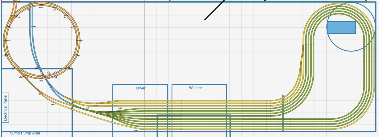

« Reply #1482 on: September 22, 2026, 11:56:18 AM »
As a result of the success of Seidelmann Run I've been doing a bunch of layout planning lately.
Working somewhat backwards, here's the latest staging plan.
Now that the water heater has been replaced I think this might be the next phase to actually begin construction.
What I don't like: It's actually only four tracks (six with the shorties in the front).
What I do like: It fits! And those four through tracks are long enough to hold multiple trains on them. There's also plenty of "shotgun staging" in that helix between the decks in the upper left.
Tell me what I'm screwing up with here.

« Reply #1483 on: September 22, 2026, 02:40:30 PM »
Do you really want that single track? Wouldn’t it be better to have crossovers/scissor crossings? It’s more complex, but this design has a bottleneck built in.

« Reply #1484 on: September 22, 2026, 06:47:45 PM »
The switches also at the end of the helix and could have all sorts of issues unless they're still on the slope of the helix,
