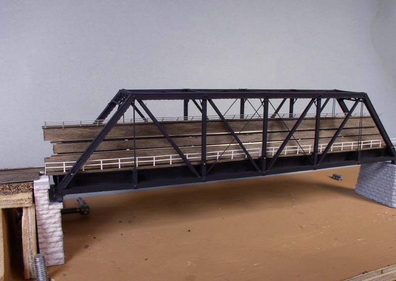

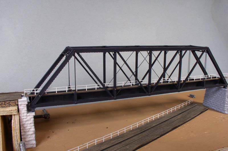

OK, so while I'm working on the second and third spans, I think I finally figured out the handrails on the first.
I decided to go with something easy - Gold Medal Models industrial railings.  I painted a set up white and did a test shot, and decided two things - they look more massive when painted white on a black bridge (good) and were possible to mount on my stripwood deck rails.  Finally, they were tough and could take a beating.   So I did the first span, and now, after painting it with that Rustoleum charcoal black and with white guardrails on it, this is beginning to look like a finished span:
OK, now, here's why I went through all the design grief, which typical to me, made it far more complicated than it probably needed to be.  If you remove the span, you can still tilt out the deck for cleaning.  One rail is secured to the deck, one rail is secured to the bridge, so when its pushed in there it's really locked down tight and flat.  Yet you can pop it up......
and out, and lay it flat to clean track.  Because any bridge this long is sooner or later going to get so dirty you can't get anything over it and you can't run anything through it to clean it without breaking something.  So, this is what I came up with.
This may be unique to the design issues of this bridge, or it may give you some ideas.   I've never seen anybody make a removable deck out of a bridge before so you could clean it, but for this one, it kinda had me stumped.
The more I work on this the more I admire Mark Dance.  Just sayin'.!
One thing that did surprise me when I got the span done is how invisible the track is.  It looks like a road bridge instead of a train bridge.  I'm not sure that's what I wanted, but that's probably the truth of the prototype as well.
I've got to catch the other two spans up to the first one, this may take a while, then we'll start to figure out how to do the abutment mounting so that everything doesn't slide around and I can still get it apart.
« Last Edit: March 07, 2017, 09:32:25 PM by randgust »
