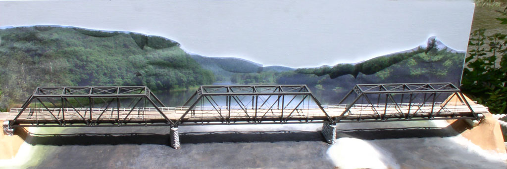

OK so here's an update.   I finally got all the plasterwork done on the module, and this weekend I actually got to paint the riverbottom.
I have my own philosophy on this stuff, I'll let final results be the judge, but I got a whole assortment of acrylics and spent a good portion of the day yesterday mixing and shading to match the temporary backdrop.  This is just the inkjet printed one on regular paper, final will be high-res and laser printed.
So, the great advantage in modules is that you can haul them outside and see what they look like in sunlight.   Finally......

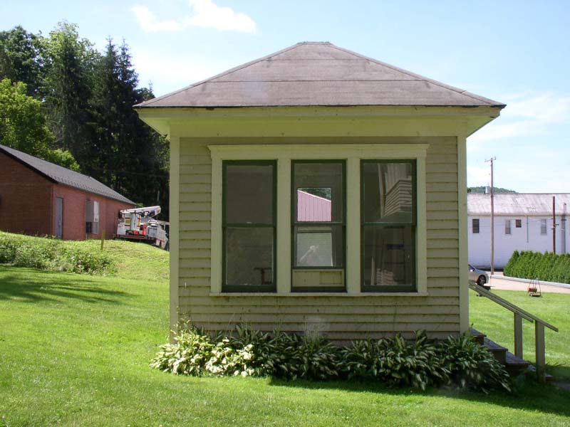

The other MIRACLE is that I discovered that yes, the original tollbooth survived and is preserved at the Forest County Historical Society.   If you go back to the beginning of this thread you'll see it in the 1924 shot.   This is a shot I took for scaling, it is only 11 x 13 feet.
http://www.randgust.com/WHTB2.jpg
Not bad for something built about 1897:

I wish I could always find a perfect backdrop image like that one. Whole scene looks great.

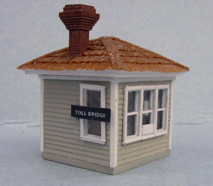

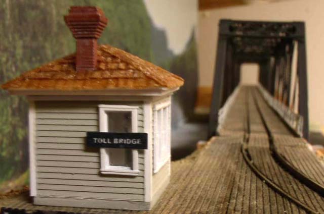

OK, tollbooth is done.   This thing is tiny, only 11x13.....
I'm getting there...   Oh, and Ed, this is why I wasn't worried about C80 on that adapter curve.  I didn't lug this outside for the test, but I still had to try.
Compare to the 1925 view:

Nice booth Randy!  Also clever model photo taken from almost the same angle as the proto. photo.
