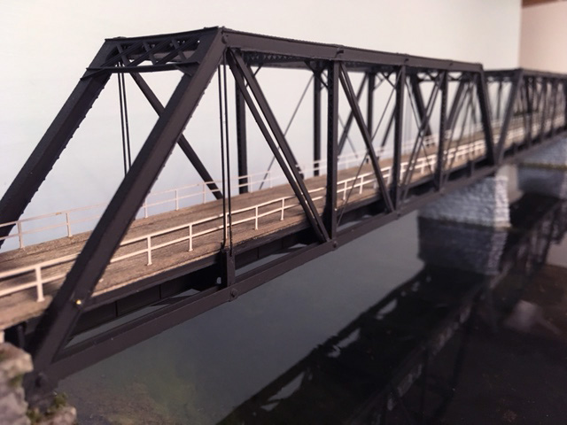

OK, water is done, it's rock-hard, and it looks good to me. I had to have some fun just with the reflection in the water.
Oh, don't freak out about the missing backdrop. It was a temporary. Permanent one was laser-printed today, just haven't mounted it.
Wow, I'm a new fan of WS Deep Pour.

The transition from the bank to the deeper part of the river is incredible! Well done sir!

The product results look great but my only criticism is that this is supposed to be a river, correct?
Shouldn't a river of this width exhibit some movement like current?
It looks like a lake on a perfectly still morning.
