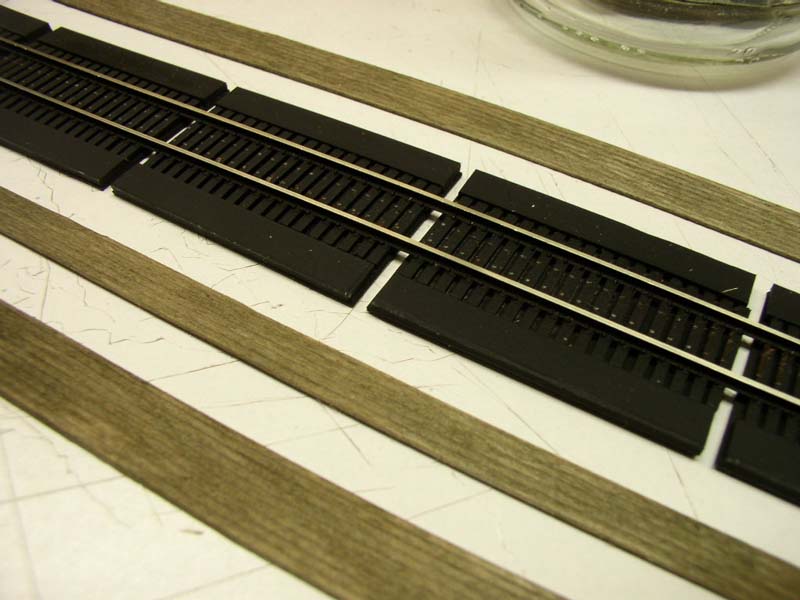

Meanwhile, back at the build.   The biggest modification so far is building the full-width deck.  I tossed the tie strip that comes with the kit and got a chunk of Micro-Engineering bridge flex track with Code 70-rail.    I then cut out ties to match the original pattern of the CV tie strip as they drop down between the main cross stringers.   That worked, and worked well, so if you aren't doing a full deck like I am that's still a great way to put track on this thing.
For me, I put .020 styrene plates of like 14 x 24 feet and goo'd those lightly to the ties - not the stringers - so the whole track deck still lifted out of the truss.  I then put strips of .060 styrene beside the ties so that it was more or less level across the track and I could wood-deck on top of that.   Those got ACC'd rather than cemented to minimize warping.     The wood deck is scribed basswood stripwood that comes in one foot lengths, pre-weathered with Micro-Mark tie stain.  Center is already glued in, side pieces just fit in for the moment.
I'm trying to keep the deck plates removable for cleaning, as with three feet of fragile truss, how I'd ever get in there to clean it is an issue.   I still haven't figured out how to do the railings right.  They are painted white so they will really show.  I'd prefer metal as either wood or plastic is just too subject to breakage, but I haven't seen a two-rail etched plank railing yet except what simulates a thin cross-section more like pipe rather than wood.   (see that historic end shot link)  I need about six feet of the stuff, any ideas?

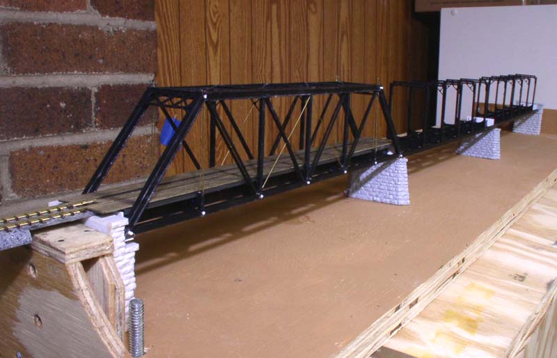

Well, today I made some major progress.   Got the approach leveled up with the adapter, which gave me top-of-rail.   Got the Chooch cut-stone abutments cut (only had to take down one stone level from the bottom) and fitted to one end to get the top-of-rail lined up there.  I've got to shim the bridge end up about .030 to make everything work, but not a problem.
That gave me the elevation for the Chooch cut-stone center piers - got a pair of those.  West Hickory is tapered only on the upstream side, but there's no way I'm ever going to make a better-looking pier than that, good enough.   I cut them with a Zona saw, tough cut, but did cut square and smooth.
And, I glued up the stringers on the second and third span to check (for the first  time) the total span length here to make sure this really is going to fit within the 'triple' T-track dimension length with the abutments and all three spans.  It will.
Here's the first span with the deck set on it.  Other than top pins on the top chord and railings, it's done.
While this really isn't a pin-connected bridge, leaving off the riveted gussets and adding styrene rod 'pins', along with removing the top lattices and the first vertical beam off each end - all that has really backdated it.  I also cut all the lattices off the underneath of the bottom chord so it 'looks like' two parallel beams pinned.    No, it's not historically precise, but this is still one heck of a span.
I was looking for a weathered black spray paint - think Floquil Grimy Black, and found a Rust-Oleum "chalked" charcoal gray/black (#302590) that looked interesting.  I took some of the leftover sprues and lattices from the first span and test-painted them.   Wow, we're on to something.  It didn't craze the plastic, but it bonded phenomenally - won't scratch off.   And it looks exactly what I wanted, a grimy, somewhat chalked black that will take a light weathering and has some grain on it.   I can hardly wait to paint the thing, this is a way cool discovery.

There was no tower at the RR junction? Wow. And what's that structure atop the end crossbeam of the bridge?
