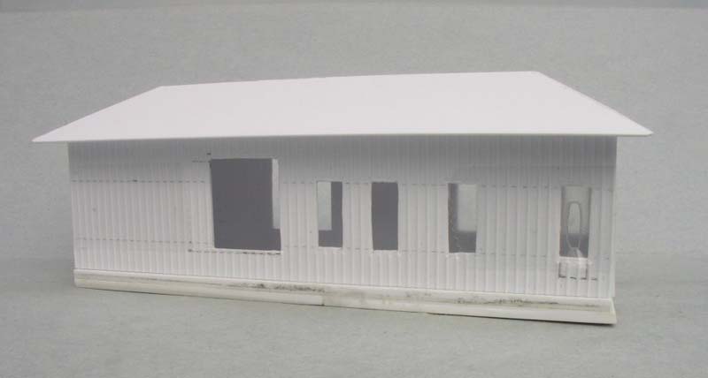

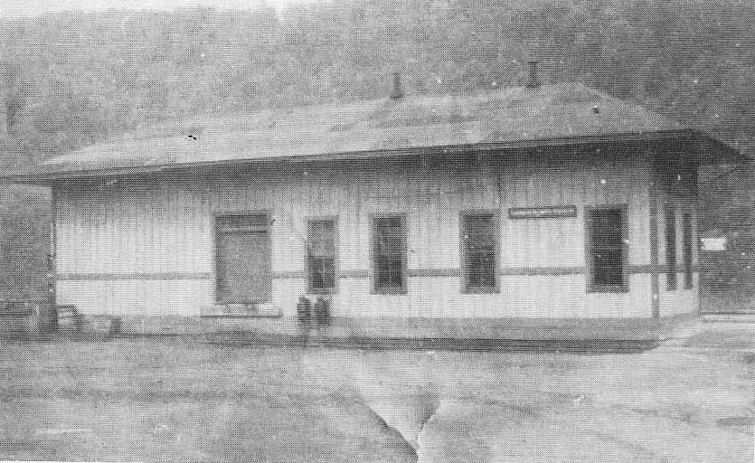

My "West Hickory" T-trak module is coming around nicely, but one nagging issue has been the creation of the signature structure of the effort - the PRR depot at West Hickory.   Last week I discovered that the original depot that was there apparently burned down in 1922 when the tannery burned down, leaving me with only TWO photos of the replacement depot, and of course, no drawings, and no surviving structure to look at either - torn down some time after 1961.   The tannery was rebuilt in 1922 after the entire complex burned, and I'm guessing it took the original depot and much of the immediate area with it.  It's unbelievable what's on Google Books - 1922 fire insurance claims turned that one up.
So, I figure take the toughest part and take that on.    I started with this photo, taken in 1925, from the back.   Finding out that the structure probably was rebuilt in 1922 at least explains how this relatively simple combination depot was in such perfect shape for paint, and why anybody would take a picture of it with no people and no trains (look at our nice new station!):
If you can start with at least one basic assumption and prove it, you can figure this out.  In my case, I knew of another PRR freight house that did survive built about the same time, same windows, same design.... and the battens came out to exactly 12".    Given that.... well, off you go with 'best guesses' and start counting battens to measure about everything.  The is Evergreen board & batten with is dead-on for width in N.    I have fitted all the Tichy windows and doors, but I'll have to paint everything separately.  The Tichy baggage doors with the transom are about two feet too wide but I decided to use them anyway.
The height of this thing is proven is another shot I've got from the front - Triumph VII page 352 of the semi-front view, showing a 1960's steel boxcar parked in the back tucked under the roof edge.  If you look at that rear shot, the siding is obviously able to directly unload to the freight door.  So the roof really is that high, making the entire building look a big awkward in proportion.
There is a bay window in the front with three regular windows, nothing elegant at all and that overhang roofline doesn't help it much.
It's still a big of a guess, but with the building gone and darn few photos, it's a pretty good one.
