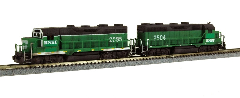

It was just a typical spring day.  I was minding my own business, browsing the web for this and that when suddenly, BAM! there it was.  "Now Available AZL BNSF SD70ACe".
Such a beautiful little thing!  I've always wanted a Z Scale set, and I've got a thing for those BNSF ACe's, but that price tag!  Over the next few days, the ads haunted me.  Everywhere I looked, every site I visited, I kept finding my way back to the AZL ACe.
Enough.  I just had to have it!  I went to MBK, and found just one left; into the cart she goes!  Well I'll need some track, and a few freight cars too!  A couple minutes later I'm all set to spark the fire, click "Checkout".
"Oh no! There was a problem.  One of the items is no longer in stock."  NOOOOooo!   It was the ACe!  Someone sniped it before I completed checkout!
Now I was in panic mode.  Z Scale Monster?  Gone.  BLW? Gone. Caboose Hobbies? Gone.  I didn't know where else to check, but then trusty Google found her.  Zgauge.com had that last two available, one of each road number!  I didn't waste my time, I even considered grabbing both numbers, but I resisted.  Once she arrived, it was Christmas morning!
I was hooked.  Now I had to have the other number; you can't have just one!  But this time it was no use.  They were all gone.  I even emailed Jeff back at Zgauge.com for the slight chance that he still has one unlisted, but no luck.

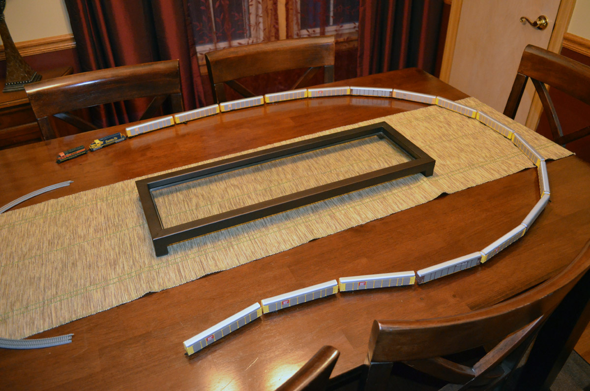

I've got plenty of room for a little shelf layout in the workshop, especially in Z!  Should I go briefcase?  2x4? Heck, 2x8, 2x10?  No, I knew all along exactly what to do.  My old college layout Thunder Ridge met a premature end in that cramped little apartment in San Francisco.  I loved everything about that layout.  And with that, it gives me great pleasure to say that Thunder Ridge will live again!
I've made some slight adjustments, and things are still fluid in the track plan, but official construction will begin this Friday.
