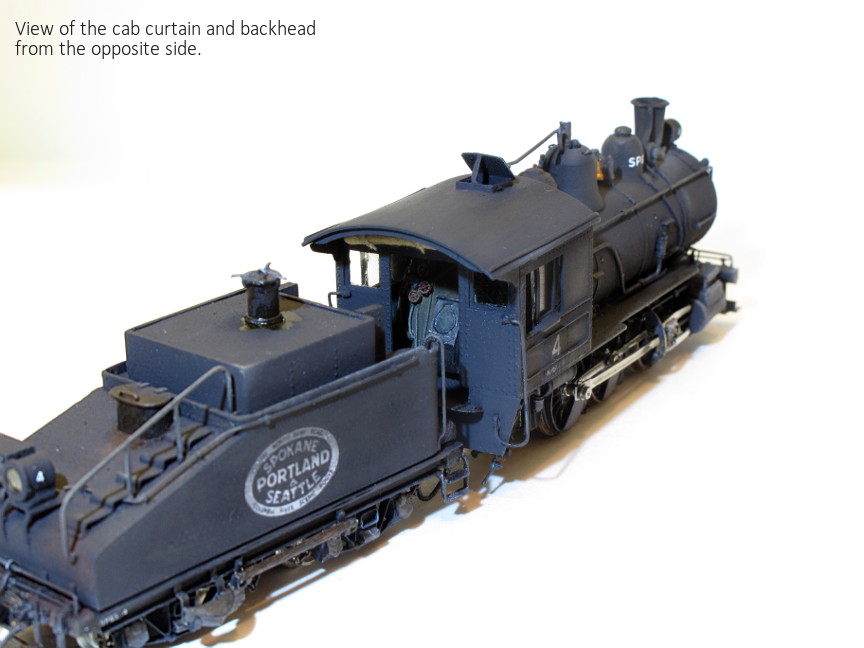

« Reply #420 on: March 06, 2018, 03:22:33 AM »
Max,
Did the SP&S have that goofy angled wall covering most of the back head from the rear. Like in those Erie drawings I sent you?
If you look here you can see the center rear cab wall tilts in toward the bottom:
https://photos.app.goo.gl/s1PjlosKmojSc7Rg1
Just like this:
https://photos.app.goo.gl/RhL94reG7Vui8juE3
Just like this:
I see the angled wall in your photos, Chris.  I don't think the SP&S engines had that.  I haven't seen any photo of an NP or SP&S 0-6-0 that has that, including the brass models.

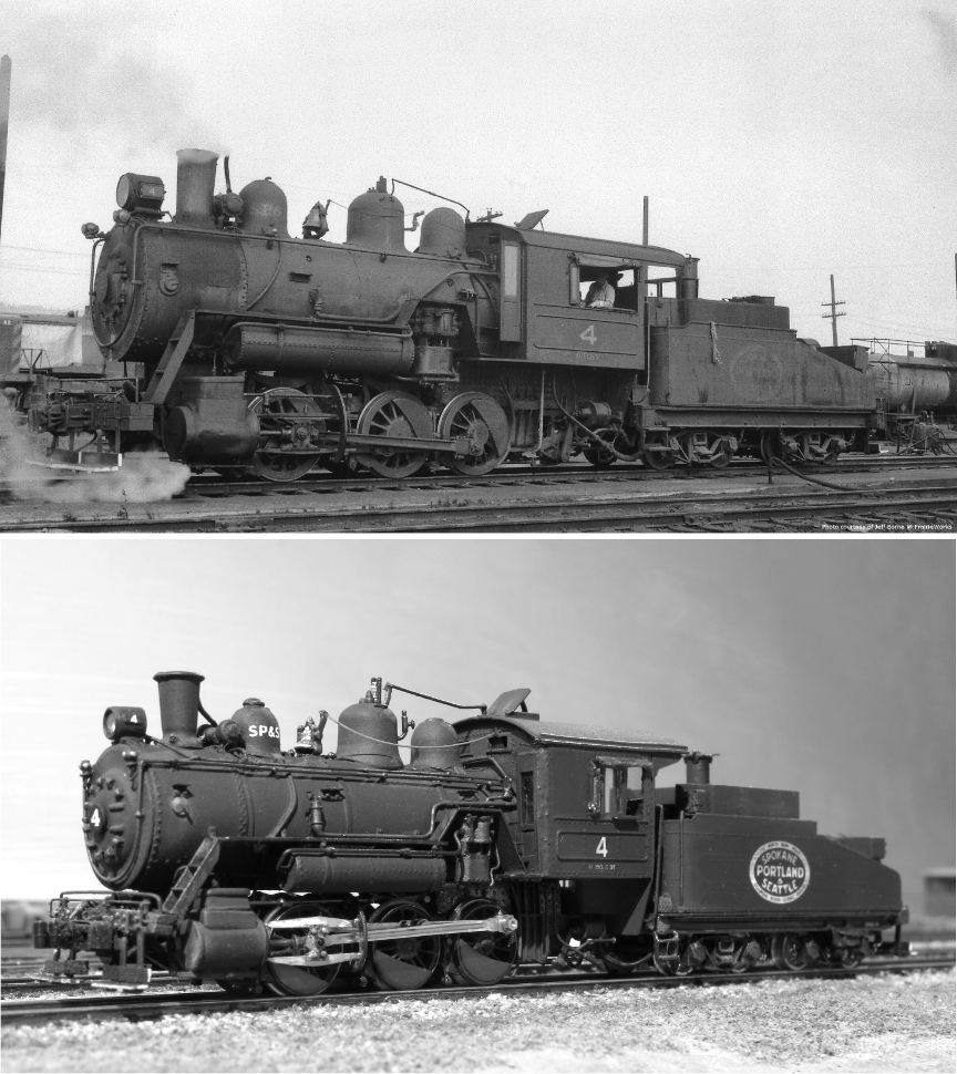

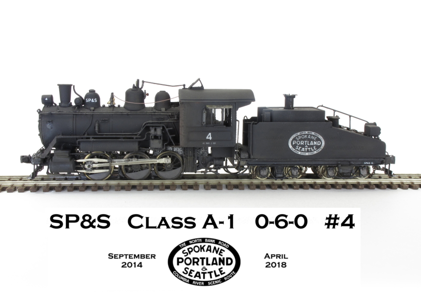

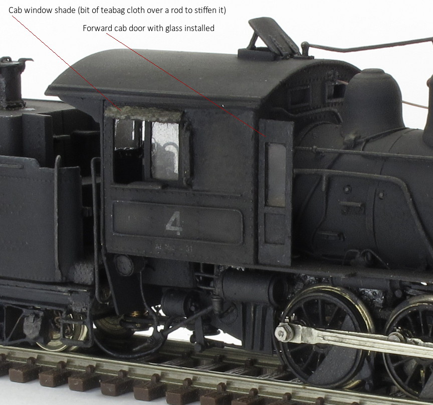

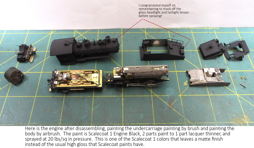

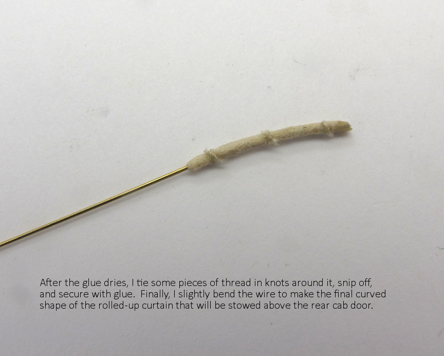

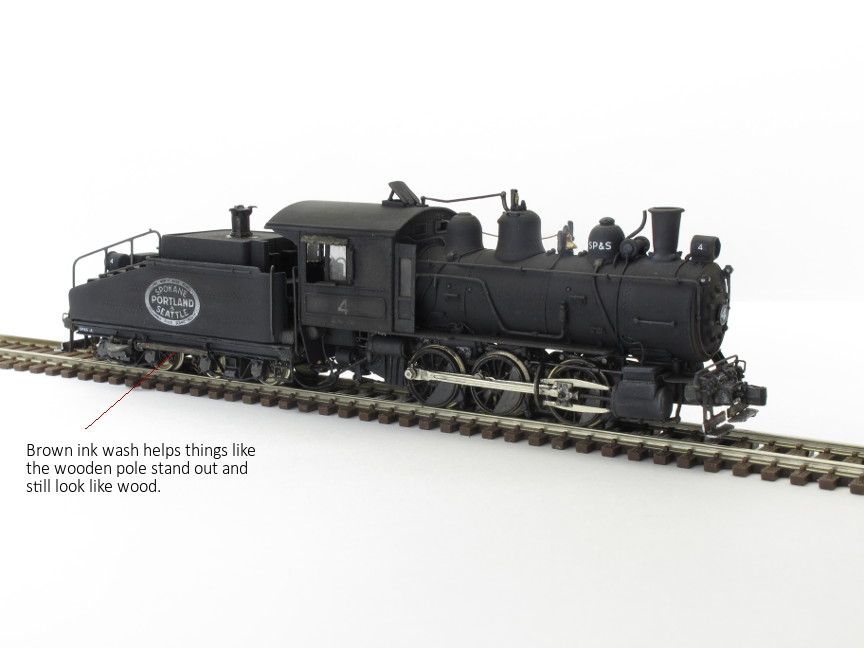

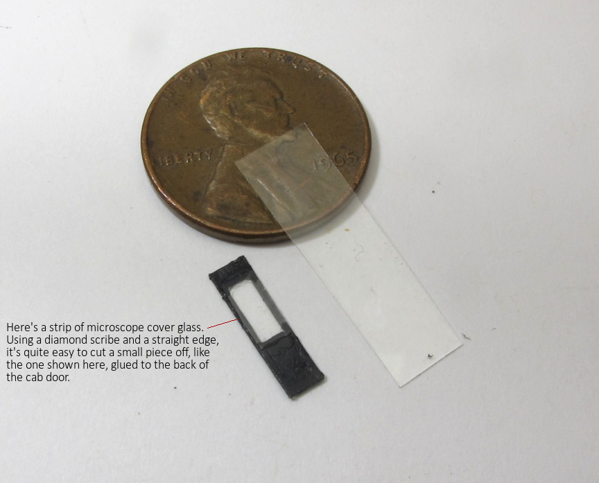

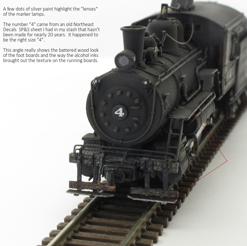

« Reply #430 on: April 07, 2018, 03:39:19 PM »
+13
Holy Cow... It's DONE folks!

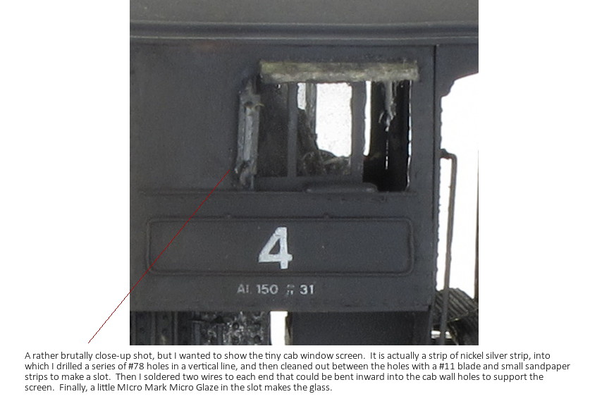

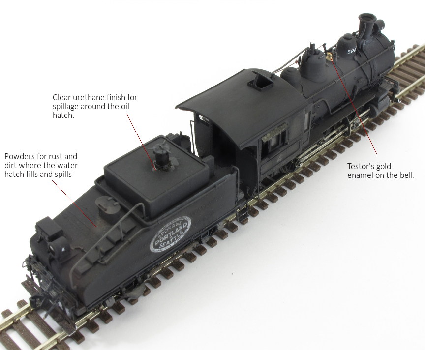

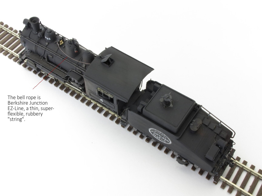

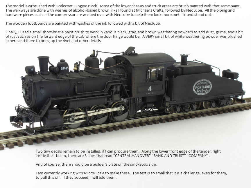

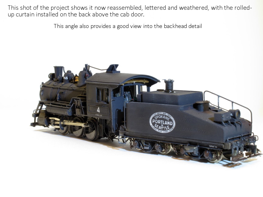

Here we are, the final "how to" post of the project.
Before getting into this, there are two small text decals that Micro Scale is working on for me at the moment.  One is a builder's plate that may have actual legible text on it, and the other is a 3-line text that goes along the front lower edge of the tender that says, "CENTRAL HANOVER" "BANK AND TRUST" "COMPANY".  It is barely visible in prototype photos.   Both of these have text so small that it is well below their minimum capabilities (yes... smaller than freight car dimensional data lettering).  But they are working hard on this to see if they can thicken the right places in the lettering to get their printer to pull it off.  If they succeed, I will add them.
Now, on to the final photo group!
Here's a comparison between the model and the prototype.  I tried to get the camera angle close to the same
Well, that's it, everybody.
I don't know how to thank everyone who has put up with this for over 3 years.   It has been challenging, exhilarating, frustrating... all of these things and more.  Most of all, it has been just plain FUN to build and emotionally satisfying to see if such a thing could be done.
