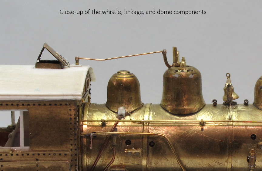

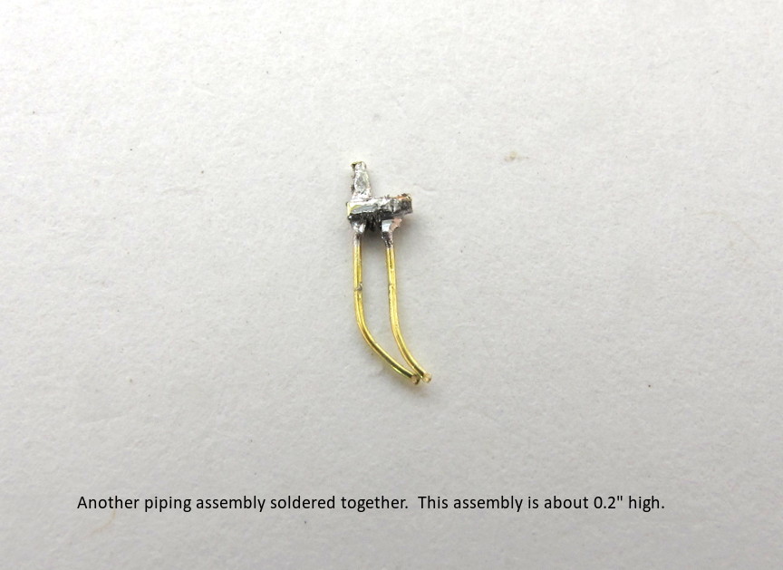

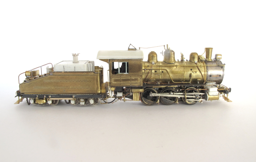

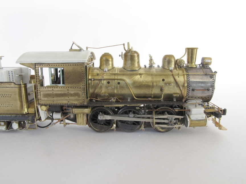

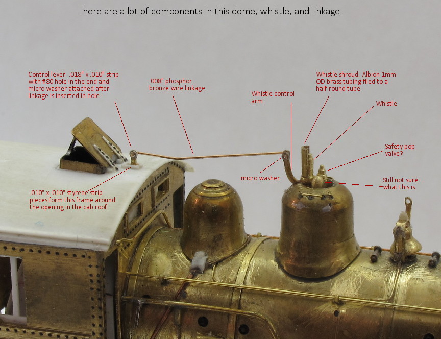

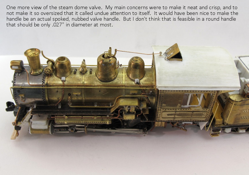

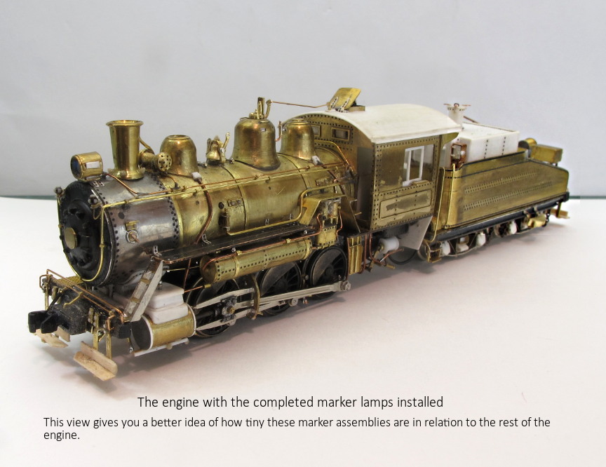

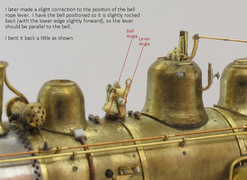

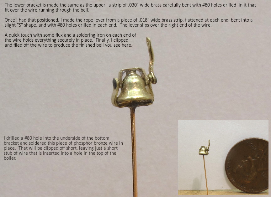

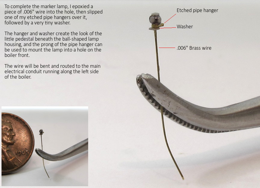

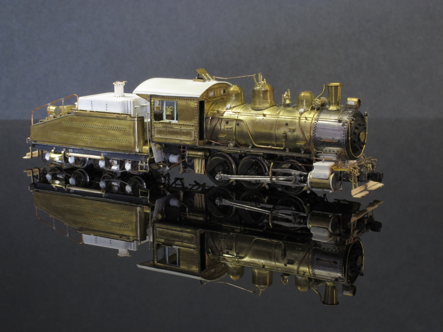

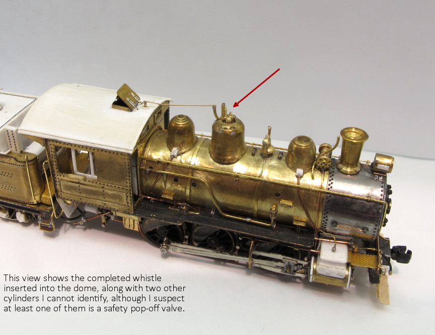

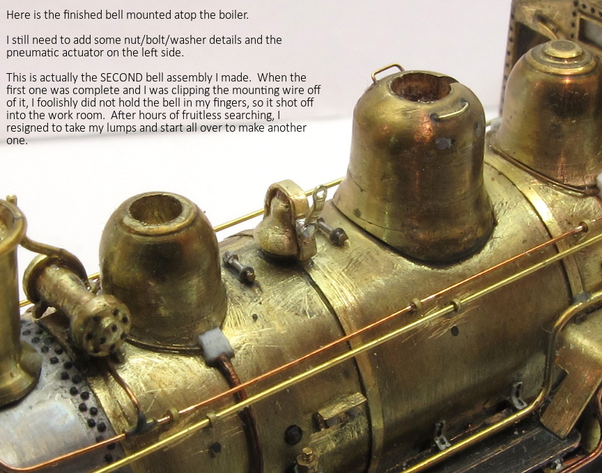

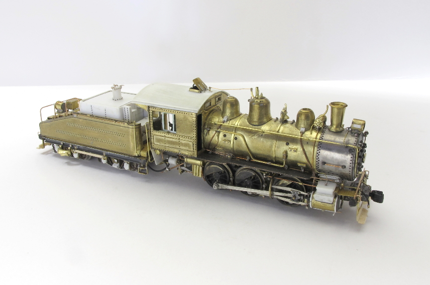

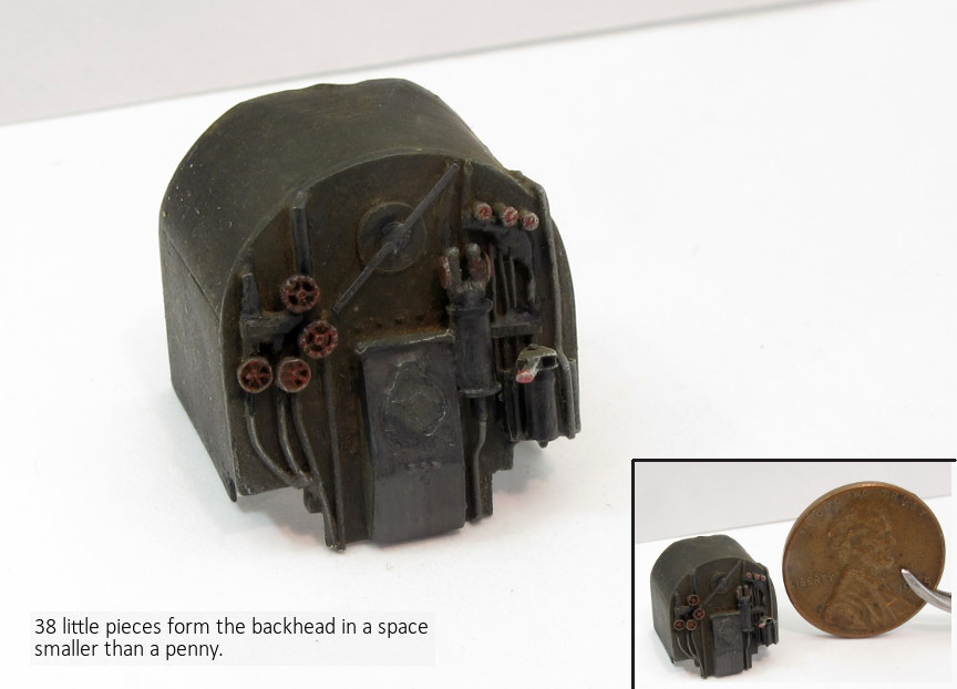

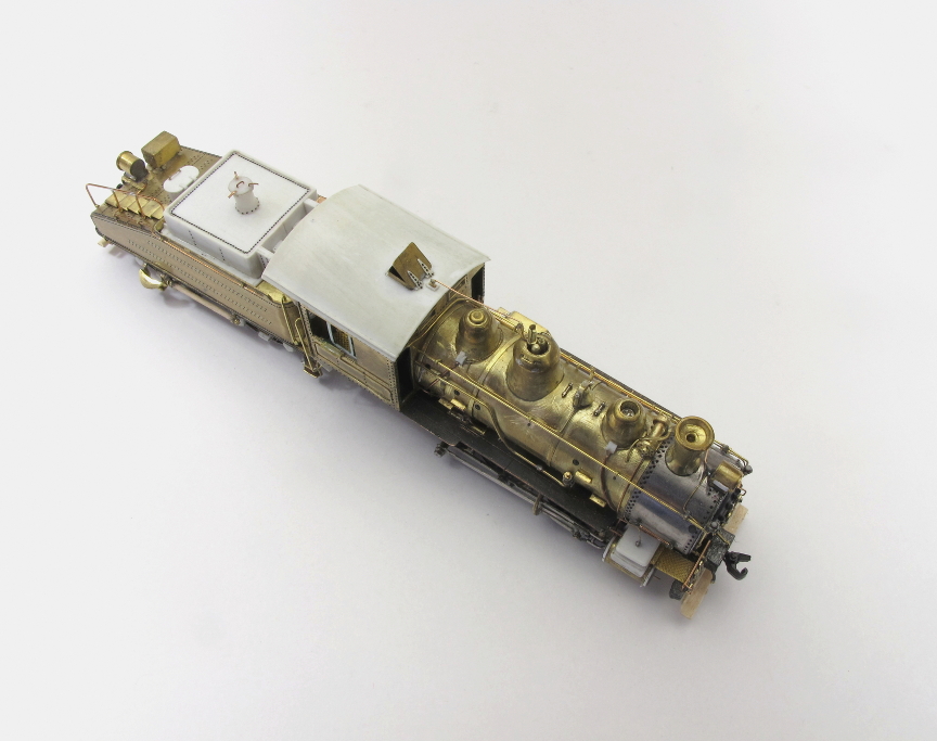

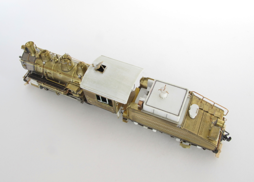

Hello everyone!

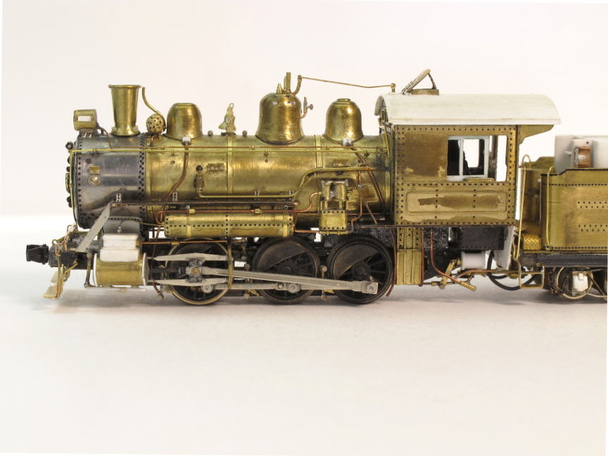

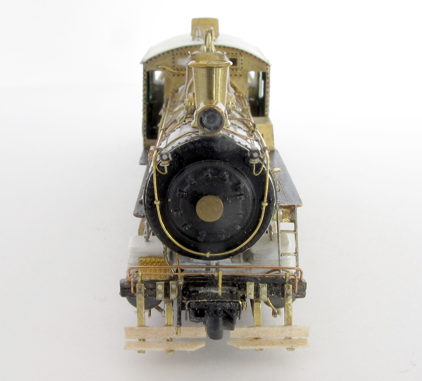

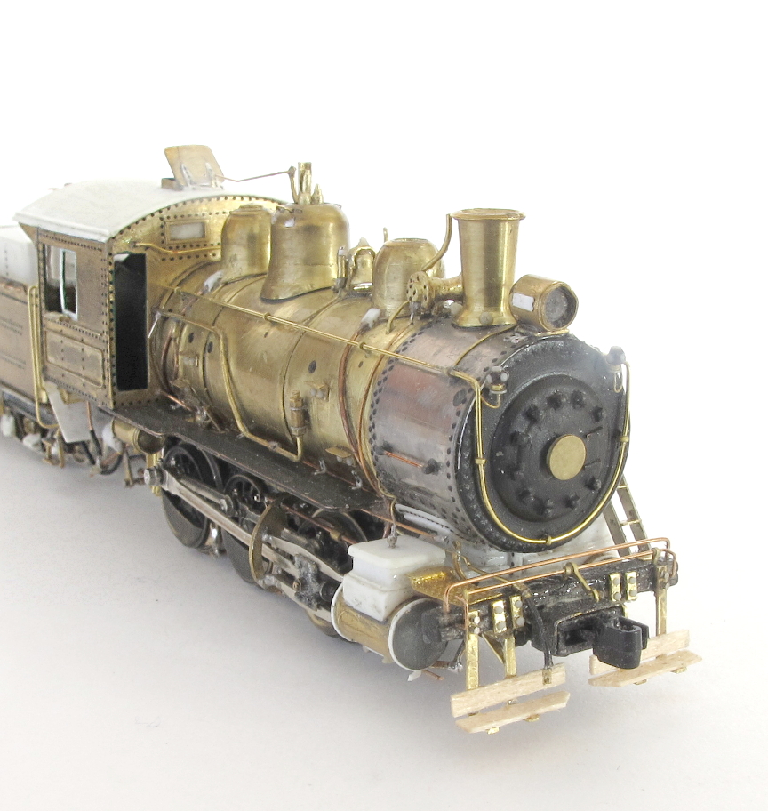

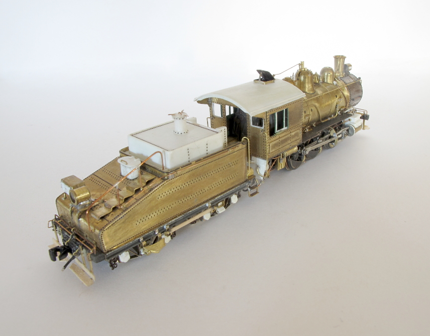

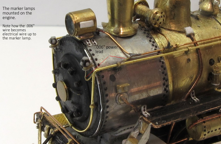

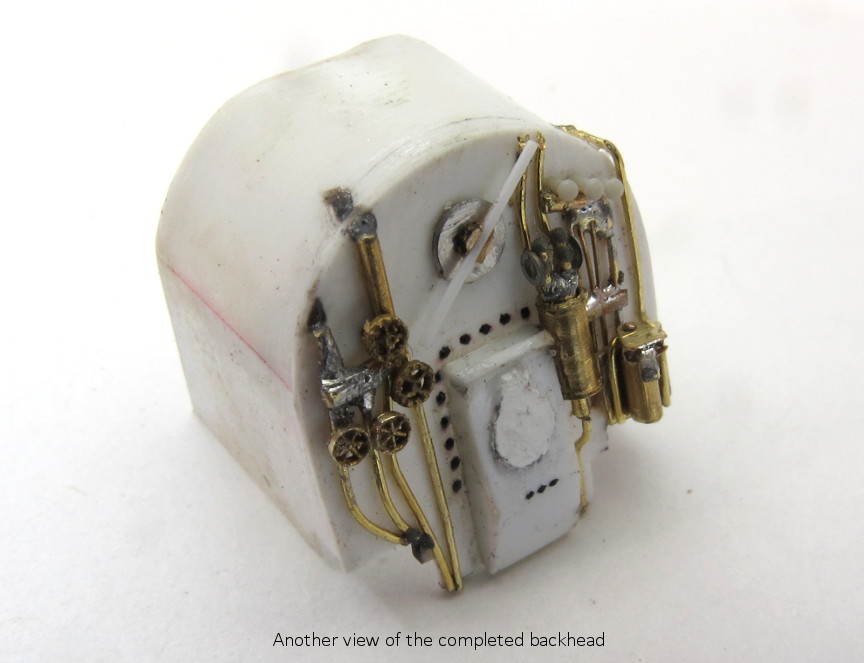

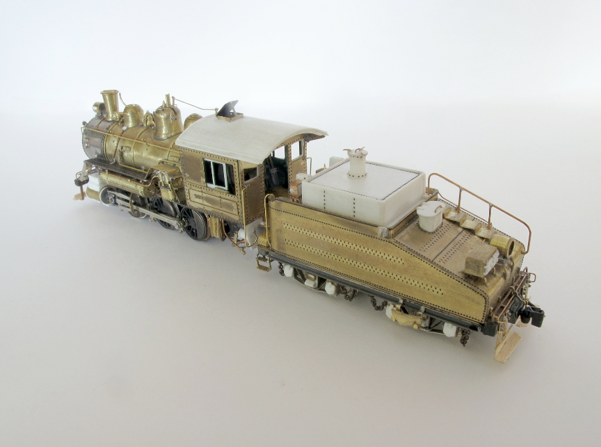

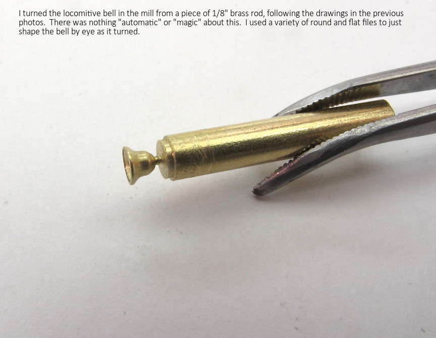

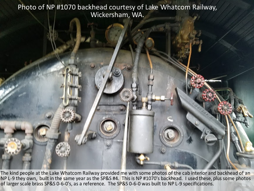

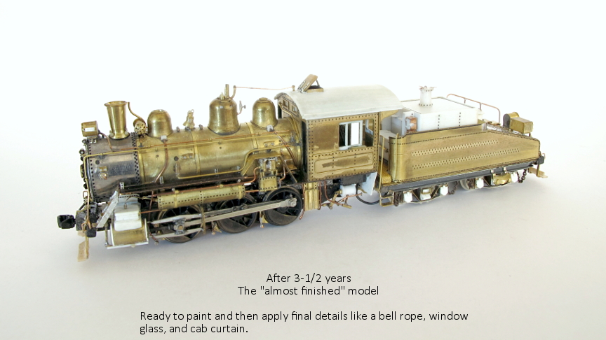

Here is the last installment before painting.
THAT'S RIGHT!   After this installment, the engine is complete except for painting, and then adding a few details that have to go on after the paint, such as window glass, a bell rope, and cab curtain.

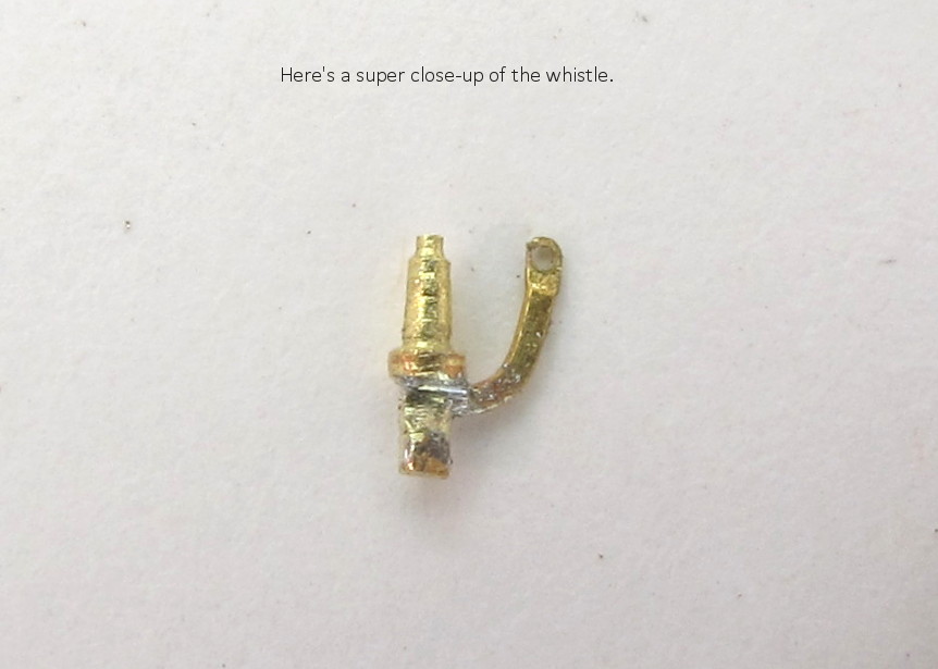

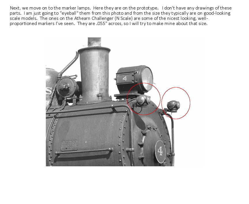

This installment covers the bell, whistle and linkages, marker lamps and the backhead.

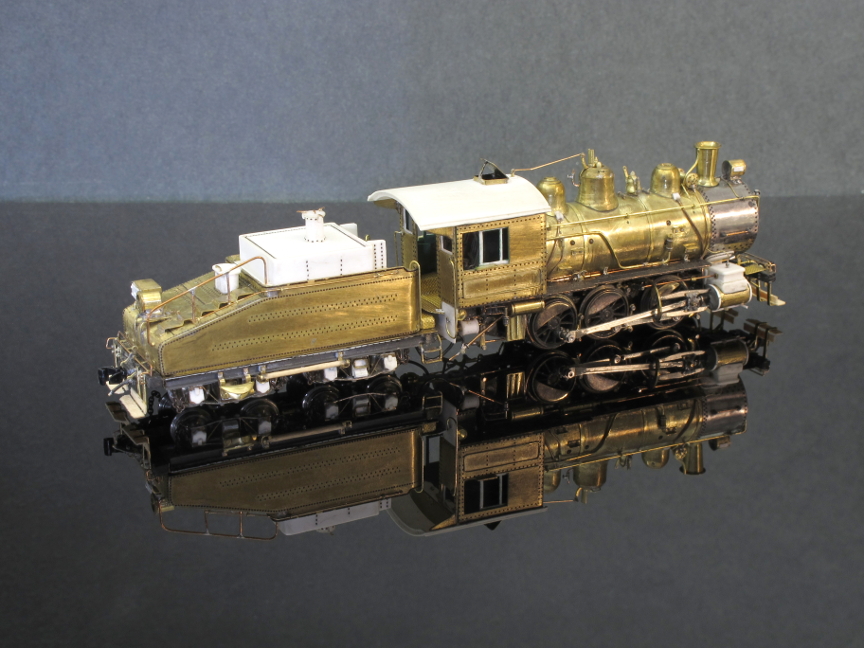

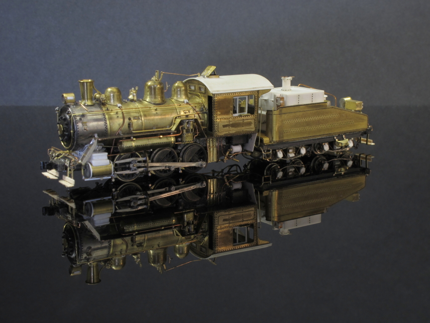

At the end, there is a set of "glam" shots to fully document the engine in its raw brass state before painting.  There is also a link to a final demonstration video at the end of this post.
And finally, here is a video of the engine going through the paces of a "run", from pulling out of a yard, making up a train with some switching moves, and running on the main for a minute or two.  It got kind of long (13 minutes), so I don't expect anyone to sit through all of it.  Feel free to skip.
The next time you see it, it will be in black!
Tom Todd

« Reply #410 on: March 05, 2018, 02:15:53 PM »

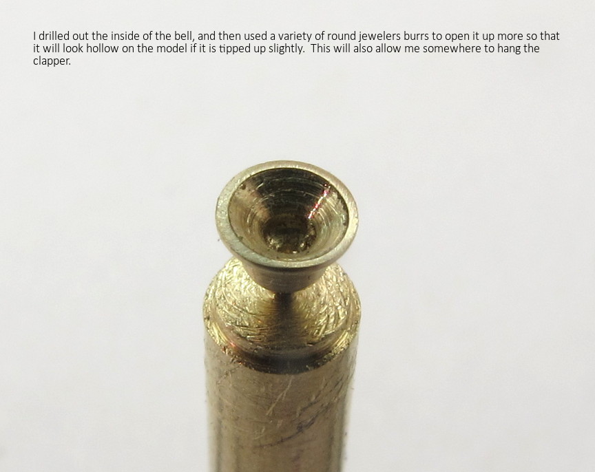

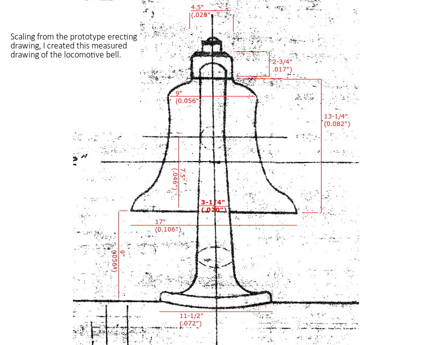

Fantastic!    Is a jewelers burr anything like a graver?

  • Posts: 6500
« Reply #412 on: March 05, 2018, 03:16:45 PM »
Thank you everyone, and to all of you who have slogged along with my on this project for over 3 years.
I hope it wasn't boring or tedious.
I am beyond ecstatic to see how close it is now.  Time to say "goodbye" to the bare brass, even though I will miss it.
Chris,
Some jeweler's burrs are round, very much like engraving burrs.  I have some of those, and I also have the angled "90 degree" type, which are more like a pointed, wide-spread cone.  Those are really good for making pointy-bottomed cone-shaped holes for things like marker jewels or the cone shaped holes in a truck sideframe that the axle point rides in.
They are good for any case where you want the hole to have straight sloping sides and be shaped more like a cone.

I am stunned.  Really.  Superb work Max!  Not only looks "just right", meaning with all that non-generic, prototypical detail and proportion, but runs like a Swiss watch!
That said, I really enjoyed the video...every minuted of it, with one small caveat...slinky effect.  I get used to it when operating and switching, but video is a harsh taskmaster and the sproinging detracts from your superb and faultless work.  I'm hoping that modified MTL TSC's are going to do the trick for me.

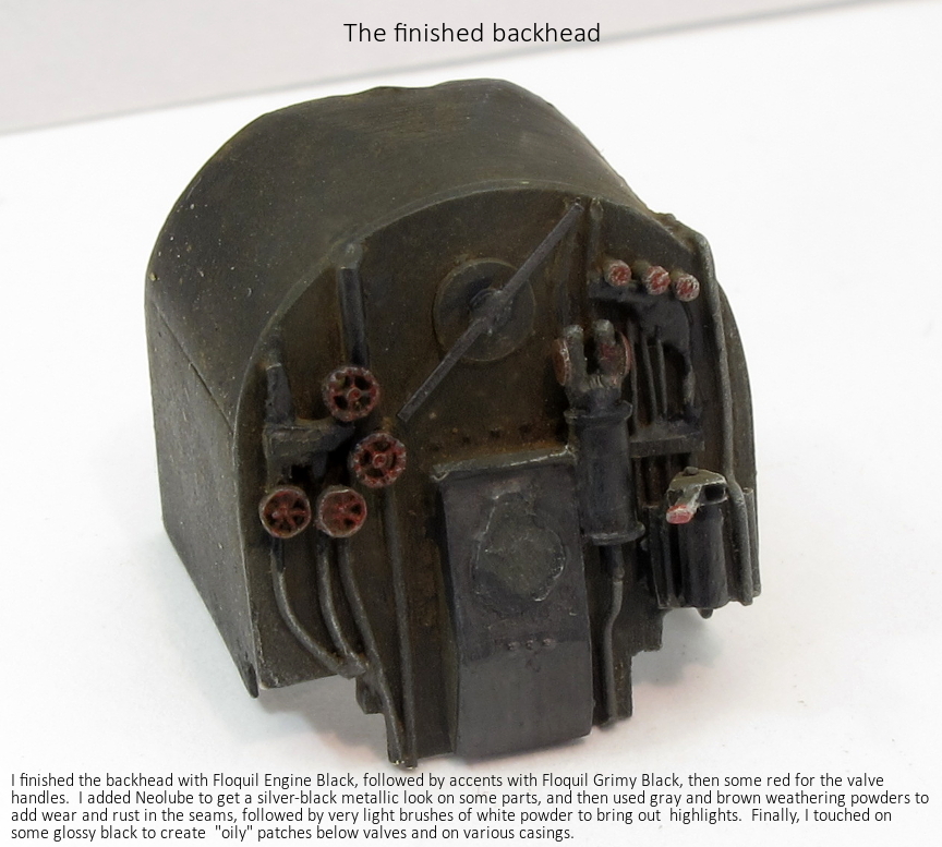

When I was going through the photos of your unpainted backhead masterpiece, I was saying "Meh...nice" but THEN...the photo of the painted backhead popped out of the page and slapped me across the face!! WOW!!  I am going to assume that when you're done painting this model, with the added details and weathering...it is going to do the same!
