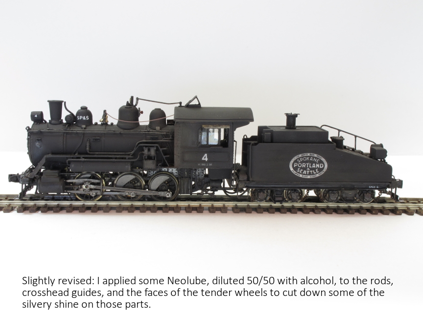

« Reply #438 on: April 07, 2018, 07:32:26 PM »
Max, the engine looks absolutely stunning!!! You did a superbly wonderful job and it's been a pleasure to be able to watch this whole process you went through to achieve such a level of detail. Simply amazing!!!!!!!!!
Now for the only thing that I think would really help with the look is you need to use some of that Neolube on the slides and rods and possibly the tender wheels too.
But that's just my observation.
I'm sure if you don't have any there is possibly several of us  :ashat: on this site that could help ya out!  ;) ;) :D :D

First, THANK YOU for everyone's flattering remarks  (but I have to admit... it is darn pretty, I aint' gonna lie!  :) )
Jon,
I've got plenty of Neolube, and you'll notice in my notes that I used it in some areas on this engine.
I am on the fence about the rods and valve slider.   I have used Neolube on those parts before and it does a great job.
But in this case, I don't want to make those parts quite so dark.   If there was such a thing as "half Neolube", that would be just what I'm looking for.  I suppose I could try cutting it with some alchohol to make a weak solution and see how it looks.
I want to retain some silver look to the rods, perhaps just toned down some.   I don't want to make them weathered gray the way the prototype photo looks.  Although I did weather this engine, you'll notice that it's actually pretty clean, like the prototype photo.  There is dust and grime on it, but overall, it's a not all that filthy.
I shall ponder what I want to do with the rods.

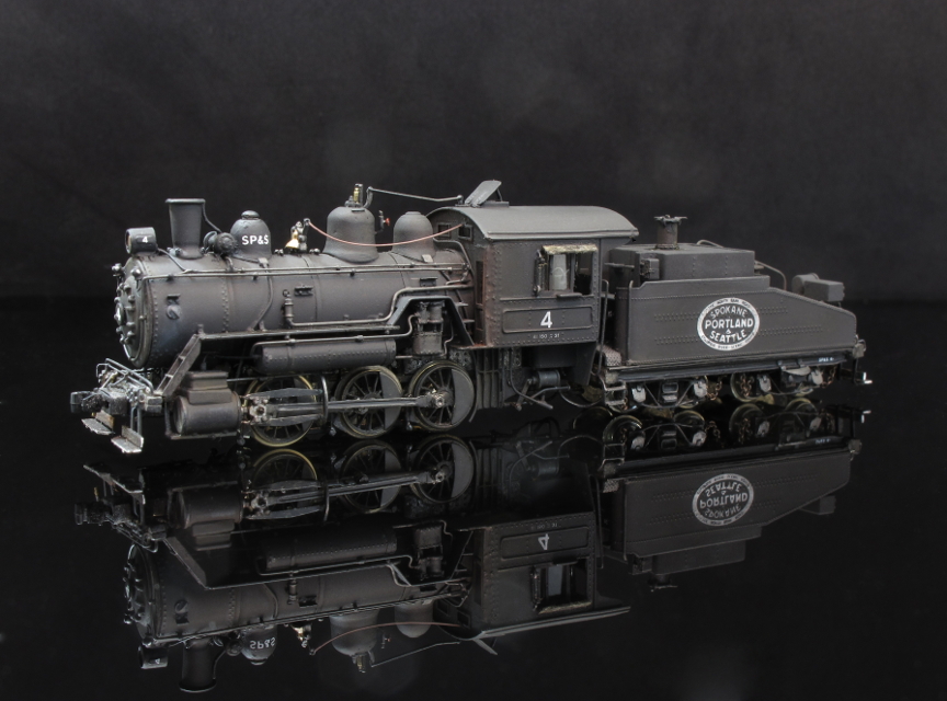

Considering the shiney rods, I decided to try using Neolube cut 50/50 with alcohol.  This does give it a less dark coverage, and I'm glad I heeded your comments.   I do think it looks better this way.  I used it on the rods, crosshead guides, and the tender wheel faces.  You can compare these photos to the earlier ones to see the difference in the rods.  I also got around to taking a nice "glam" shot on the black plexiglas.

« Reply #449 on: April 08, 2018, 11:19:33 PM »
If I only had a ton of money and could convince you to, I would be begging you to make a model of Pacific Electric 1506 with a whale back tender.....you have achieved N Scale perfection.
