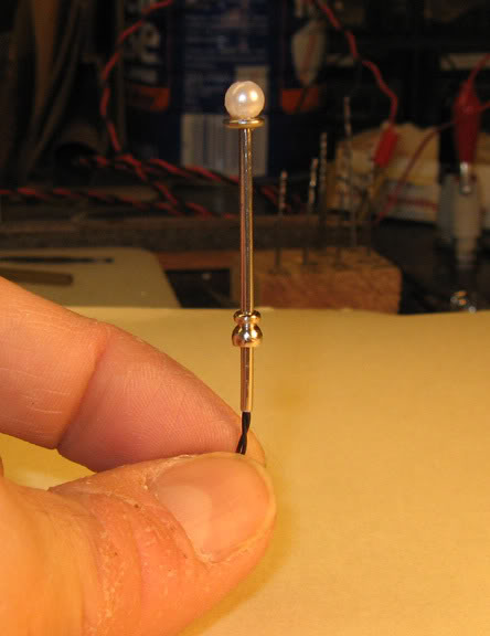

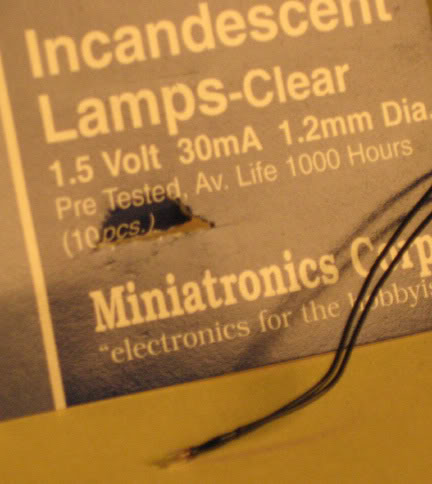

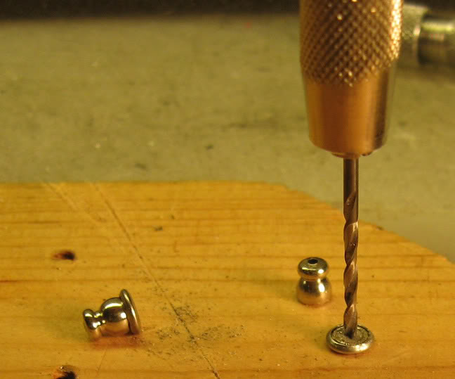

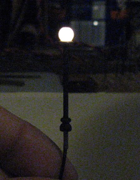

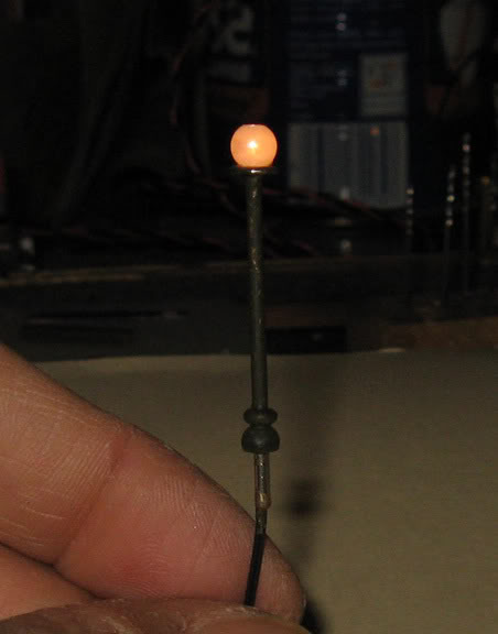

Would you consider making your own?
It's not the height that bothers me.  It's the thickness.  That pole looks way too thick.
6mm is about 38"   Yikes.   I haven't measured one on the street, but they have to be about a foot across,
not 3 feet.
I long ago gave up on this because of the size of so many of the commercial ones, so I made my own.
Have you considered this?
Here's some pics.  I present this here because this subject has come up on forums many many times, and
I think these are pretty easy (and very cheap to make).
These are more of the residential globe style, so making a more modern one would require soldering that arm
on there that curves over the road - not easy, I admit.

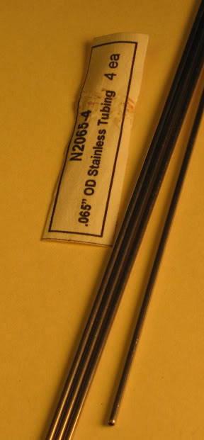

Do they have to be the overhanging "highway" type?

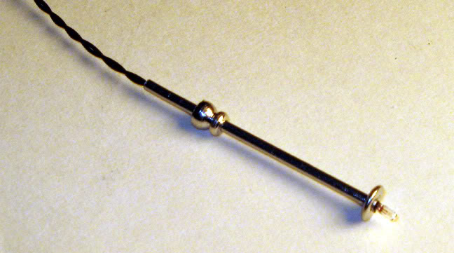

The point is the proportions.  The mast on mine is a .065" stainless tube from Ngineering.  That's 10.5" in N Scale.
The stainless tube has such a thin wall that it's quite easy to slip a 2-wire bulb up the tube.

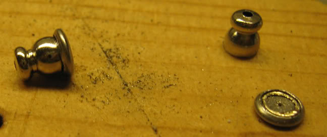

The base is made from earring backs.  You can buy packages of these at Michael's Crafts.  I cut the flat
part off and rearrange things as follows:
Now, we push and epoxy the base and mast together and thread the microbulb up in there.
I think if I were doing it now, I'd use an SMD LED to avoid having to ever replace the bulb, but with a
good regulated 1.5v supply, those microbulbs last a long time (and they sure look nice)

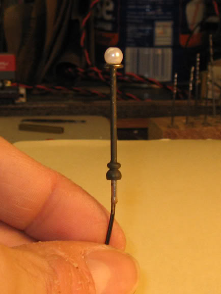

The globe is a frosted white plastic pearl, also available at craft stores like Michael's.   You can find ones that have
no hole and just drill in from one end.  If you can only find the ones with a hole all the way through, just
plug up one end of the hole with a dab of white putty.  The holes on these little beads are very very small
and I found that it actually does not show once the putty dries and you sand it a little.
Depending on how much you juice the bulb, you can get a dimmer more yellow effect, or a brighter white.
(about 1.2v vs 1.4v on a 1.5v microbulb).
