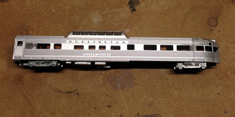

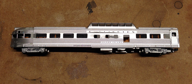

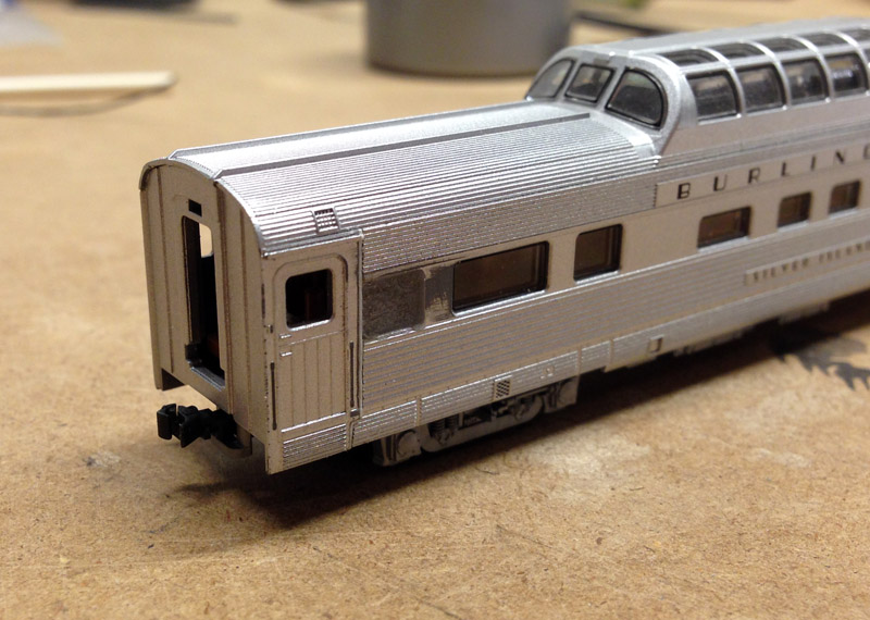

This is a Twin Cities Zephyr dome obs.  The main body is a Kato corrugated release Budd coach.  I move the vestibule to the opposite end and then added the observation end from a CZ dome obs.  Because the CZ cars have a raised roof aft of the dome section, I had been held up for some time trying to figure out how to lower the roof to get it to match up on this car.  Well, I finally started slicing into the roof over the observation end today, and in the process of making the first two cuts it dawned on me that I could just slice it and bend the roof down a bit to match... without having to cut the whole top off.   A little styrene filler and we're there.
I've been filling window openings with epoxy, and carving back in the windows I need to add.  Two more small windows, and a quick styrene frame around the lower window, and I think this will be good to go.  And almost all window openings will fit Kato glass.
Mike:  this is great!!  I am eager to see this when you've finished it!
