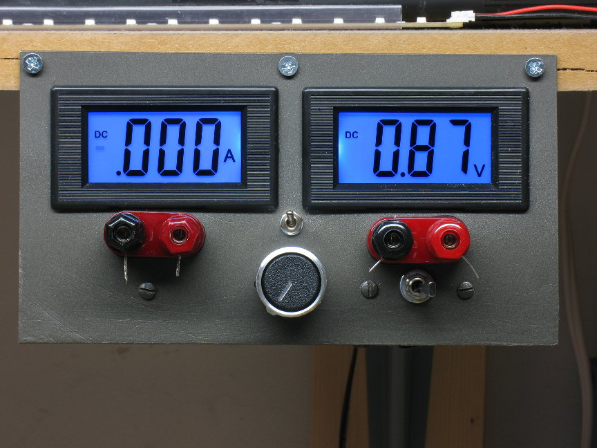

I took a diversion from building anything on the layout, or any locos, and addressed a long-needed improvement for
my workbench.   All these years, to test engines while building and remotoring them, I have used a crude
little transistor throttle built inside an upside-down plastic deli vegetable container, and using a few multimeters
clipped on to monitor voltage and current.  Sure, it worked, but...
So I built this from junk I had lying around (plus two inexpensive LCD panel meters from eBay).  It's just an LM317
regulator circuit with a reversing switch and a volt and ammeter of the appropriate ranges.   It reminds me
of 1970s stereo equipment (and that's cool to me so....)

Wow that's really nice looking Max , love the radioactive blue glow . For me though digital is confusing until it stabilizes , so I stay with analog meters . Having both though would be the ideal IMO , digital for readout easy reading ,  and analog for rate and direction of changes . Never saw that kind of merged setup , but I would love that .
Many (even inexpensive) digital multimeters have a fast responding bar-graph display along with the digits. It acts just like a needle on the analog meter.  It gives you a visual indication of changes.  I think that I have also seen a simulated analog meter which looked like an analog meter but the semi-circular scale was an LCD bar-graph.
I've seen some of these. Oddly enough, I don't like them any more than the plain digitals. Give me an analog meter--with a real needle--any day!
I have analog test meters myself, for many purposes.
On my layout, I use beautiful old-fashioned Simpson analog meters, and I love them.
But there is a reason that I prefer digital for locomotive testing on the workbench.
When I am testing a motor that draws, say, 15 ma, I might be looking for a sweet spot in the alignment of the mechanism
that only shows up as a change of 3 or 5 mA.  You can really tell if you are "heading in the right direction" when you
are adjusting a gear mesh, for example.  At the same time, I might make it jump to 120 mA.   The behavior
is quite broad.   An auto-ranging digital multimeter handles this really well.  An analog meter that pegs and has to be switched
to different ranges to read these small changes is not as convenient.
