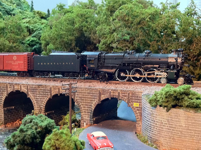

Center...  Per this pic pre-Neolube.
That's where the valve gear connects along with the drive rod and side rod.

I thought the same thing, until going to Spookshow's site and checking his closeup of the running gear, and mention that the TT was on the center driver. This is not going to be fun. I'm somewhat skeptical that layers of Bullfrog Snot can be applied evenly enough so that you don't end up with a decided limp.
