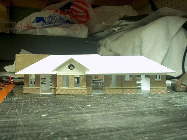

Continuing progess...
A quick mock up with the roof now. The roof may be completely scrapped as I am planning to build it with vollmer spanish tile instead of blank sheet. I was originally going to skin what I have with the Vollmer sheets but they are too thick and the resulting offset will make a mess.
That is one of the best looking scratchbuilts I've seen in N scale in a long time!

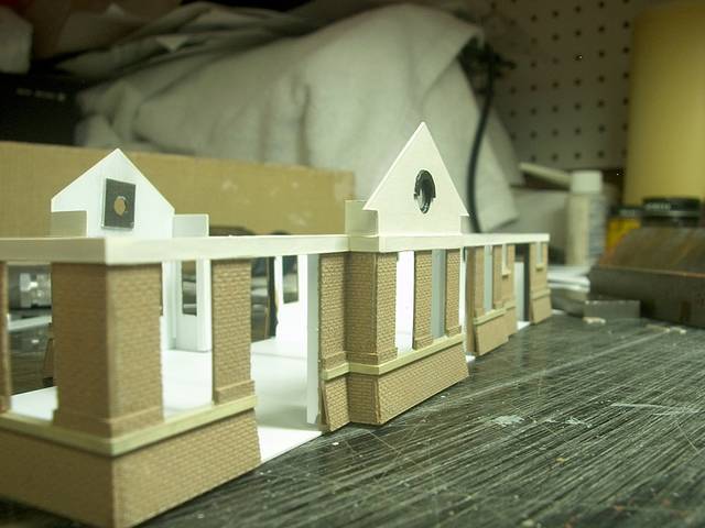

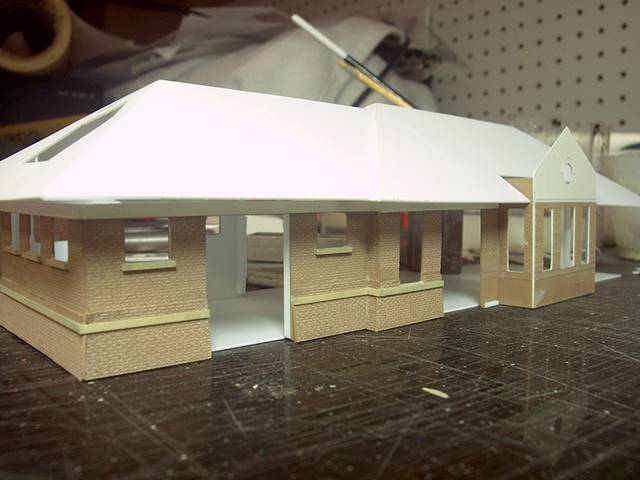

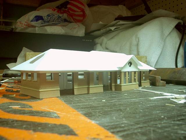

The walls are done, on to the roof and windows...
