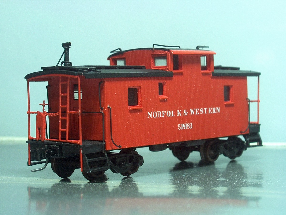

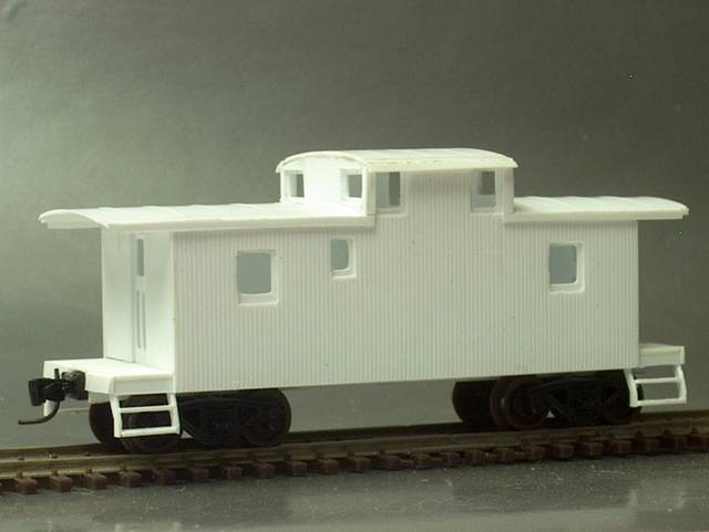

I forgot to put an update on my caboose here....
From this....
To this...
All styrene cut with my vinyl cutter.

Stupid question for ya' Tony, by "vinyl cutter" do you mean the Silhouette?
SkipGear
  • Posts: 2431
  • Respect: +647
Re: Silhouette SD
« Reply #192 on: October 22, 2011, 11:25:47 PM »
My vinyl cutter is a Roland but it functionaly is the same as the Silhouette Sd but about 8 years older. In fact, I think the Silhouette may have faster cutting speed and more blade pressure options than what I am using.
