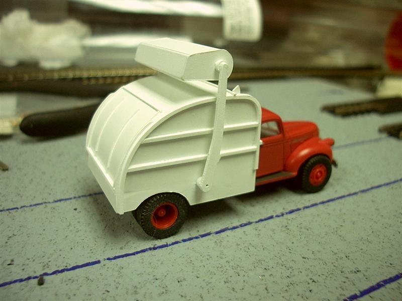

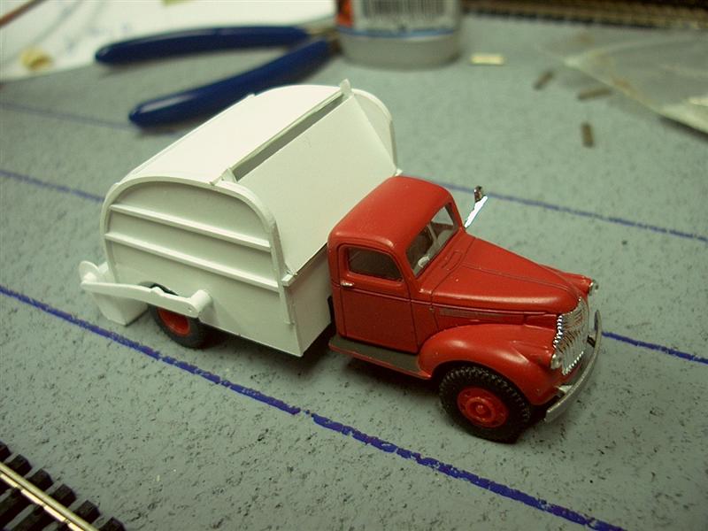

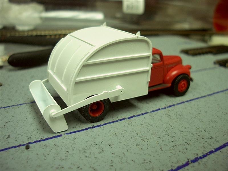

Here is something I just cooked up with my cutter....
It's an HO 41/46 Chevy from CMW that I used for a test bed. I am converting it to N but a body is going to be a little tougher. I am either going to use a GHQ Chevy or a CMW 54' Ford 350 with truck wheels and modified fenders. That is basically all CMW did.

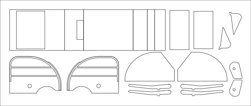

SkipGear, that is excellent work!
What thickness of styrene did you use? And anything special about the cutter settings?
Remember I am using a Roland vinyl cutter, not one of the Silohette cutters but here is what I use.
The thickest styrene my cutter will cut is .015" which is what I used for this.
I slowed the cut speed down as far as it could go and I don't have an option for cut pressure.
My cutter just scores the styrene and I break it out from there. I have no hope of actually cutting through.
