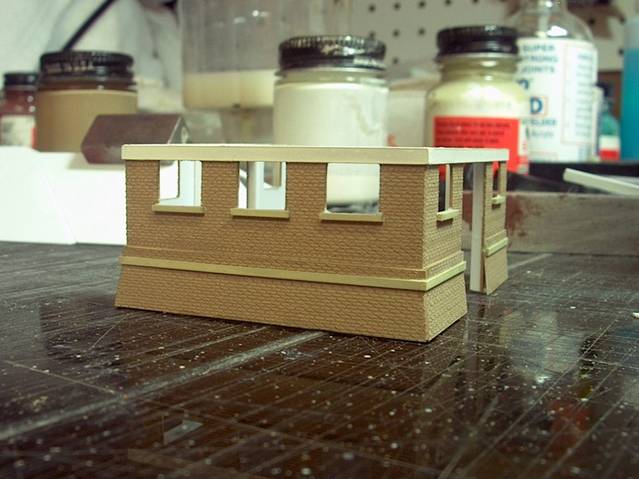

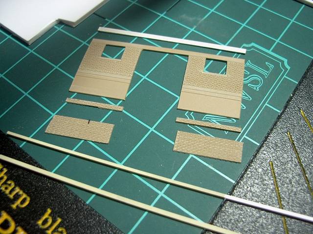

Finally started assembly of the station...
I pieced one section of the roof together.
Still amazed how tight and true everything assembled. Better than some kits I have built.
I painted the brick wall sheet and then added morter detail. It didn't have quite the contrast I wanted but fortunately the real building doesn't have a huge amount difference between the morter and brick color.

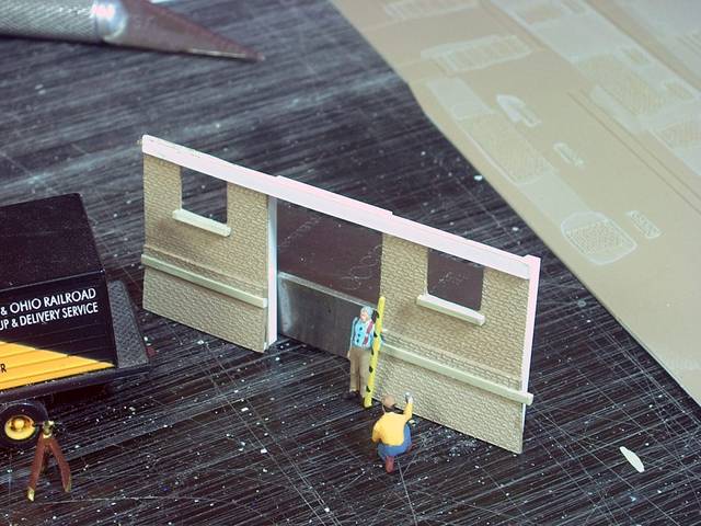

Here is the first wall assembled with the survey crew checking out things.
Here is a shot of the same wall on the real thing...
So far, so good. everything is fitting together as planned. Building in layers makes it easier to get the depth in the wall and paint parts seprately to keep paint lines clean. Waiting on the windows till I decide what color the trim should be.

That looks really great Tony! This is going to be a great building. Did you use the blade for scribing the bricks or one of Zox's custom scriibers? I couldn't tell whether you painted  the brick before or after the scribe. What are you going to do for windows?
Best wishes, Dave
SkipGear
  • Posts: 2431
  • Respect: +647
Re: Silhouette SD
« Reply #153 on: May 23, 2011, 01:10:31 AM »

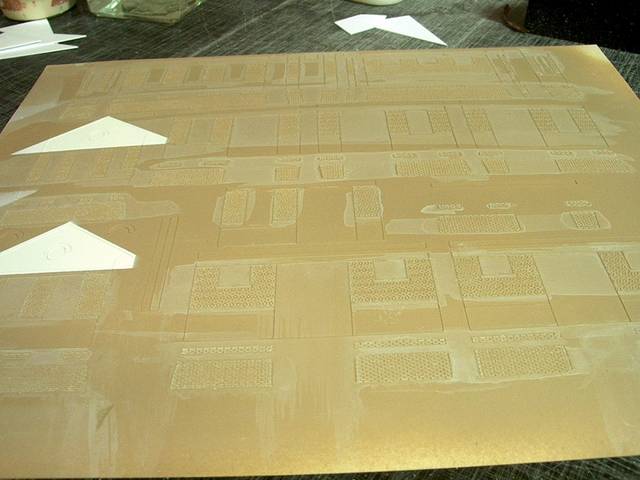

Everything was done in one pass with the knife. I tried making a scribing tool but I didn't like the way it worked. I played around with the offset settings in the driver to somewhat over compensate for the extra drag of the styrene and improved the squareness of the corners.
After cutting, the sheet was airbrushed the brick color then a wash of creme/gray for the moarter joints. The washed toned down the overall color a bit which helped. I still need to do a dark wash along the bottom of the building. I think it is stains left over from the 1937 flood.
Windows are going to be two layers, the frame and then the glass. I am probably just going to scribe some lexan to make the smaller window panes. I had considered cutting mask on the lexan but the panes are going to be so small, and so numerous, I'm not sure. I have plenty of vinyl paint mask to experiment with. I even thought of laminating the clear with trim colored vinyl and then just pulling out the panes after cutting. Everything is drawn, just need to experiment. It needs to be repeatable because I need to make parts for a friend who is modeling the same station on his layout.

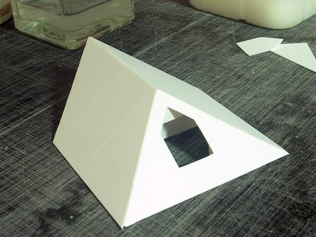

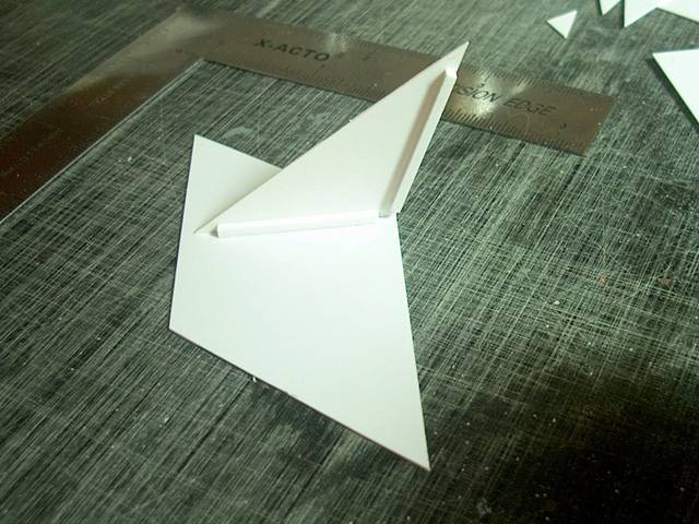

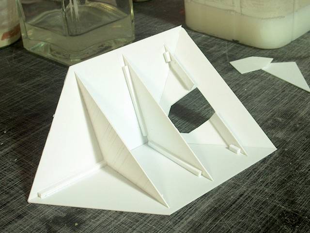

Continuing progess...
A quick mock up with the roof now. The roof may be completely scrapped as I am planning to build it with vollmer spanish tile instead of blank sheet. I was originally going to skin what I have with the Vollmer sheets but they are too thick and the resulting offset will make a mess.
