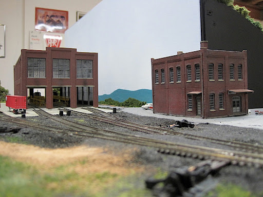

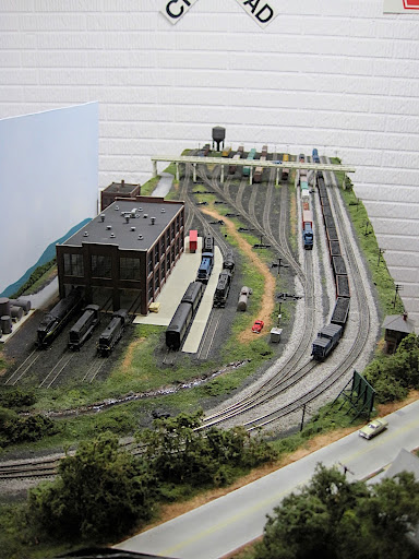

Okay, guys, Enola update time.
First off, I HAVEN'T set up a photo backdrop yet, so...  That's that.  Also, there are any number of people, telephone poles, diesel fuel racks, pump houses, sheds, sanding towers, etc. that have not yet been installed.  What you see here is the roughed-in scenery.

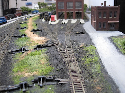

These are the power toggles to the pit and engine house sheds.  This way I can store dead or DC locos with no problems.

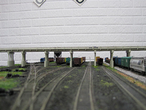

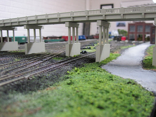

Looking down the classification tracks under the Overview Bridge.

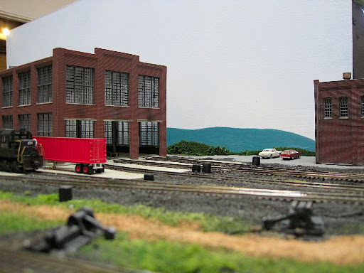

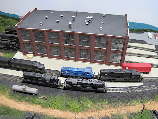

The concrete pads surrounding the pit tracks will have the fueling/sanding racks.

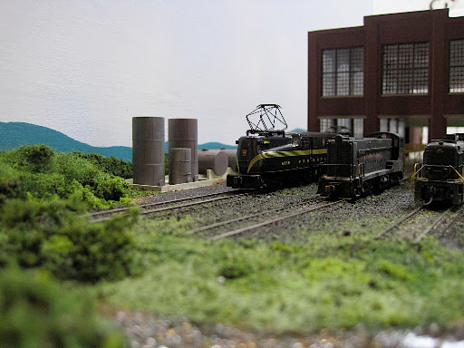

There are fuel tanks on the northeastern side of the diesel house just like the real Enola.

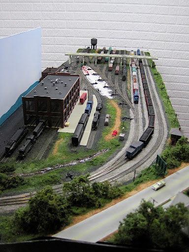

I need to glue down the yard office.

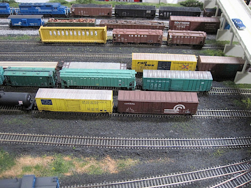

The view from Overview Bridge.  I know, the real Overview Bridge is north of the diesel house.  This is a concession to space.
I like the way the diesel house works as a backdrop.  This area will soon be cluttered with fueling/sanding equipment.

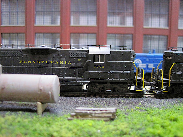

Wow. I am so mad that's half a continent away, I want to see it in person (and possibly do bad things to it).
This shot... just wow...

Psst:  Micro slide switches.  Those Caboose Industries Monsters are spoiling the view...
I know, I know, you probably had them in stock... but seriously.  I've started making power routing switch throws using micro slide switches that are about 3/8" x 3/16" or so (about the size of a potato bug).  They're barely visible.  I may actually be able to start adding scale switch stands to the blocks!
Oh, and since they're DPST, you can use the other side of the switch to turn the power to the siding off and on as you throw the turnout.

I've decided all future trackwork will use SPDT micro switches of for no other reason than that these contact ground throws are a real pain in the a$$ to work with.

They are big and ugly, aren't they?  Problem is, I pre-ordered a sh!tload of them before I started working on the layout.  Once I had a few installed, they began to bug me.  But I had 'em and so I used 'em.
One day I may rip 'em out.

I'm surprised you didn't at least recess them, actually.

I completely recessed the first two...  The rest I left below grade, thinking that would be enough.  Clearly it's not.
Looks like I'll be re-working the yard in the future...
