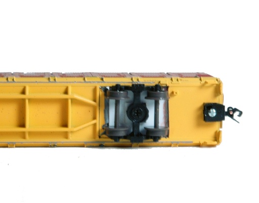

Verta-Pac getting crunk...

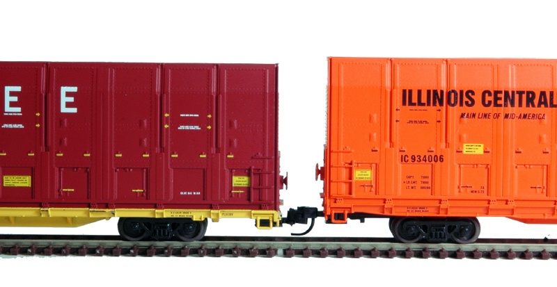

Holy smokes, look at the height of that sucker.  I thought RC solved the ride height problem on racks a few years ago.  Nice work on a solution, but it would have been nice if it had come that way...

Bingo.  I have enough interest to do this once more to my IC, and again if a RI car comes along, but that's about it.  Factory would have been nicer.
I carved off the air line and will work on hanging brass wire with etched lift rings next.  The carving helped the appearance of the flat itself, but really showed how high these cars are stock.

Is this like the Micro-trains problem in that the cars are reduced in actual scale height to accomodate the coupler and truck operating characteristics?
So...in other words, after Mike has worked hard to make the car appear much nicer, he has in affect made the car to short?

Won't it lower to almost the same hight when you swap the proper 28" wheels on it? I was planning on that and using the underslung Accumate couplers from an Atlas 100T truck.

Do the math and you'd get a heck no and a couple of uh-uhs on that...
Going to 28" wheels would net you 2.5 scale inches lower... or .015625"... which is .396875mm... or for the rounders... less than half a millimeter.
Skibbes car looks to be at least 2mm lower... if not more... which would be almost five times lower...
As an aside, while the new Acumates on the 100T trucks are completely underslung, the original Accumate were already underslung as well (i.e, the centerline of the coupler was higher than the centerline of the draft gear... note the one on the IC car in Skibbe's post)... so the height difference is actually smaller than one would think.  The biggest area of improvement on the new trucks was the lowering and shortening of the coupler box.
Eyeballing proportions, I'd say it doesn't have the MTL problem.  If Robb gets me some measurements I'll be happy to check though.
