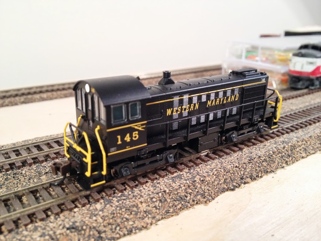

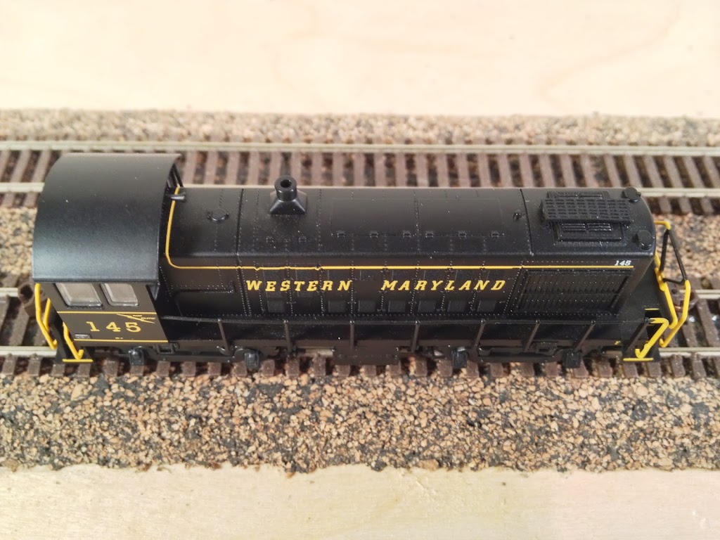

To get this back onto the strengths and weaknesses of the S4 I took some quick happy-snaps of the little beasty with my cell phone. DOF is weak but between all the shots you get the idea:
Enjoy,
The S.
And people are complaining about what? That models looks good. Now if it looked as clay-sculpted as the NW2 they are producing, then I could understand all the complaints...
Screw a couple hundredths of an inch of discrepancy.
-Cody F.

So I mic'd the hoods on the lil guy and compared it to my Arnold S2 and my Samhongsa S2, not like I have any S4's available.
Arnold S2 11.24/25mm
Samhongsa S2 10.9mm
Bachmann S4 10.85mm
The only info I could find S2/S4 was deep in a forum with a builders diagram which states the hood width was 67". This translates to 10.64mm. Assuming I mic'd it perfectly, it's off by a scale 1.346".
I also popped the coupler box...ok lid off, in order to put a smaller coupler on, it would require cutting the coupler post/guide and a few passes of a file to get a MT905 in there.
The S.
« Last Edit: August 11, 2013, 09:36:51 PM by sizemore »

So the difference in size between proto/model is negligible. All previous complaints about a "wide" hood are invalid...  :D  unless we are in a Star Trek episode and someone has bionic eyes that can measure things, then being able to "see" the hood as being too wide is a jug of hogwash.
 :ashat:
-Cody F.
