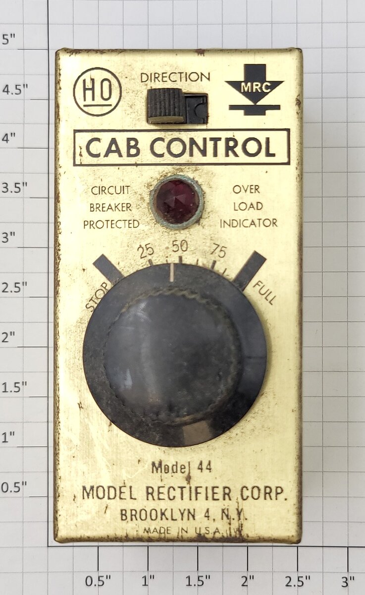

MRC Cab Control Model 44
« on: July 16, 2026, 02:38:35 PM »
I was cleaning out some of my OLD model RR items today and came upon a boxed, never used MRC Model 44 Cab Control.  I have no idea what this could be used for, but it is heavy and, I'm guessing, somewhat useless in the current state of electrical items.  If anyone can explain to me what this might be used for on a 2026 model railroad--or if anyone wants this I'd be happy to send it to you for the cost of postage.

Intended for use as a wired "walkaround" controller (or extra controller) powered from the DC output of a power pack or other DC power supply.

It takes a fixed DC signal and gives you variable control... if you give it a long cable then it's a walk around throttle..
So if you have a base MRC power pack with variable DC, fixed DC, and AC.. you can hook this up to the fixed DC and give yourself a 2nd throttle.
They made several of these.. 55, 77 ect..

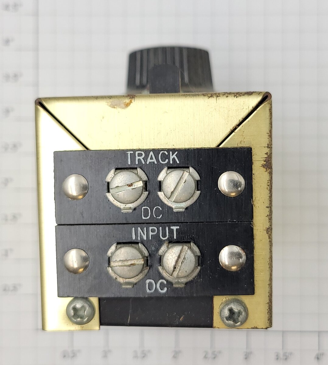

It has no rectifier and no transformer. All it has is a rheostat, direction switch. and circuit breaker. It's harmless on its own, even if malfunctioning.

The MRC CAB CONTROL MODEL #44 is designed to expand the number of controlled track sections on your HO railroad. When connected to the 12 volt DC terminals on the Twinpower, Throttle Pack, Dual Loco Pack, Modelpack, Tripack, or any MRC rectifier, this unit will control speed and direction in an additional track section.
Designed to facilitate pike expansion with rapidity and ease, the Cab Control Model #44 contains taper wound rheostat, reversing switch, and a protection circuit which combines both a circuit breaker to interrupt power output and an overload light to indicate when a short circuit is present. When an overload occurs, the indicator light will glow. To reset, turn the speed control fully counter-clockwise, correct the cause of the overload, Wait two minutes and then turn the unit back on.
INPUT:
Connect "Input DC" terninals on the Cab Control Model #44 to a 12 volt DC power source.
OUTPUT:
Connect "Track DC" terirnals to track section or block to be controlled, either direct? or through switch and terminal strips.
