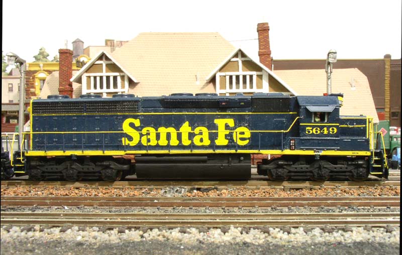

For those not afraid of some milling/filing/fettling, the Kato SD40-2 Mid Production chassis can provide a useful upgrade for the Intermountain shells.
I've documented this, and @randgust was the inspiration…
https://www.therailwire.net/forum/index.php?topic=55139.0
Cheers
I've got two of them - the 'original' and proper pinstripe scheme (which I felt was the wrong blue) and a second bicentennial that's really a shelf queen for display.  But it is just so pretty I had to have one.
I'm DC on the ATSF so to get good MU of a 3-unit consist the mechanisms have to be similar in gearing and RPM, and the IM mechanisms are 'fast Atlas'.   My original Atlas 6-axle SD50 drive (in my FP45) died of clicking gear disease, so I did go through the exercise of changing the chassis in the IM over to the Kato SD40-2 mech, and it's, as usual, rock steady and DCC resistant.  My six-axle EMD and GE fleet is essentially all various Kato mechanisms that get along well with each other and are incredibly durable and hard-pulling.   My current count is 12 chassis with various shells on them.   No Atlas 6-axle mechs have survived in service except my SD24.
My gripe with the original ATSF unit was paint color, I have yet to see an IM unit I'm more tuned in to color than exact detail.   And of course, like everything I own, I tore the plastic handrails off and redid in brass wire.  And yes I hated the glued in windows.
