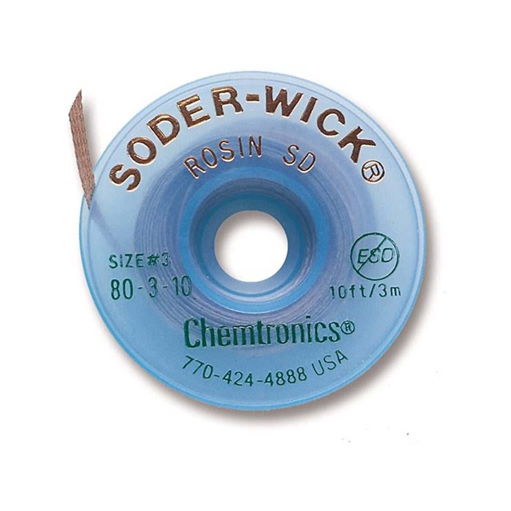

Well, the surgery was a success!  I went with the original plan of placing damp cloths over the hand rails and plastic bridge deck.  Thankfully I did because I did have one instance where the iron touched the cloth that was covering the hand rails.  Anyway, one thing I realized was that it would be a good idea to use one of those solder-suckers to remove the blob of solder left on the rail.  Since that solder covers the foot of the rail, it can make it challenging to slide it out without damaging the spikes that hold the rail in place.

Solder sucker does come in handy, but most of the time simple solder wick works pretty well.  But always remember to add some flux (even if it states that flux is not necessary).   It is also relatively inexpensive and no cleanup is needed after use.

That's really about it.  I just had to be really careful not to touch the hot iron to any of the delicate hand rails or plastic bridge deck.  And as mentioned, a solder wick would be a wise choice to remove the solder from the rail.  The rail will slide out much easier this way, and those spikes that hold the rail in gauge will have less of a chance of getting damaged in the process.

I successfully completed this surgery, I had some ME C55 rail that I installed.  Solder braid is a must to unsolder the wire feeders.  Once the wire feeders are de-soldered, it was easy to slide the C80 rails out and slide the C55 rails in place.
