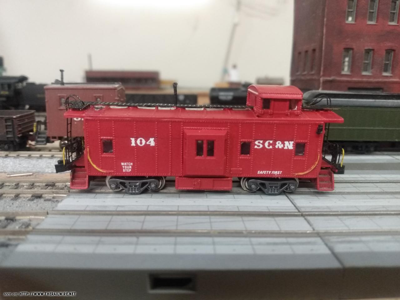

About one year past, I bought this old C-C bay window caboose at a show.  The reason that I bought it was that someone had added a cupola to it.  He did such a good job that I had thought that it came that way.  I posted a "What is this?" to a Weekend Update.  Several posters pointed out that it had to be a bash.
I wanted to run it on my non-historic railroad but wanted to do something about the clunky ladder side rails.  I had a Gold Medal dress-up kit designed for the MP bay window.  As I had used one set of end railings to do something about the end railings on a B-mann caboose (the kit had enough for two cars), I expected that with a little surgery, it could dress up the C-C caboose.
The first photograph is the Gold medal and railngs and ladder on the B-mann four wheel caboose.
The rest of these are the dressed up and bashed C-C caboose.
The roofwalk, end railings, brake wheel/stand and ladders are from the Gold Medal dress-up kit.  The original roofwalks are not bad[ only slightly clunky.  The original end railings are  not bad, especially for the era of manufacture.  According to Spookshow, these models first appeared in the 1960s.  As my chassis is marked "Sekisui/Con-Cor", I suspect that this is an old one.  As one of the photographs show, the ladder side rails are a bit clunky.
On the original, the end railings/ladder are affixed to a plate that covers the couplers and keeps the spring in place.  I had to clip off the railings/ladder from it then affix the Gold Medal end railings/ladder to the end of it.  Retention of the plate is necessary to keep the coupler spring in place.
As purchased, the smokejack appeared rather small/low.  I was going to replace it with a MT but upon examination of the underside of the roof, I saw that someone had pushed it down far.  I pushed it back up with a nail set and left it.  The marker lamps are from a Kato mikado detail parts bag.
 The ride height is fine, so I left it.  The glazing is Micro Kristal Kleer.  Some swear by it; some, at it.  I do neither but use it for lack of anything else.  The reporting marks and number are MicroScale.  The safety slogans are from a generic caboose set that Rail Graphics sold prior to its going out of business.
The character of my non-historic demands wood cabooses but this is an unusual piece, so I am running it.  I guess that I will have to invent a back story that SC&N Management finally listened to the crews' complaints about the rough ride of the four wheelers or the two truck cabooses that ride on arch bars.

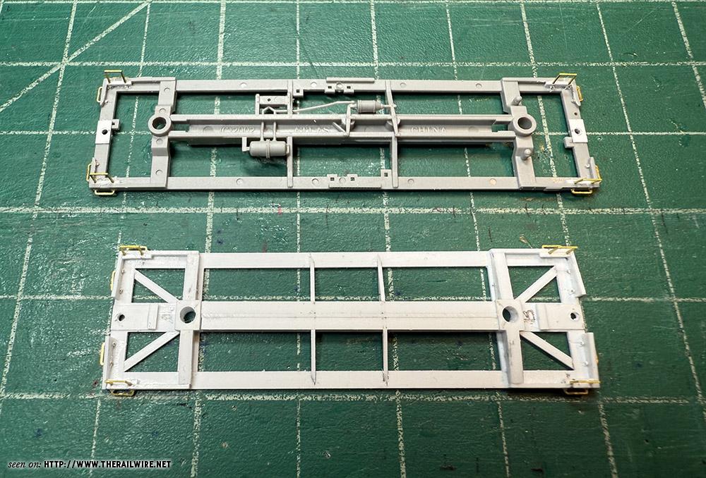

Not a lot of modelling time this past week, but made a start on detailing the underframes for my museum train tank cars, starting with Gold Medal grab irons and sill steps:

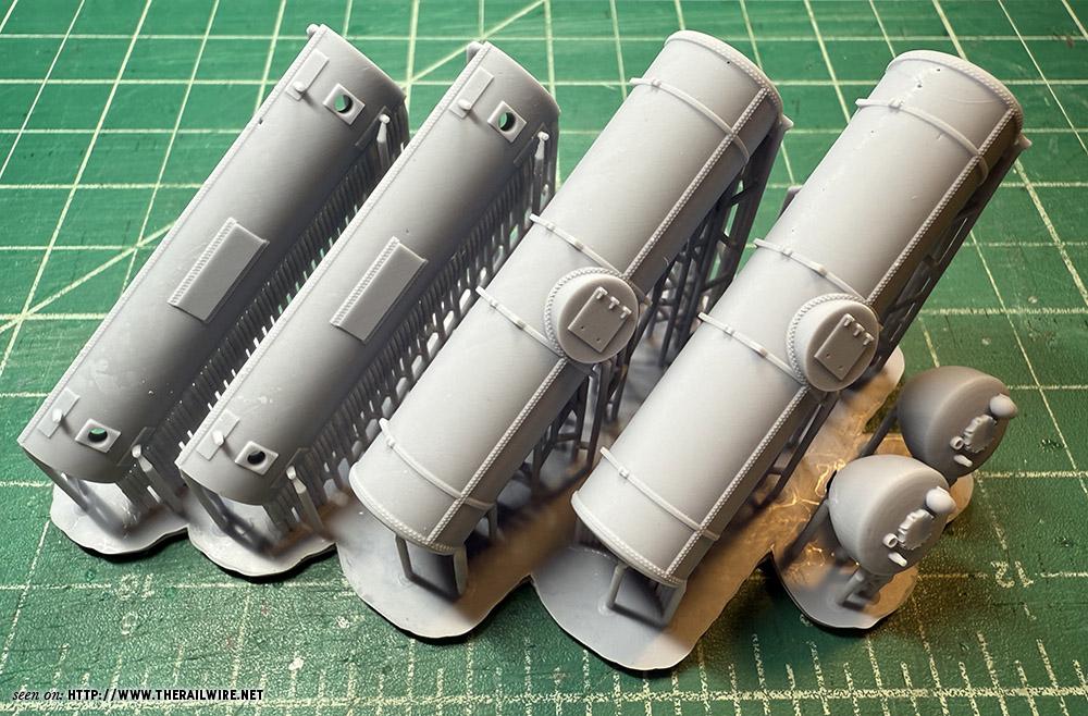

I also received prints of my friend Geoff's STL files for the water car tank and the fuel car dome from Bryan Busséy (thank you Bryan!):
What?? They aren't assembled yet??  :D
Looking forward to seeing the finished tanks, as the intricate detail incorporated into the digital models is spectacular.
