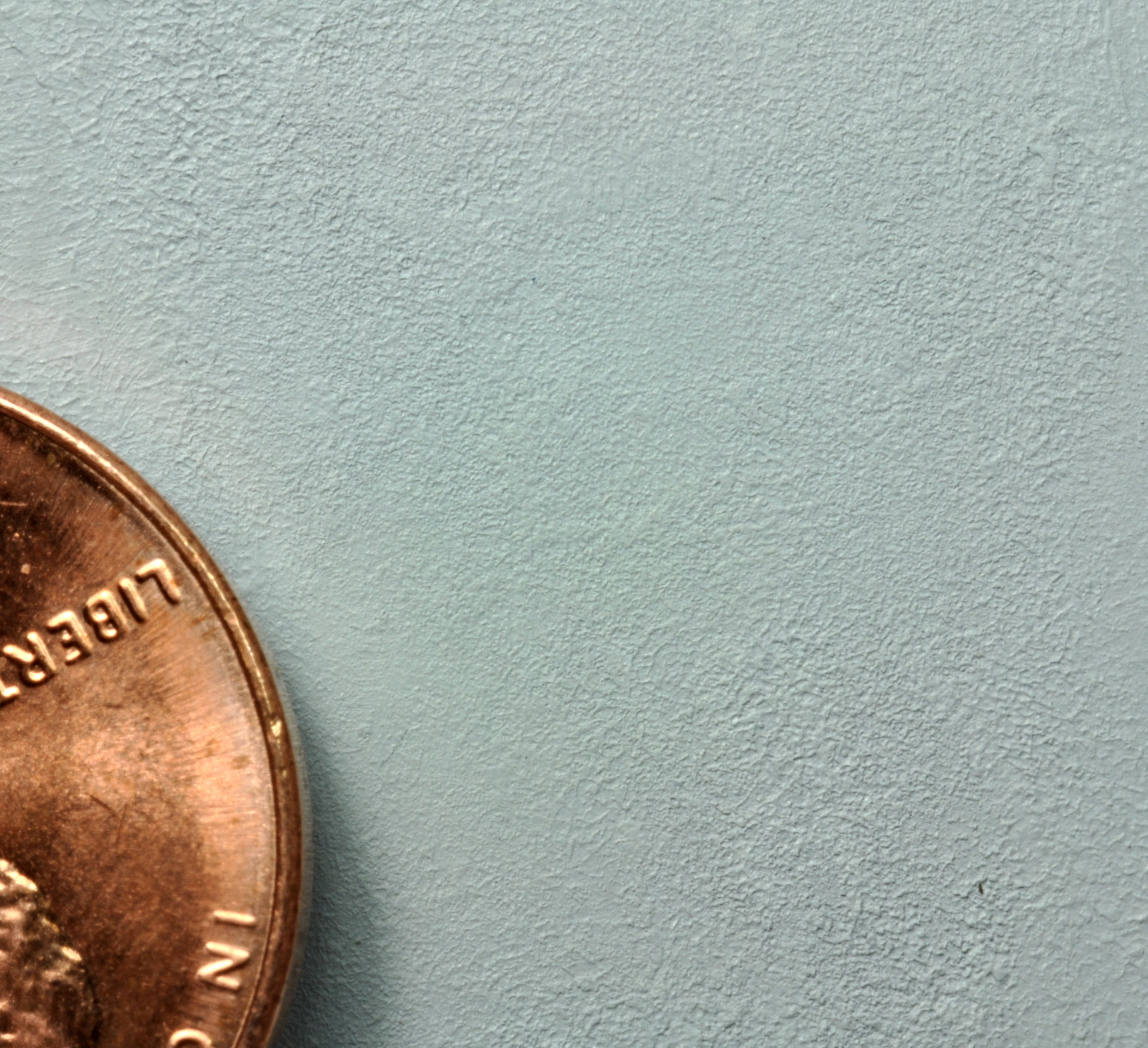

« Reply #9 on: August 14, 2024, 03:57:07 PM »
This is the missing pic from my post in one of those threads.  It's paint dabbed with a makeup wedge.  While I think it's pretty effective, it was a bit of work and you had to time out the tackiness of the paint.
