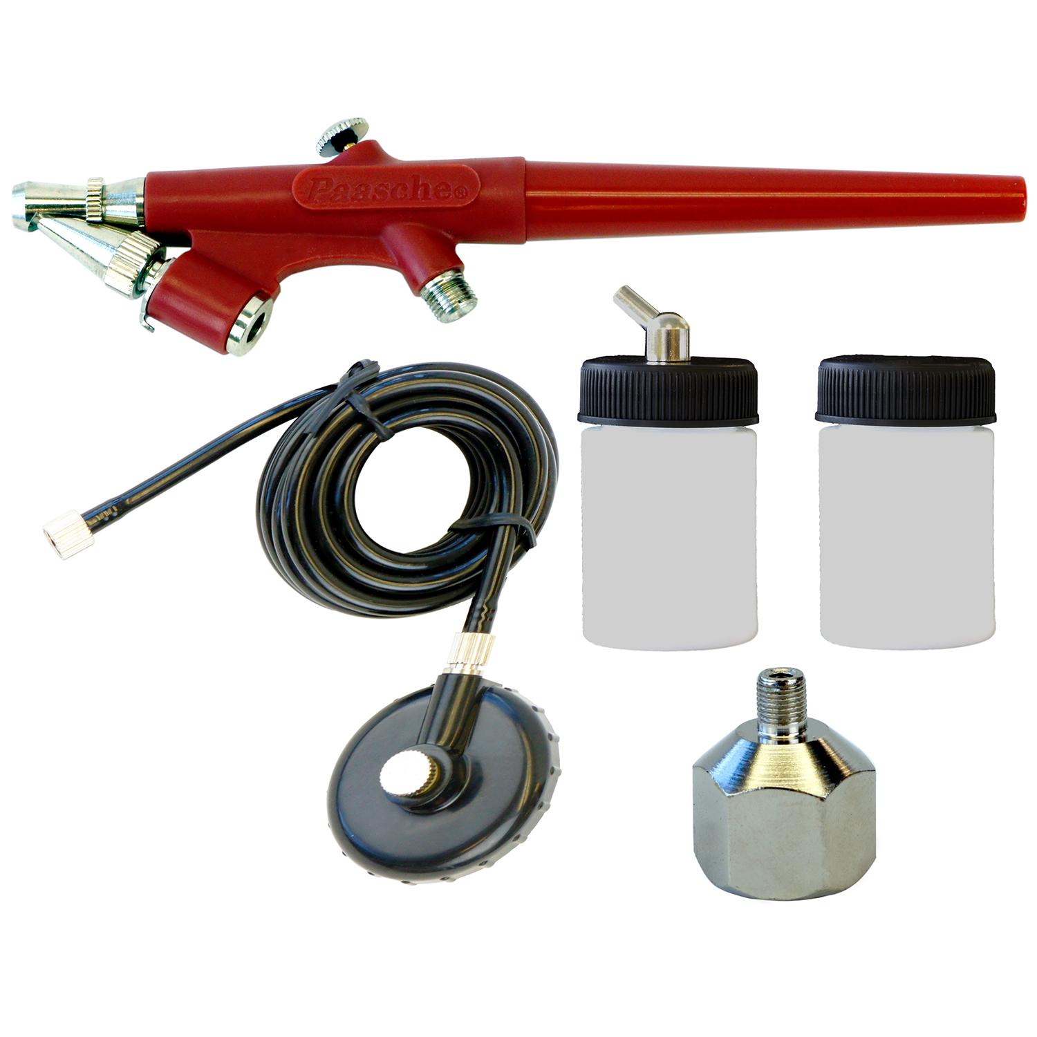

« Reply #70 on: June 04, 2025, 12:28:46 AM »
But no clear green. Ok.
Might it be worth attempting to convince the OP to acquire an airbrush?
Paasche has this beginner's kit, which is available from Amazon for about $26.
All it needs is a can of compressed air - likely sufficient to tint those dome car windows.
That would afford much more flexibility in choosing paint types and colors.
https://www.paascheairbrush.com/product/4927
https://www.amazon.com/Paasche-EZ-STARTER-Single-Beginner-Airbrush/dp/B0007D2F8U

Thank you, everybody!
No point buying an airbrush, no more painting than I do.  And what I spray paint HAS to be painted outside.   Even old Floquil brush paints are used outdoors.  We have allergies!
