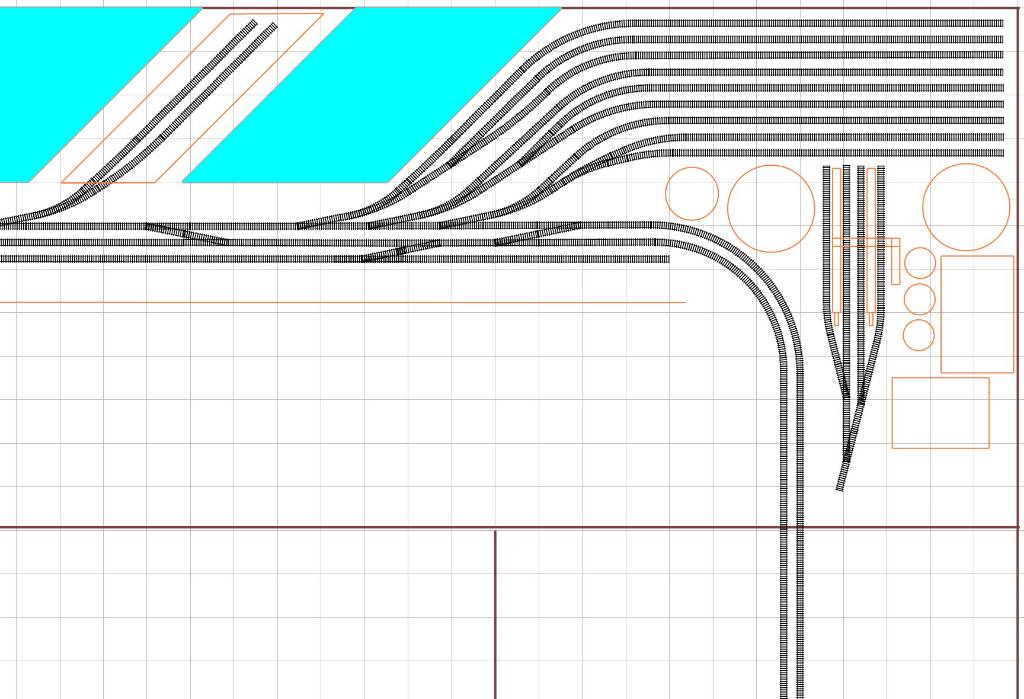

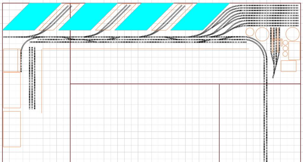

Moving on with the design, most of today was spent cataloging the different building kits available and getting their footprints into CADRail. Most I will be kitbashing and several have already arrived. With these I am beginning to place them so I can continue with the track design. Here is the extent so far.
On the left I placed the Municipal Storage Yard but I may remove 2 of the tracks at the back and inset some flats to continue with the industrial scene. The Publicker Alcohol facility will be kitbashed buildings, both N and WO storage tanks, two fractor columns from North Island kits and room for a 12 car tankcar loading section.
On the right, I have figured out the Baileys and both Merchants Warehouses. The Baileys had on-street loading so just a spur. The Merchants had boxcars rolled right into the interior loading docks. I will have to wait for these kits to arrive to get the spacing correct..
As soon as I hardcode what kit(s) I will build Gallaghers Warehouse with, I can do it and the open unloading lot next to it.

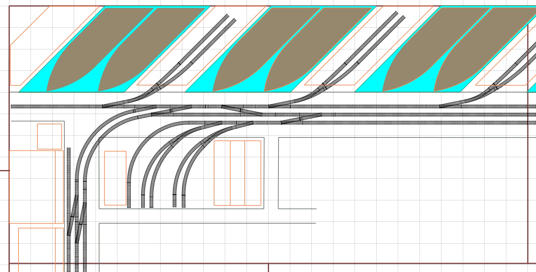

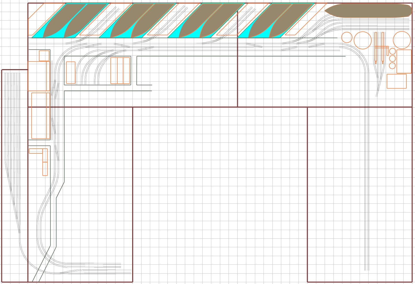

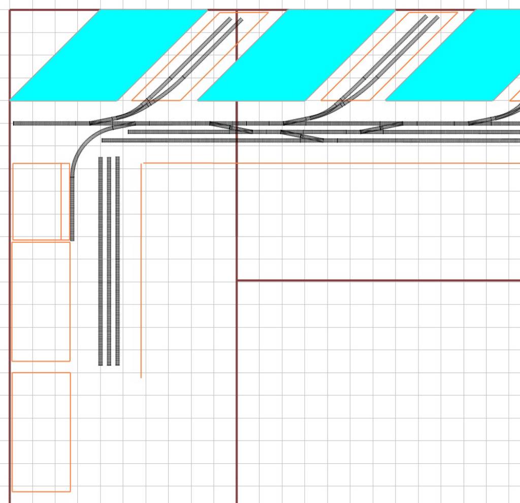

Slowly the plan is evolving. With the plans for the Liberty Ship arriving, I was able to get the outline so I could add them to the plan for a better understanding of what my vision is. I did scrap the idea of putting industrial flats in the rear right corner and I will put a full width Liberty Ship or maybe just one cut in half. This pic show all the new trackage that has been added as well as a new definition of the module dims so I would not be concerned of any switches at a module juction.
The left rear module is getting better defined as I get more building kits in and have planned the kitbashed sizes. I also added the open lot scene I loved so much between Gallagher's Warehouse (left) and the Pennsylvania Warehouse (right). The left side of layout will contain Bailey's Warehouse and the Merchants Warehouse.
Right rear module with the ship (full or half) to block looking directly at a blank backdrop.

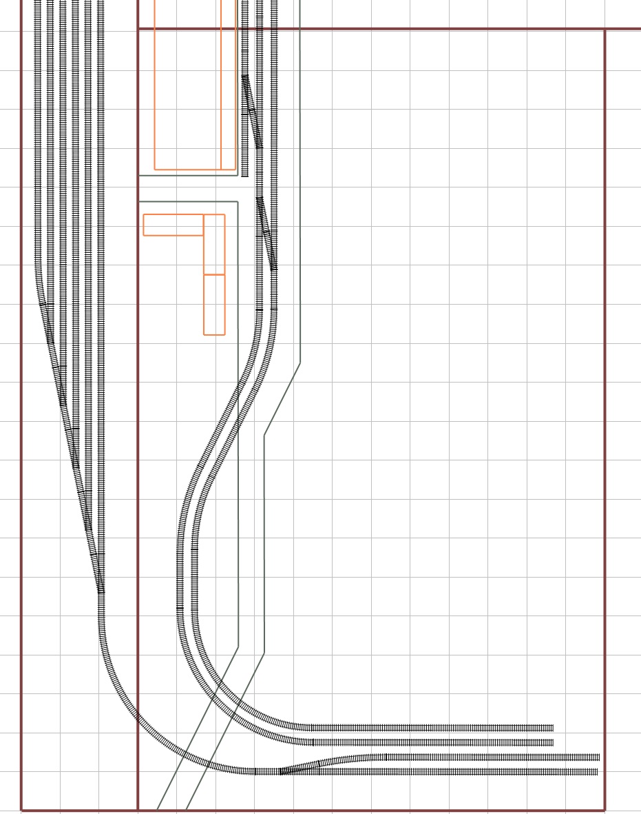

The left module where the staging yard, arrival/departure tracks and classification tracks will be.
