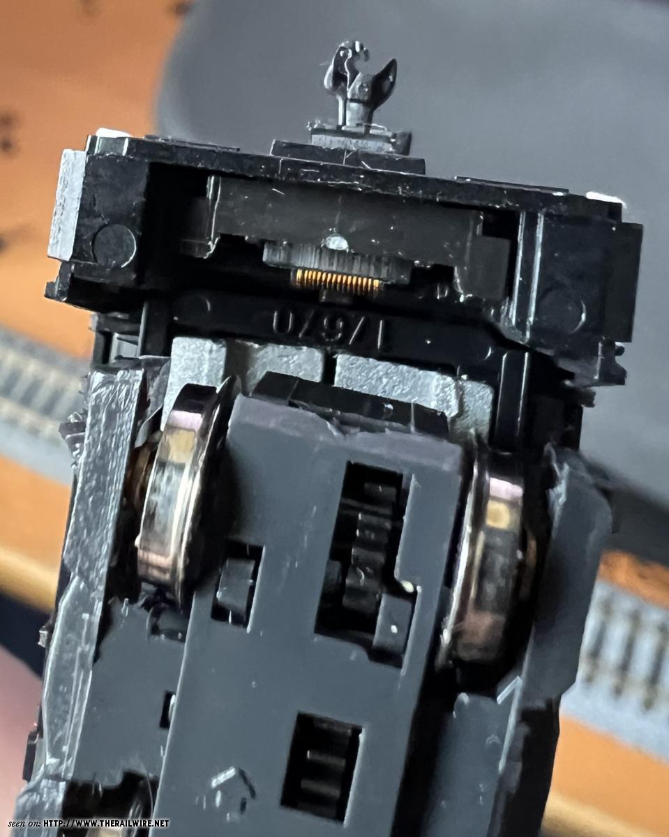

Can you make a box that looks right on diesel pilots? Something about 1015 sized, that fills the hole common on a lot of diesels. Maybe one of your existing designs works, but I wonder if something specific for locomotives would be worth while.
Yes, its next up. Its presently under development, in two forms. One for general "1015" scenarios, and one specifically for Kato straight shank scenarios (So many, but not all, Kato locomotives. Kato has at least two different body mount shank styles that casually look the same, mount in an identical fashion, but are set at different heights. Nice. Kato couplers... Always special!)
Locomotives can be readily converted using a shim in a factory box. But given the prevalence of locomotives using "1015" type boxes, it totally does make sense to produce such a part for sure.
Loco quick breakdown of shim install in factory "1015" type box:
Now, the scalebox does in fact fit locomotives. In fact, it fits Kato locomotives too (straight shank), and you don't need to tweak a single thing either. No pilot filing to speak of, use the OEM clip, absolute perfect drop in. You install the Scalebox upside down with the hat.... The height it spot on perfect. The look is not quite right however, but it certainly works.
Scalebox in NW2:
Scalebox in ES-44:
The issue with scale couplers and locomotives ultimately comes down to overwide coupler boxes. Some concession to model railroad corner reality does come into play, but in many cases its wider then necessary for most reasonable corners. My locomotive specific box design will be 1015 width (so too wide by large margins really) but fill in the big-ol-hole, and also have more lateral motion so that long diesels will be more corner compliant. The scalebox does work, but its not an ideal option.
