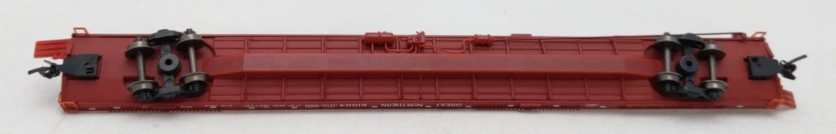

https://www.ebay.com/itm/297437730138?chn=ps&mkevt=1&mkcid=28&google_free_listing_action=view_item
So if you had the coupler against the frame of the car and custom bottom lid to hold and center the coupler... that accepted the screw from the top (gigity...).. Would that work?

If the deck height is a match to the prototype, then the only other thing that could be off that much is that the draft gear should actually extend up over the deck of the car.
So, do you want to do it right?  Better modeling through peer pressure...
  • Posts: 5421
  • Respect: +2193
Re: N-Possible Coupler Announcement (Nashville 2022)
« Reply #647 on: September 11, 2025, 09:22:29 AM »
Ha, look at this one.  Is this a triple deck remnant?

It sure looks like these boxes are screwed in through the top... So do these cars work with a metal underframe underneath a complete plastic deck on top? It looks that way... To service the coupler, you need to remove the underframe from the deck?
(The trainworx gondola's have that setup. I have to say I really find that VERY annoying!)
How I would approach this conversion (based on this picture so purely speculative):
Cut the entire metal box section out of the metal underframe. And then glue a topless box onto the plastic deck. You'd need to glue it as there is not going to be enough material to put a screw in on the plastic deck (unless you go through the top but that would make for cosmetic things to deal with on the top side)

Trainworx flats have metal underframe and metal deck.  The bottom part of the coupler box is retained by a screw installed from the top of the deck, then covered with the metal deck. The top part of the coupler box is actually in the metal underframe itself They use MTL underslung couplers.
Is the N scale MTL coupler height actually modeled to scale (is the coupler placed as 1:160 height of the 1:1 couplers).  I always thought that original rapido couplers first used in N scale toy trains were placed at some height pulled-out of a hat (or based on European coupling standards). Then MTL couplers came along, they just used the same height for compatibility and for easy rapido/Kadee coupler conversion.  If that just happens to be in correctly scaled height, that would be a bit of a happy coincidence.
