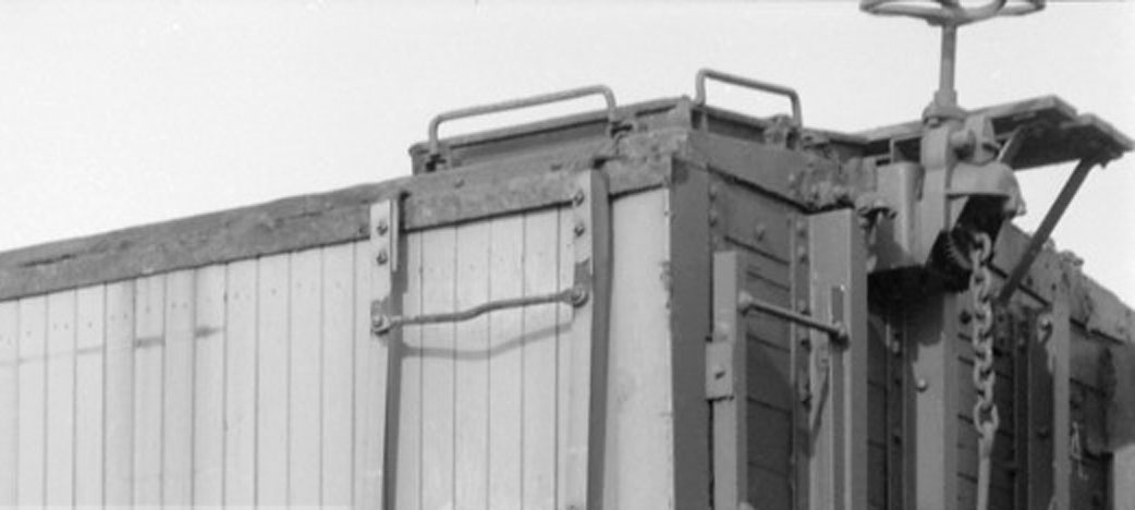

I found a photo, probably the one used for the decals. On the Lakes States Railway Historical Society website, I should have thought to look there sooner.
Nice find Tom, I thought I had been through that whole freight car album but don't remember seeing that pic.
What do you think, is that a metal roof?

« Reply #21 on: May 07, 2020, 01:17:12 PM »
Tom L
I would say the roof has a metal sheathing.  It looks to extend over the side boards down a couple inches.
You can see a row of rivets along the side of the roof and the ends certainly have a metal capping.  The hatches appear to be metal because of how thin they are.

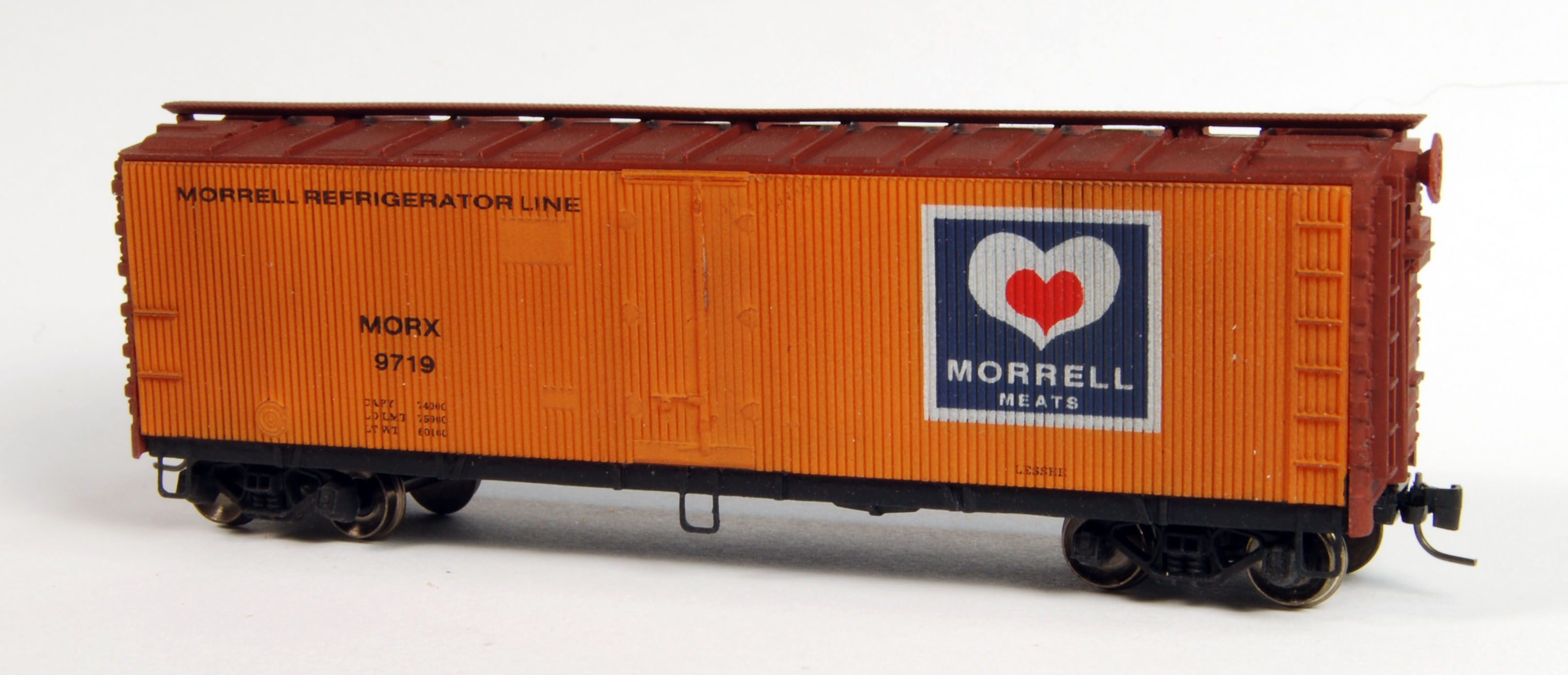

I don't know if this would work with the MTL car, but adding the metal supports under the boards makes a unique car.
I don't think this is a Microtrains car, It might be an old Precision Masters.
Randy
Yeah, I did this with the PM car probably since it was a kit.  I just didn't know if the same could be done with the MLTL car.
Hey that is nice. I was wondering about making that funky side sill with those brackets.
 I’ve got a Atlas wood reefer in the stripping bath right now. So let’s see, add metal sheathing to roof, some work to ends to add those vertical braces, file down the fishbelly frame and those brackets. Oh, and metal hatches.
So what started off to be a “slap it on whatever car is closest” will likely turn into a whole project.
I’ve got to finish this first, doing what Micro Trains should be doing for us. MT wood reefer sides with MT steel reefer ends and roof for a rebuilt car.
