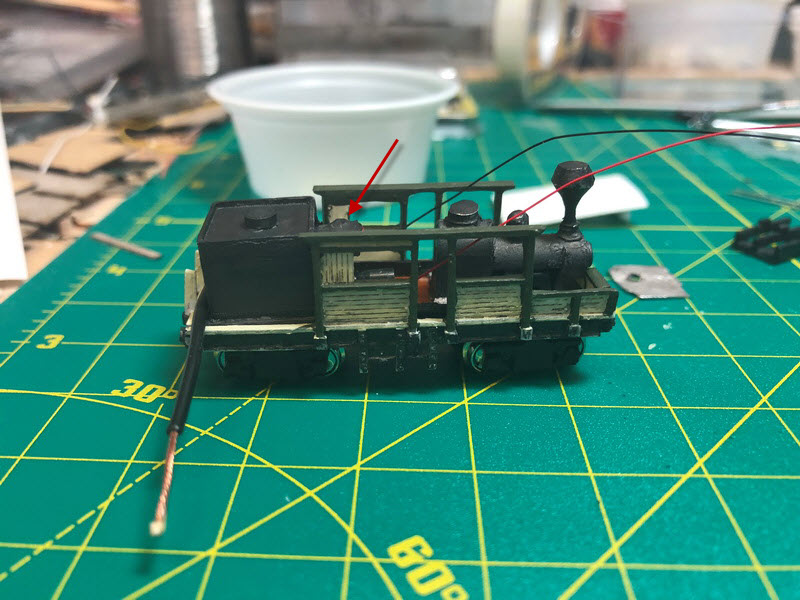

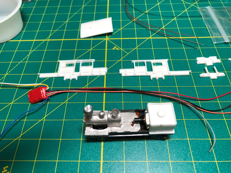

Excellent work! Which decoder did you use and was it mounted in the square metal weight that sits over the drive shaft? Got any photos of the install?
@160pennsy, Unfortunately I did not take a bunch of photos during the build, I'm really bad about not taking any pictures until I finish up for the day.  But I will try to explain using the two (2) photos I could find.
I used a DZ126 decoder seen here
It is hard to tell from the photo above, but there is a gap between the engine and the top of the water tank that is just slightly smaller than the height of the decoder.  I cut and filed back as much as I could, and then finally decided to cut off the top of the tank, add an 1/8th inch spacer and then glue the top back on.  I then painted the exposed portions of the decoder flat black so that it would not stand out (I have an arrow pointing to the part that is visible below.) Once I added the weight over the drive shaft, and painted it flat black as well, the decoder just disappears into the interior shadows.  If you look closely, you can also see the remnants of the putty I used on top of the water tank to hide the spacer seams where I had not fully sanded it down yet.  The red and black magnet wires are for the, at this point, still to be installed headlight.  Those wire were buried under the wood piles.
