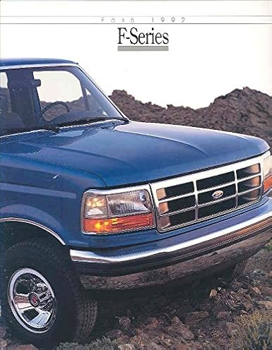

Hi Carter, nice paint job.  As I keep looking at this model, and having worked for Ford, there is something that the model is missing.  The two grooves between the healight housing and the grille and between the headlight and the turn signal.  It is modeled as if it were one piece, but the headlight/turn signal assembly and grill were all separate parts.  Seems to me a groove like the door opening grooves could be modeled there:
Might even make the grille and headlights easier to paint.  BTW have you tried the Tamiya panel line product for things like this?

I agree, that touch would add a lot to the look of the models, but I expect it is too late now without causing considerable delay, especially as it means 'metal on' rather than 'metal off' the tooling.

My thought's exactly.  Unlike the infamous wide/deep board gaps in Rapido Trains meat reefers, where metal would just have to be removed to make the gaps more to scale, here, they would have to add metal to the mold
But these features could easily be represented by adding black lines during the shell decoration. Trainworx super-realistic trucks have all of their door lines painted, and they look great.

Or perhaps if the light unit/grille part was moulded in clear plastic, there would then be a clear separation between the painted grille and the 'lights'. That may even be the intention on the production models. I guess we'll have to wait and see.

While I absolutely want clear plastic windows in N scale models, I'm on the fence when it comes to clear headlight/tail lights.  But this is not a 3D prototype - it is a test shot. Doing the headlights as a separate part would pretty much require redoing the molds and producing additional molds for the headlights. I doubt that this is feasible.  Besides, the parts count adds to the cost of the molds and assembly.

Nothing a fine tipped black marker can't fix.
I mean it is just a pickup after all, not the primary focus of your layout, I hope.
I could see all the handwringing if this were a 1/25 Scale plastic model that you intend to enter in a contest.

Or each headlight could be a decal that includes a hi-res image of the headlight, turn signal light, and a thin black border.
