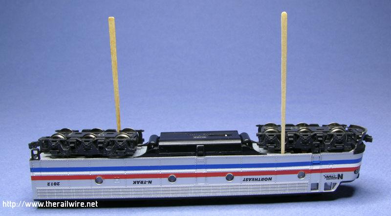

  Half the time was trying to get the shell off without breaking it.  The usual "drop method using the jewel case" does not work due to the pilot and rear deck is NOT part of the shell.
1.  When TCS' website say to spread the front left and right rear of the shell to remove it, this is with the reference that the loco is on it's back!  Not upright!  Thus I had so much trouble removing it.  On those corners there is a clear inside piece that has a notch that hooks on to two matching tabs on the metal halves.
I cringe every time someone mentions the "drop method"  It is really asking for trouble.
Also make a mental note - it will never work on all the full-width body Kato locos because those have latching tabs which need to be unlatched by spreading the body outwards.  There are 2 latches (like TCS mentions) and inserting 2 toothpicks works really well to unlatch them.
The latches are on the left front and right rear sides of the model.  Here is an E8 for example.
The latches consist of a protrusion on the metal frame and a slot in the "glass" insert of the shell. The toothpick has to go between the metal frame and the "glass" insert to release the latch.  You do have to do a bit of detective work on each different loco to  locate their location. The toothpick has to be inserted next to the latch (not right on it).
Front latch
Rear latch
Once the toothpicks spread the shell and release the latches, the shell can be pulled off the chassis. The toothpicks will go flying but that is not a problem.
« Last Edit: December 01, 2017, 11:24:19 PM by peteski »

Exactly Pete!  Took me forever to find out since all my other Kato's have a different shell style and the drop method works perfectly on them.  No trouble at all and it works every single time.  We're not talking about a foot drop, just 1/2 to 1 inch.  Before I do that I check the construction of each loco.  That's why on this loco I didn't try it even once after inspecting it.  I don't do the drop for every Kato loco that I get my hands on.
I got the front latch off easily just by luck by spreading the shell in that area, not knowing you needed a toothpick to spread the latch apart.  The rear latch was a different story.  I guess I was jamming the toothpick between the glass and shell, which makes it worse and not work.  After I got the shell off I realize where the hang up was and how the mechanism fit in place.
