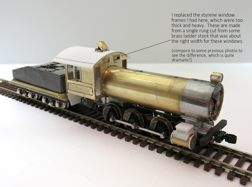

« Reply #172 on: October 11, 2016, 05:46:44 AM »
Ed,
Oh... ha ha I get it, the backhead sticking way out (before the cab is fully slid into place).  Yes!

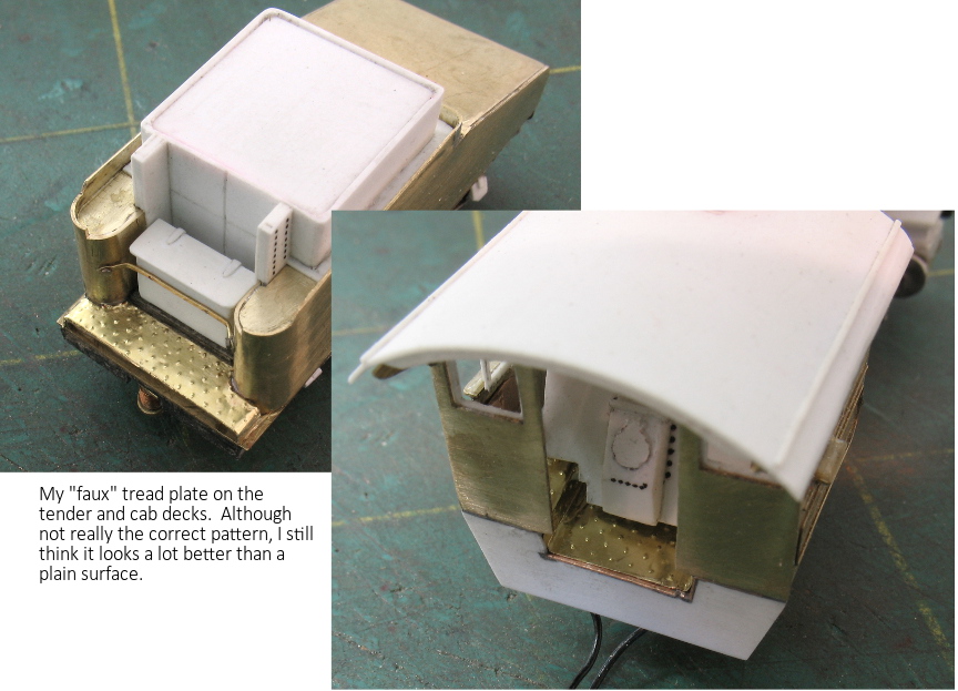

Thank you folks, as always, for such nice feedback.  I've done one upgrade since I posted these.  Those window frames around the two little windows on the front of the cab were just too oversized and they really started to bug me.
I made these by just cutting one rung section off some brass ladder stock.  It think they look a heck of a lot better than what I had on there.

« Reply #173 on: October 11, 2016, 11:30:26 AM »
Indeed...

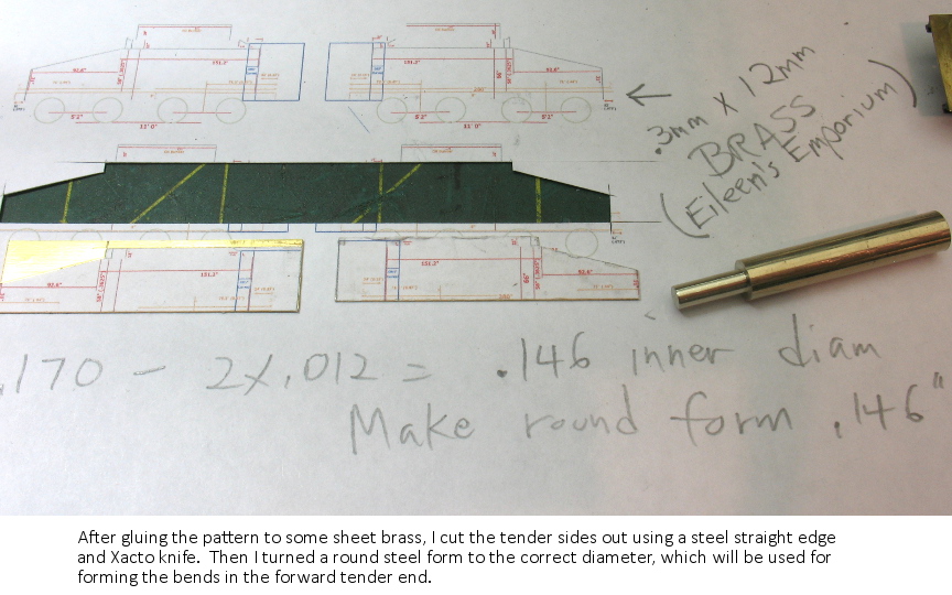

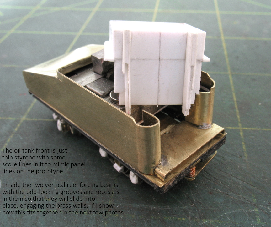

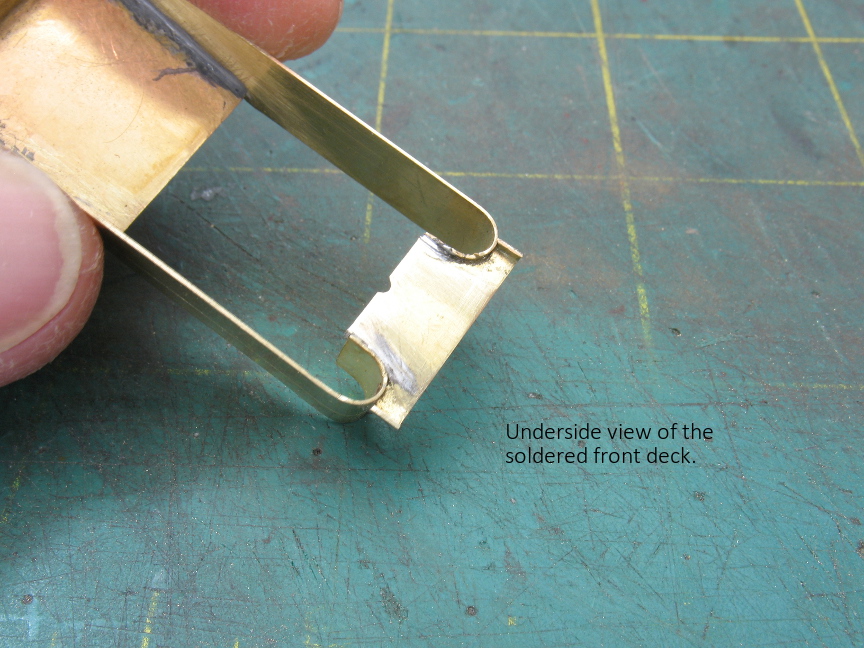

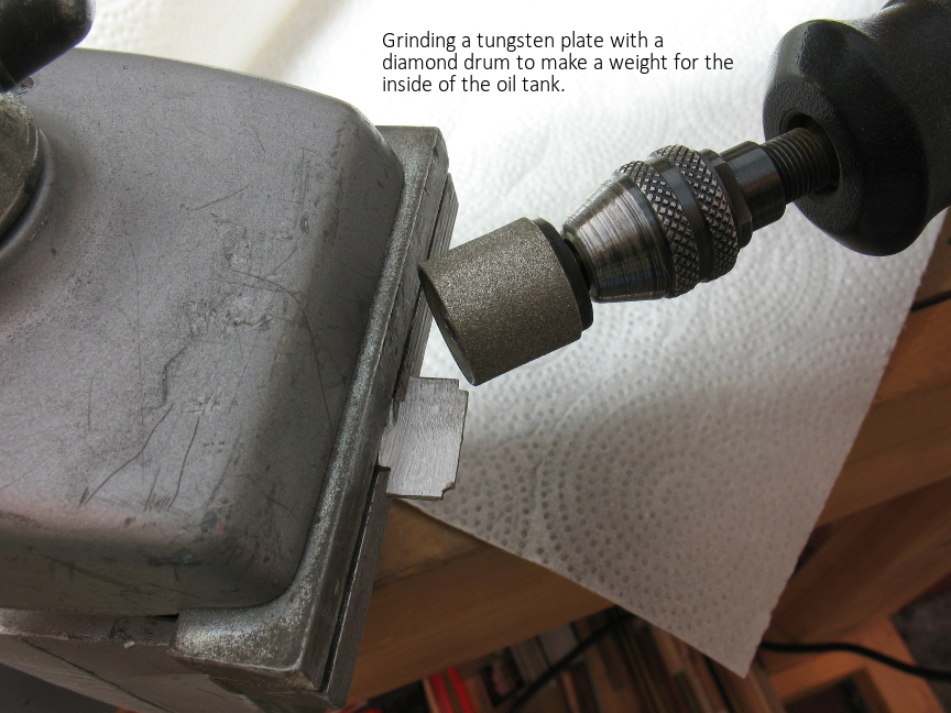

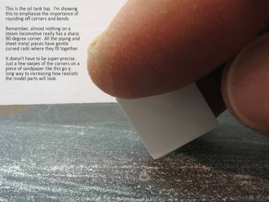

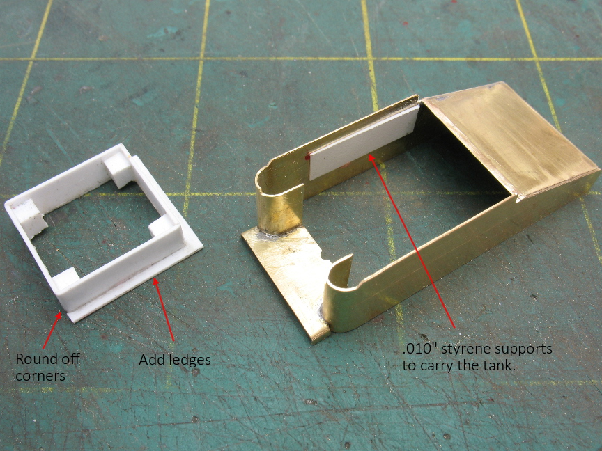

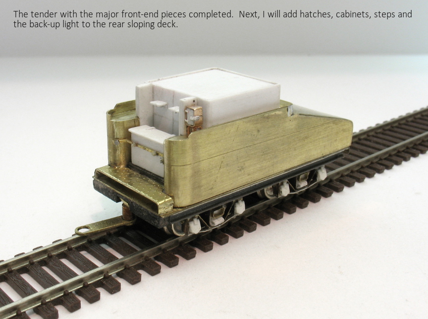

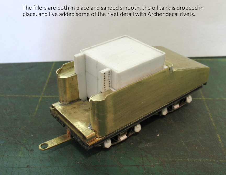

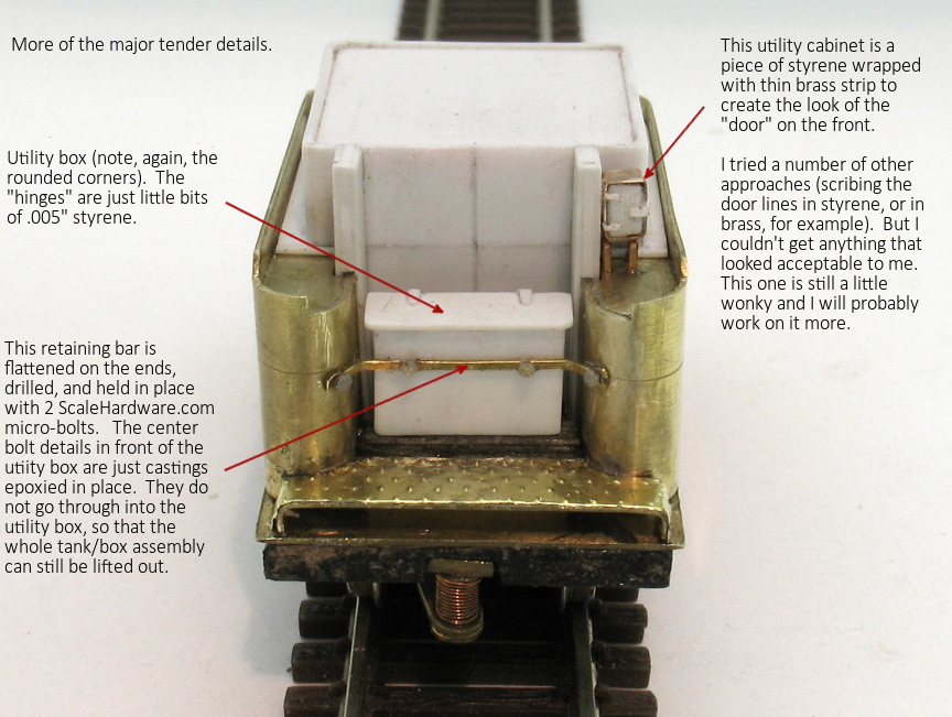

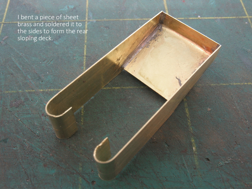

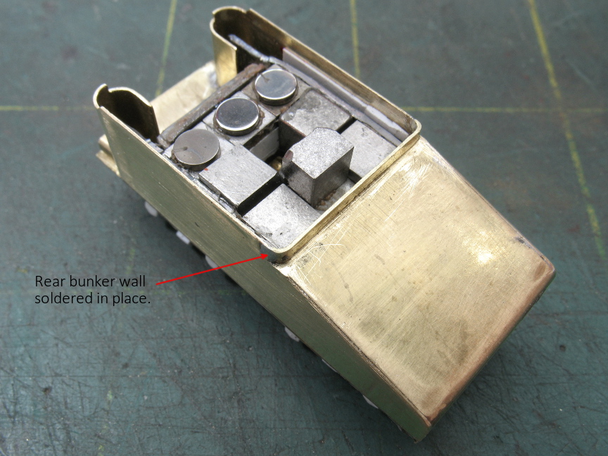

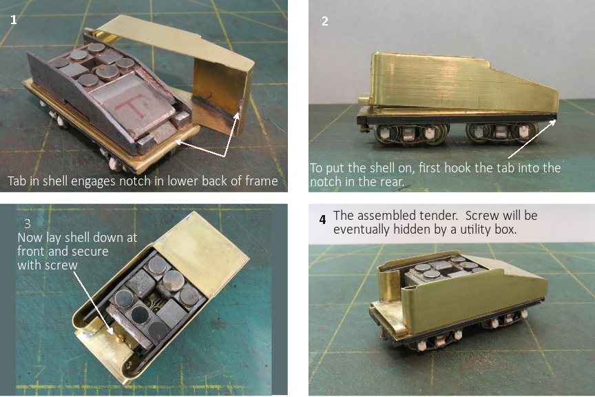

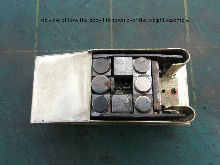

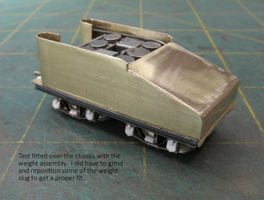

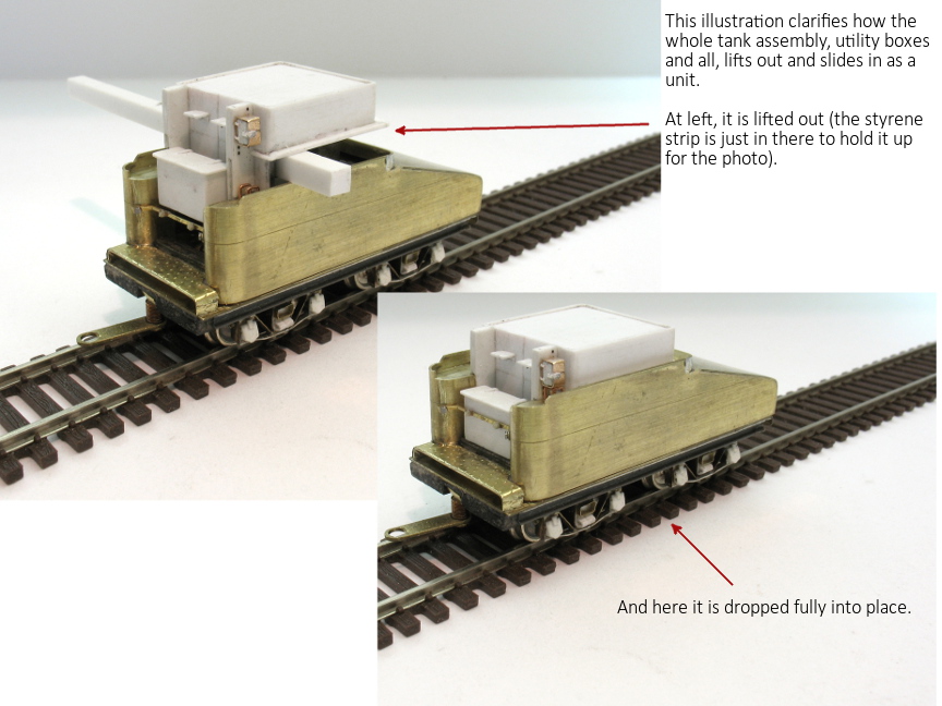

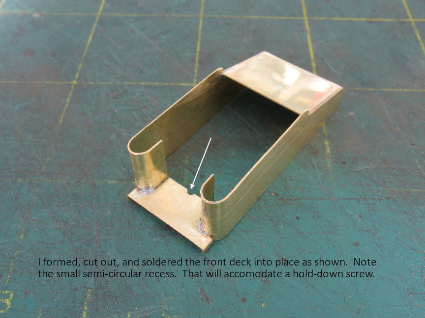

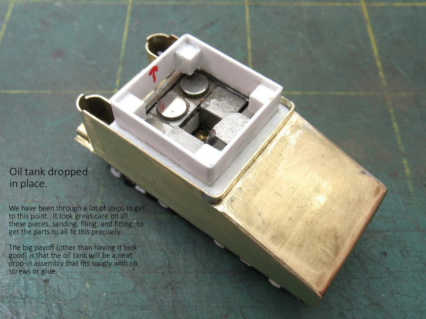

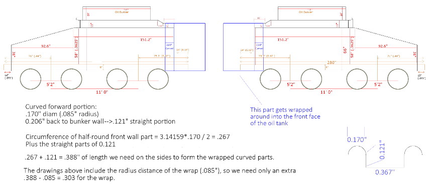

« Reply #175 on: November 06, 2016, 03:35:15 PM »

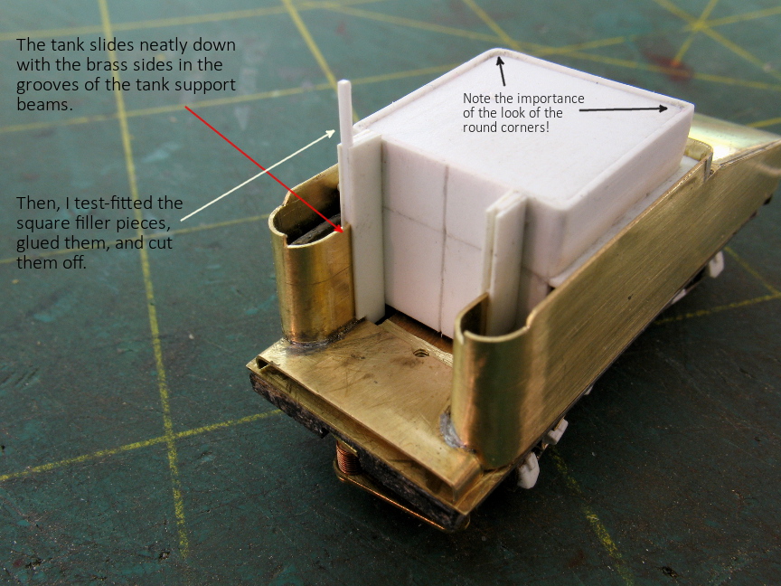

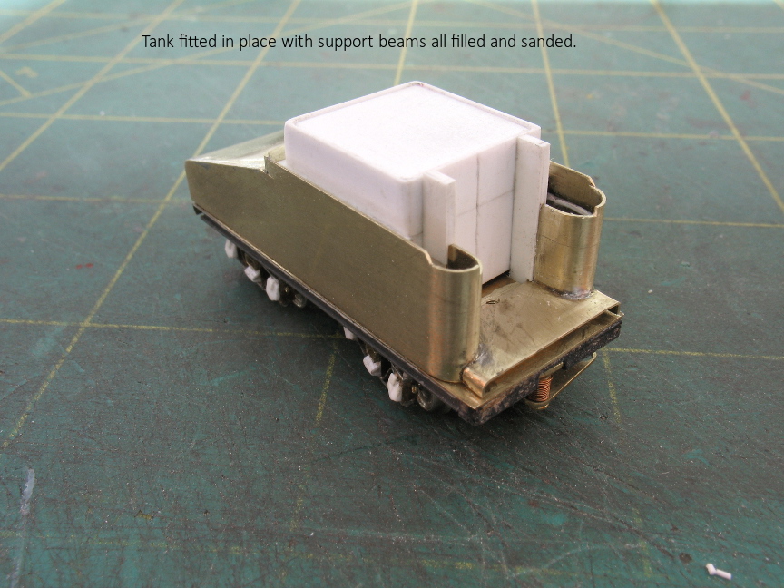

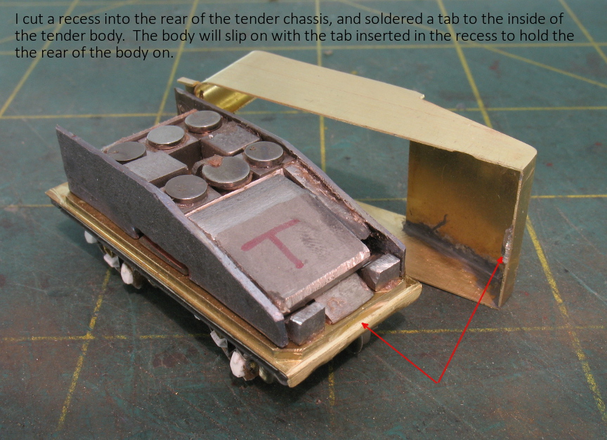

Tender Body Part I
Now we begin the tender body.  This first installments covers making the major body and oil tank sections.
There will be a second part (when I actually get the work done) for a lot of the major appliances and large details.
« Last Edit: June 30, 2017, 03:54:30 AM by mmagliaro »

« Reply #176 on: November 06, 2016, 04:04:16 PM »
Each post is like a 3 part magazine article.

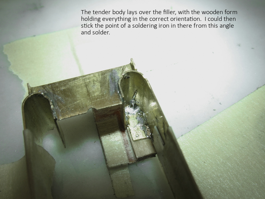

You soldered on those corner fillers without melting the styrene inserts?
  • Posts: 6507
  • Respect: +2025
« Reply #177 on: November 06, 2016, 04:32:30 PM »
Thanks, Chris!  You mean, those thin styrene sheets I have glued inside the tender walls to support the tank?
Right, those did not melt.  I draped wet paper towel over the rest of the tender body so that it wouldn't heat up while
I soldered those fillers in there.
