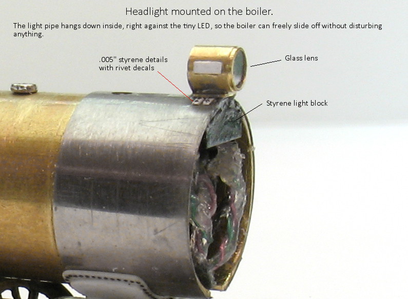

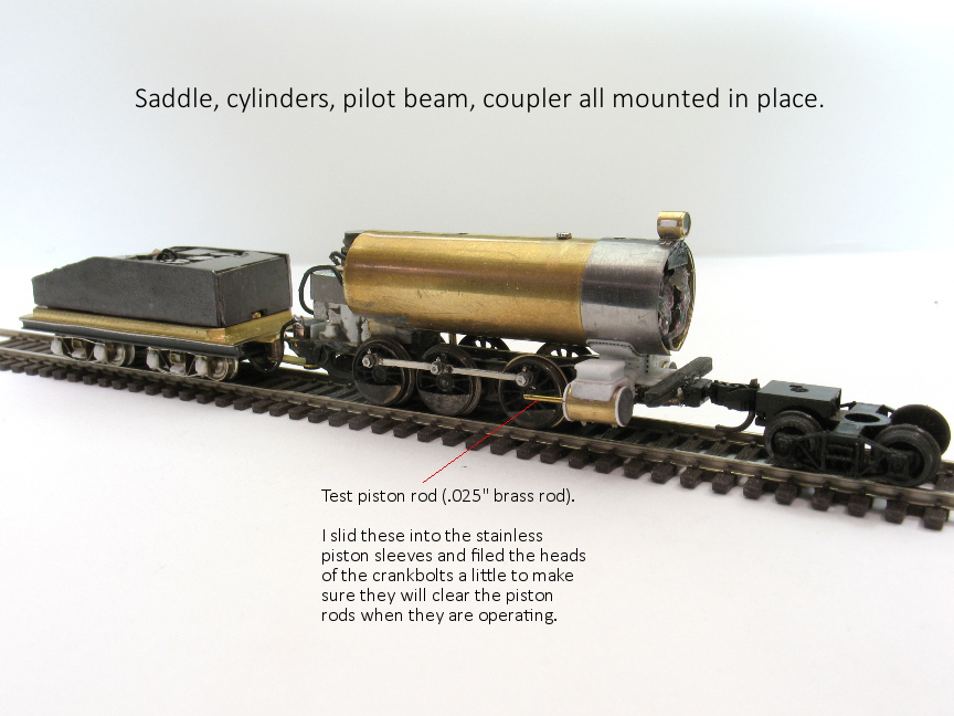

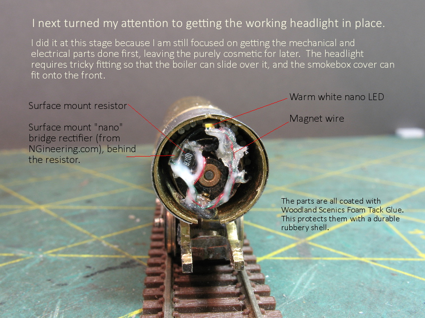

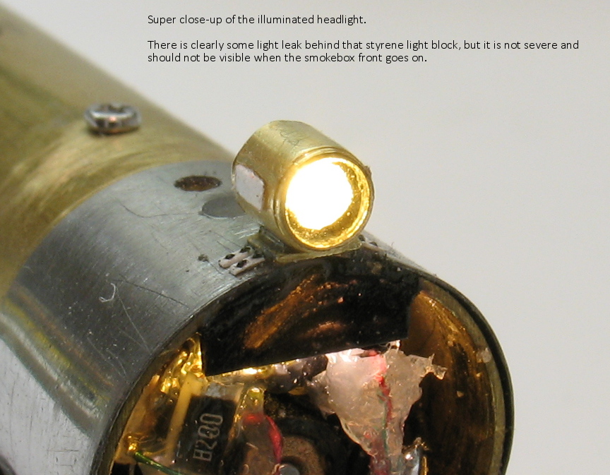

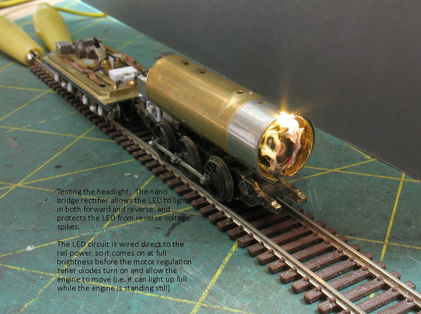

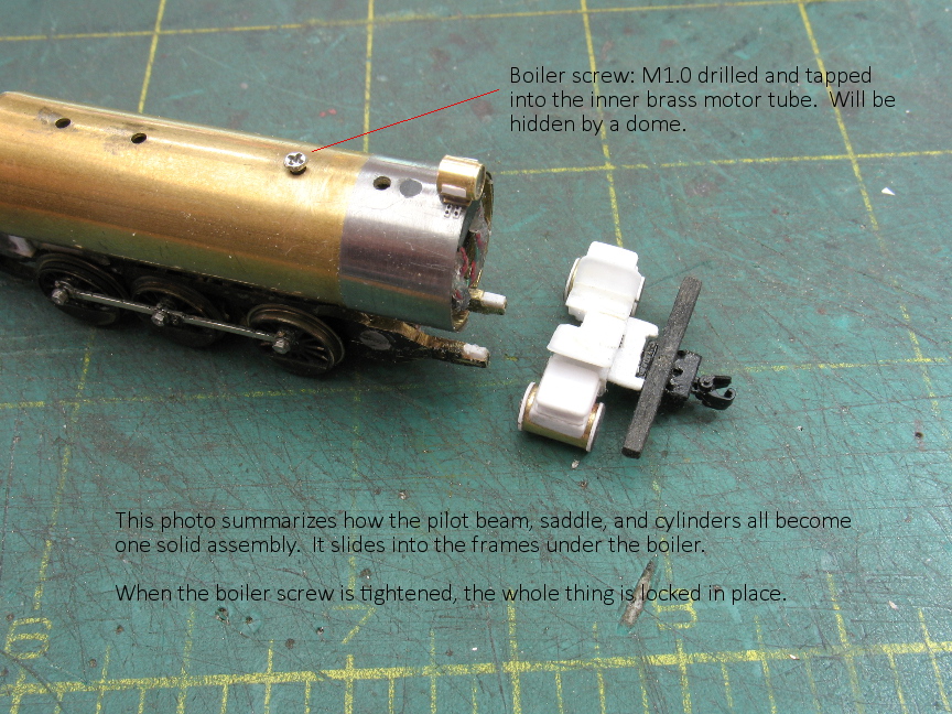

Today, we move to a selection of new pieces on the 0-6-0, all related to the nose.  These may not seem to be related pieces, but they are in the following sense.  I still have to focus on making pieces that have to fit, be removable, and have to provide some mechanical or electrical function.  Those types of things have to get done first before I can focus on cosmetic parts.
So this installment covers:
1. cylinder saddle
2. cylinders

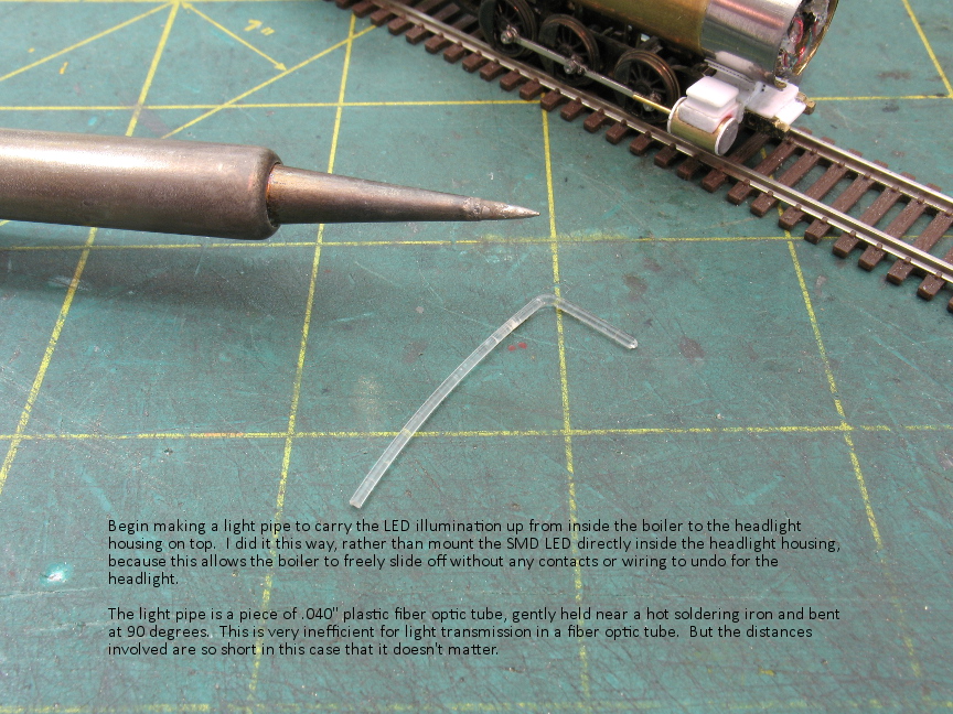

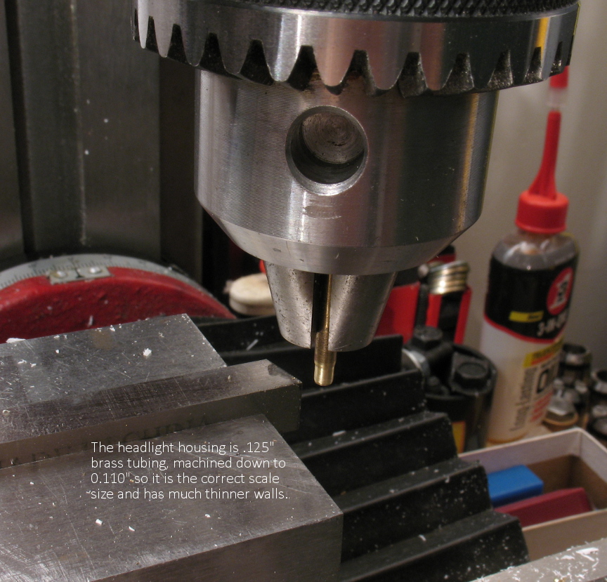

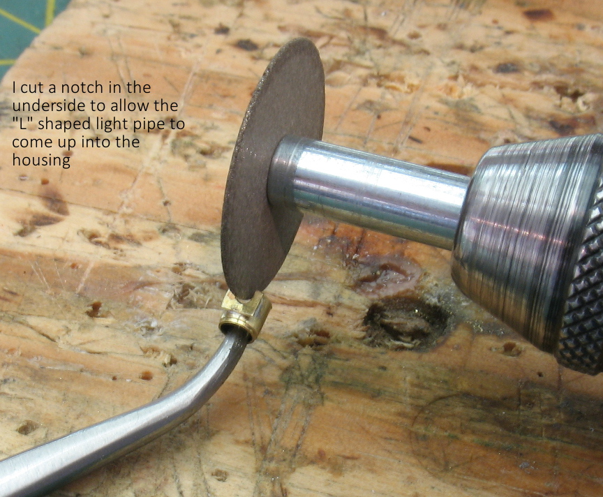

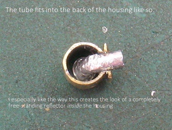

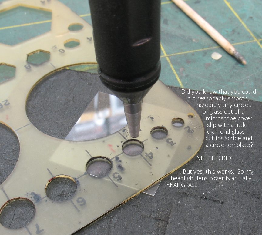

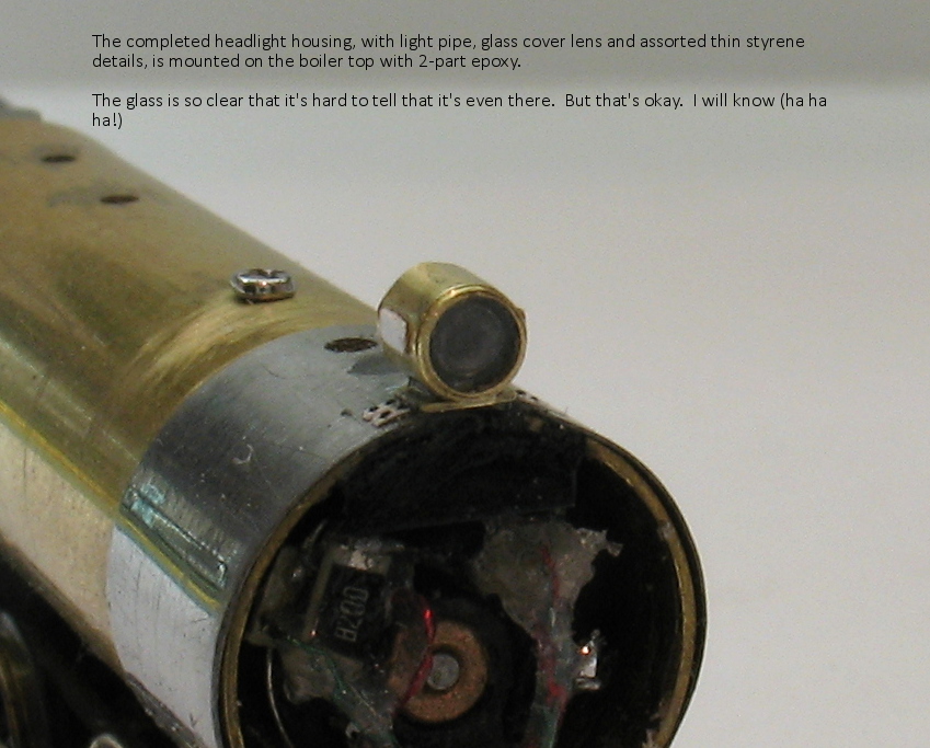

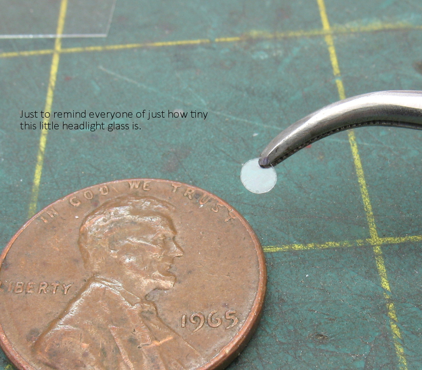

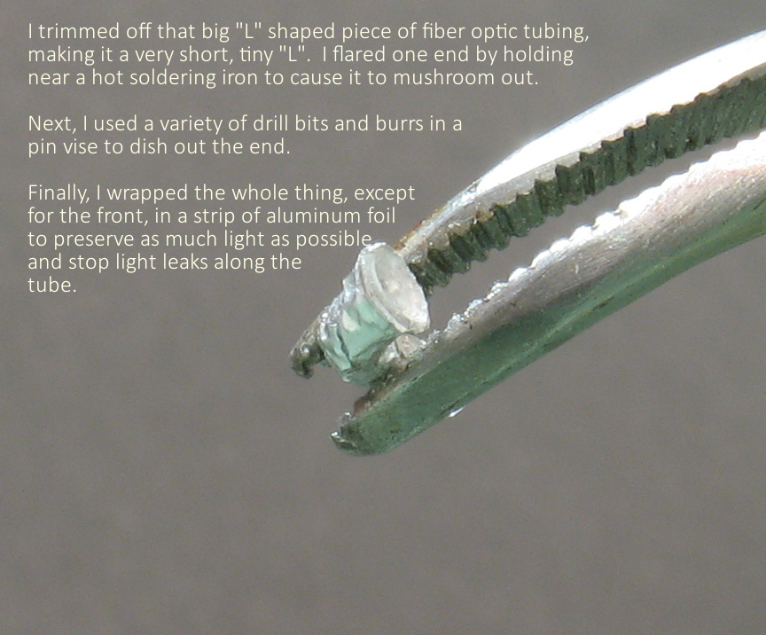

3. working headlight (and the headlight casing itself that sits atop the boiler) - remember, this has to all be
from scratch as much as possible, so I do not want to use any commercial parts unless I cannot possible avoid it.

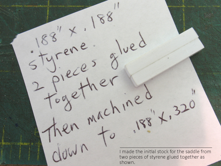

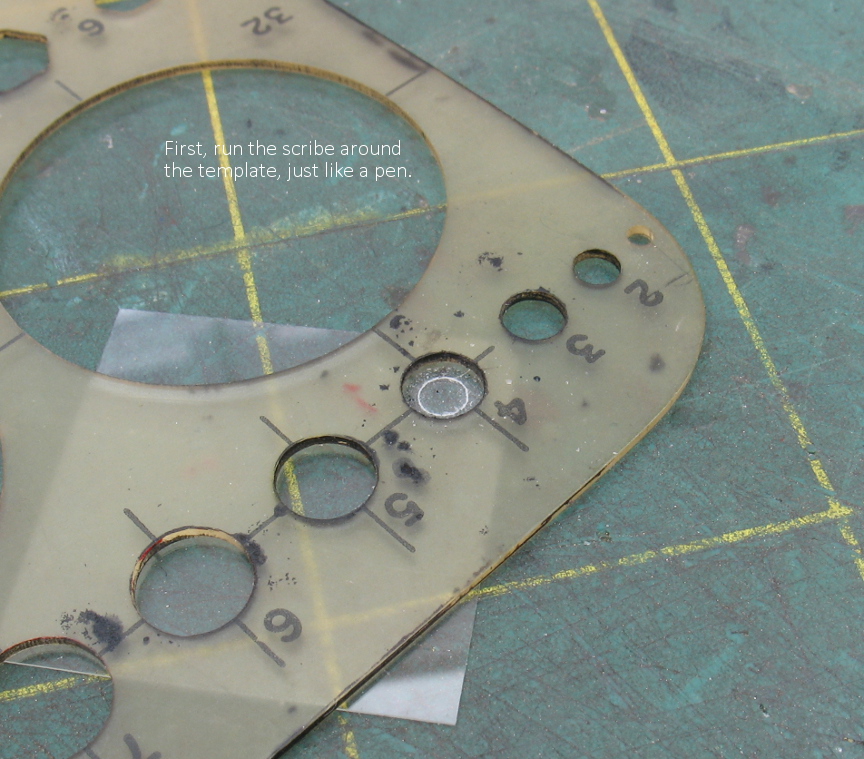

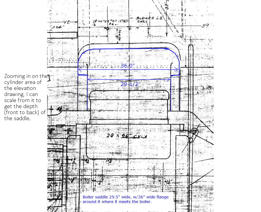

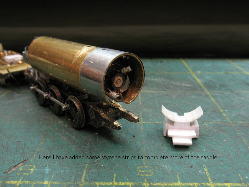

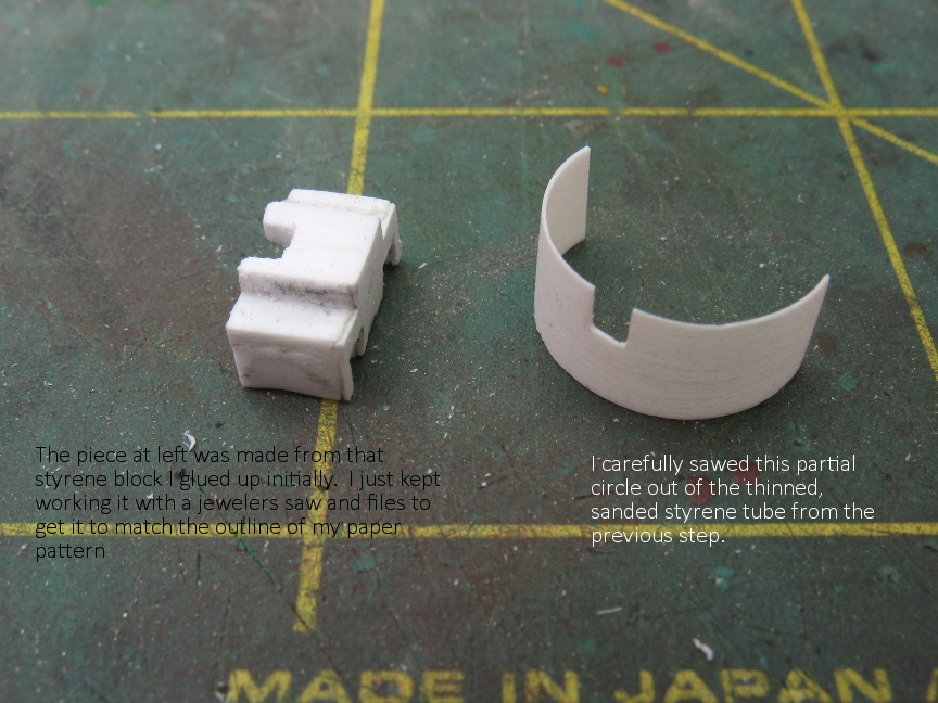

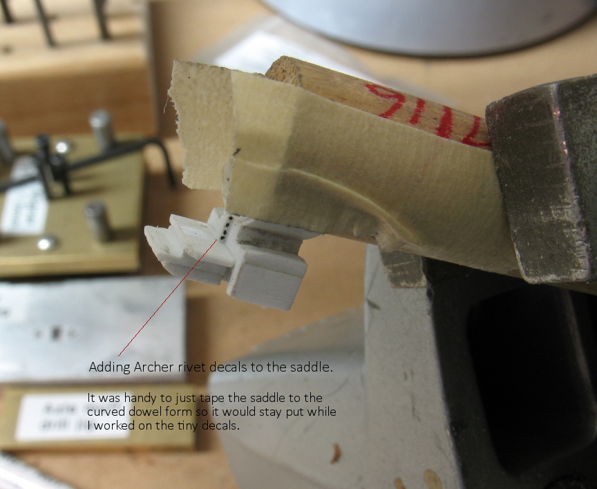

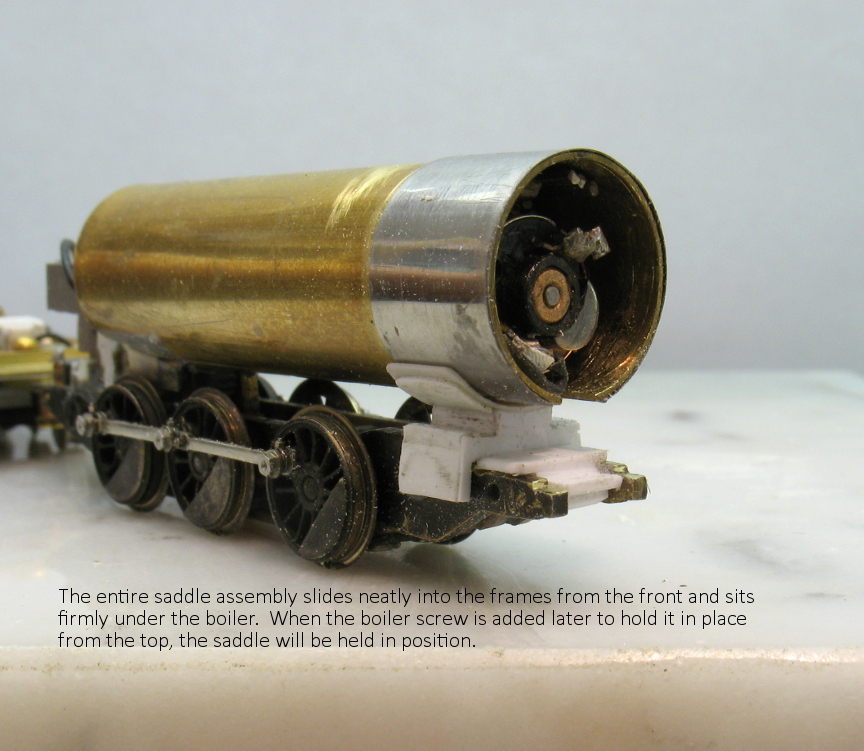

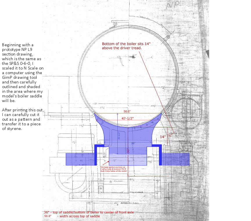

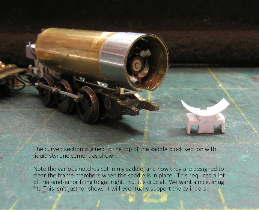

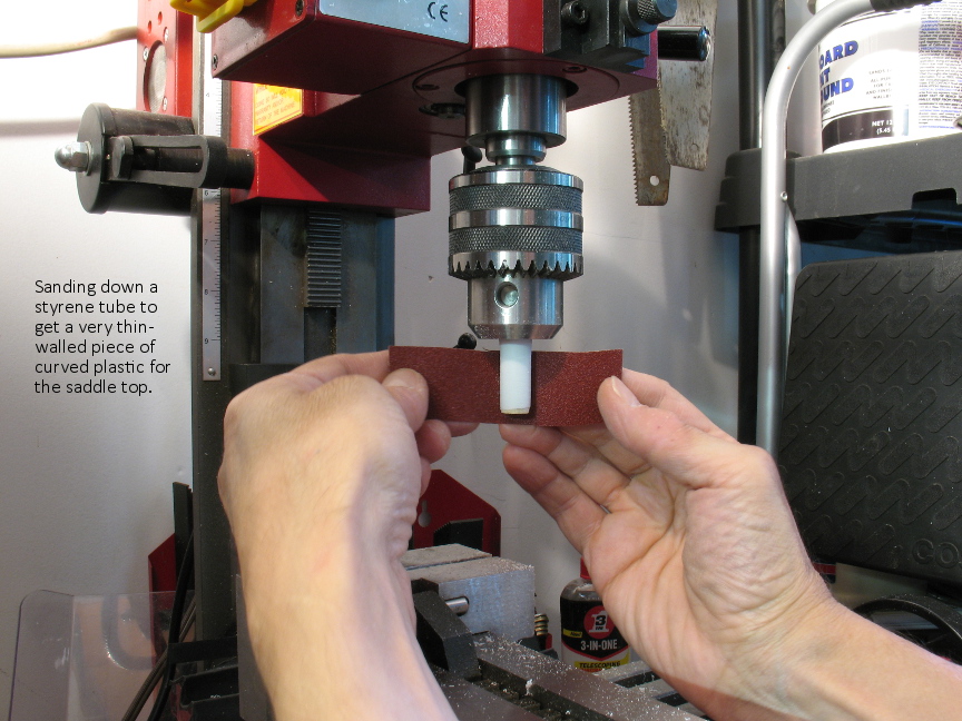

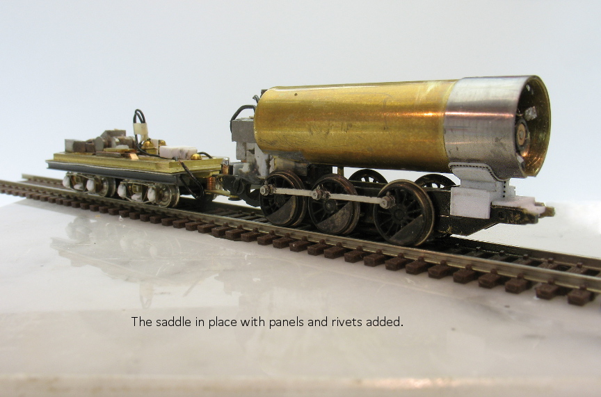

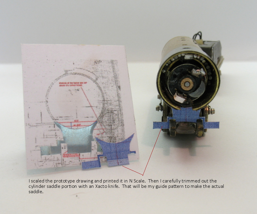

1. The Saddle

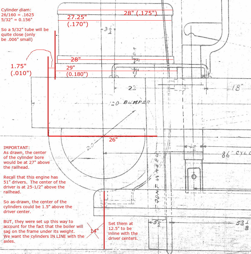

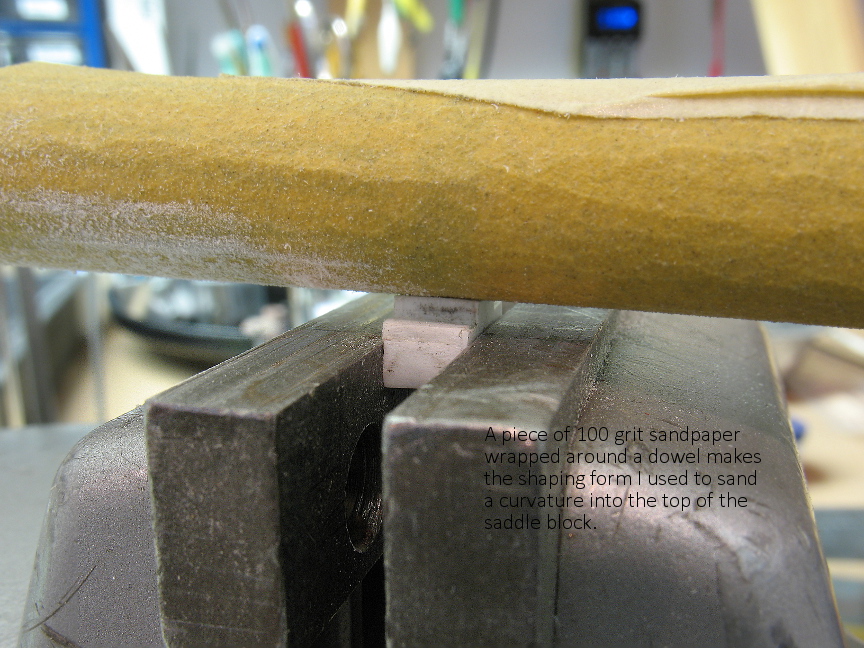

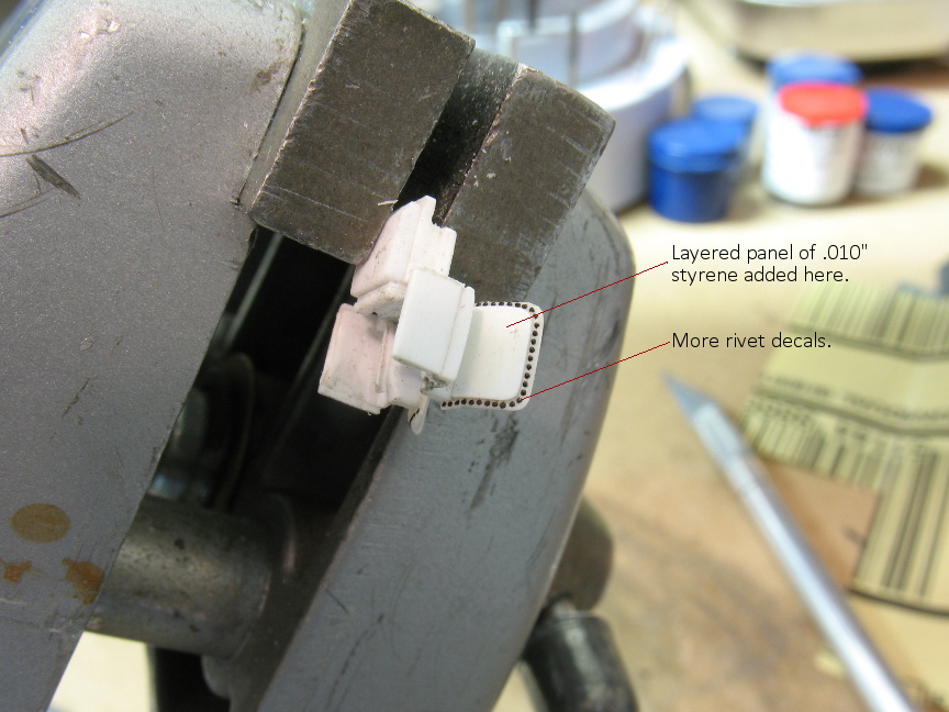

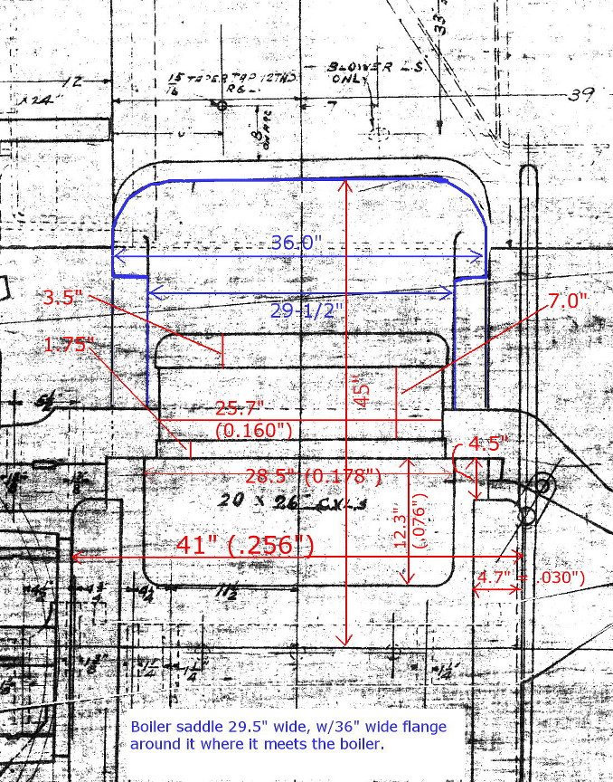

First, I scaled, studied, annotated the prototype drawings to make a pattern for the saddle.
Now, to start making the saddle.

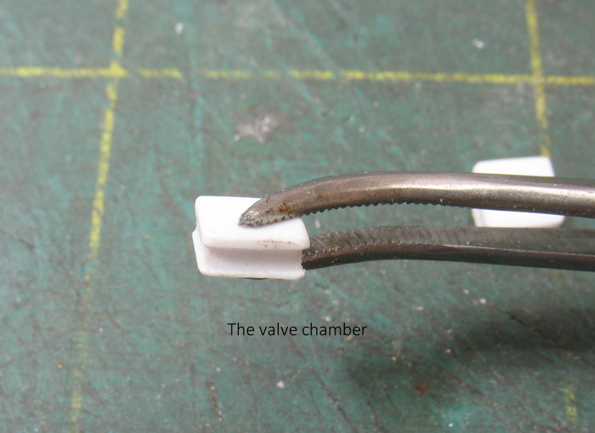

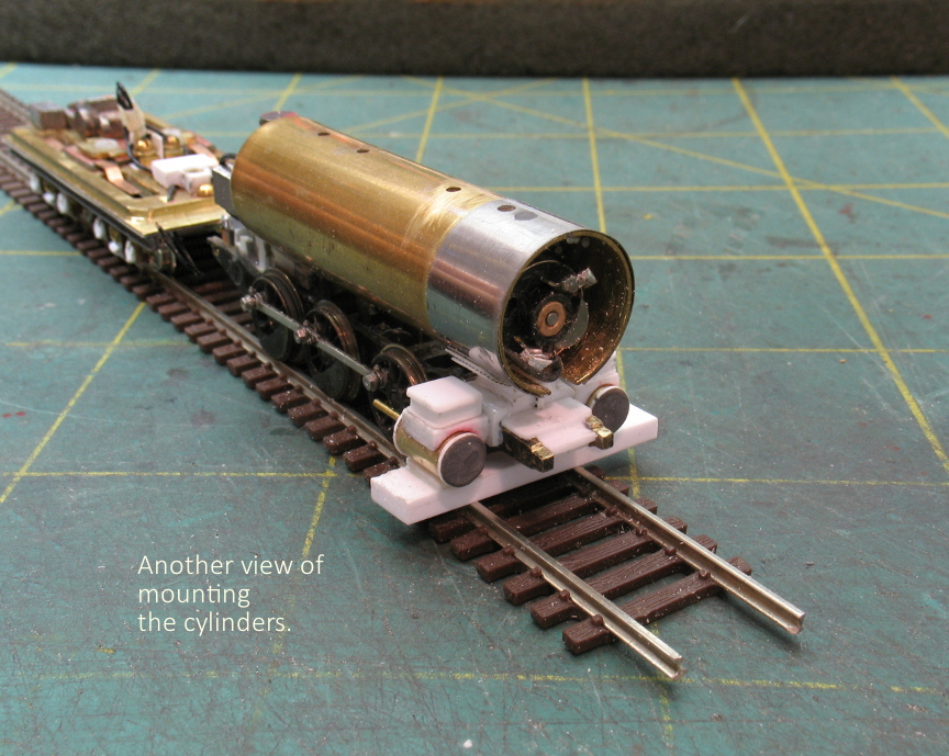

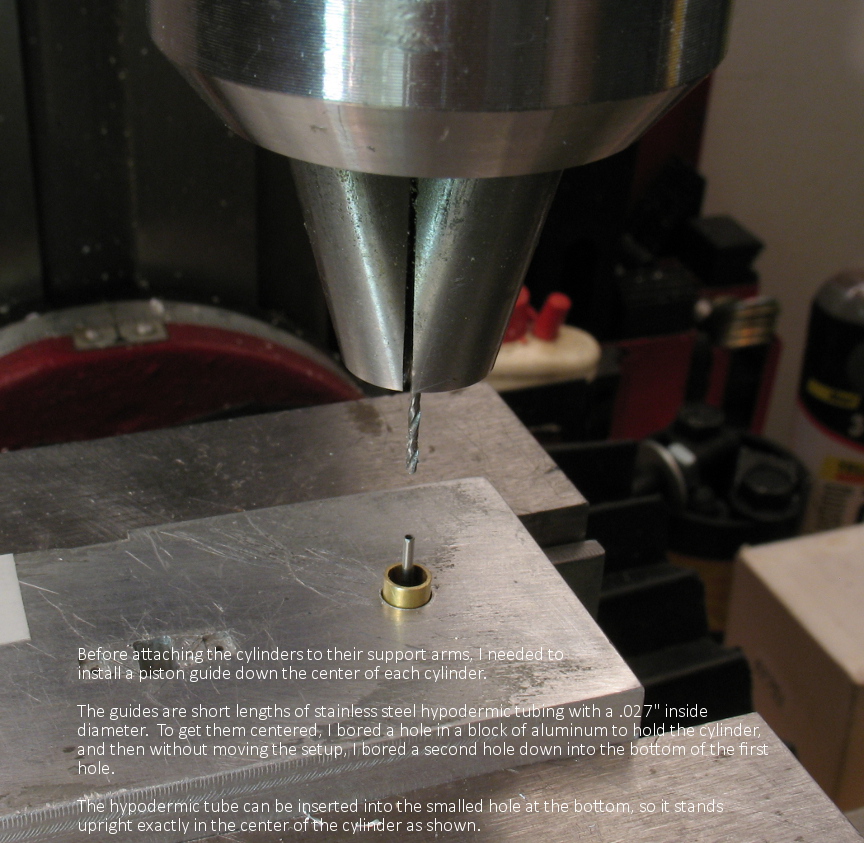

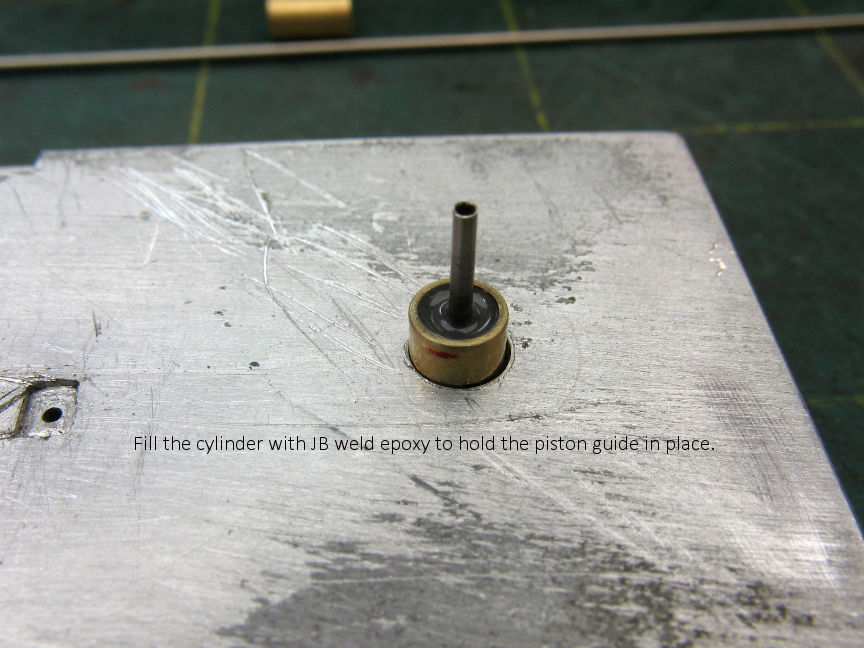

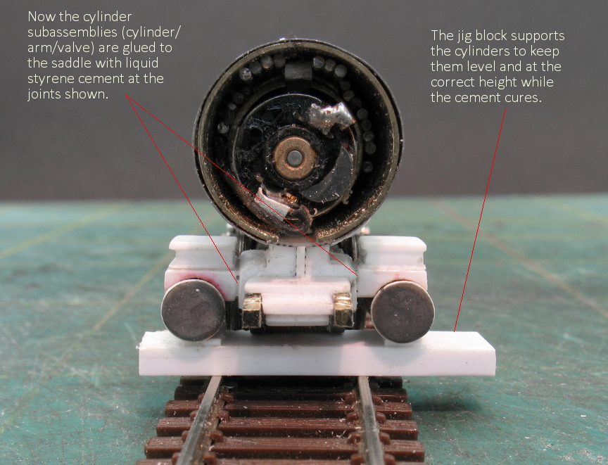

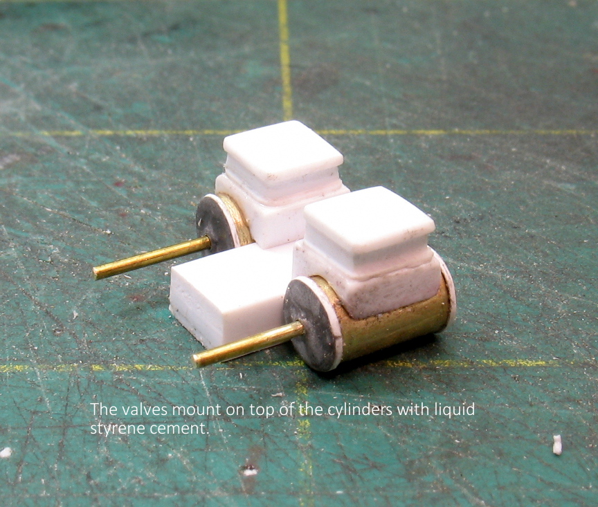

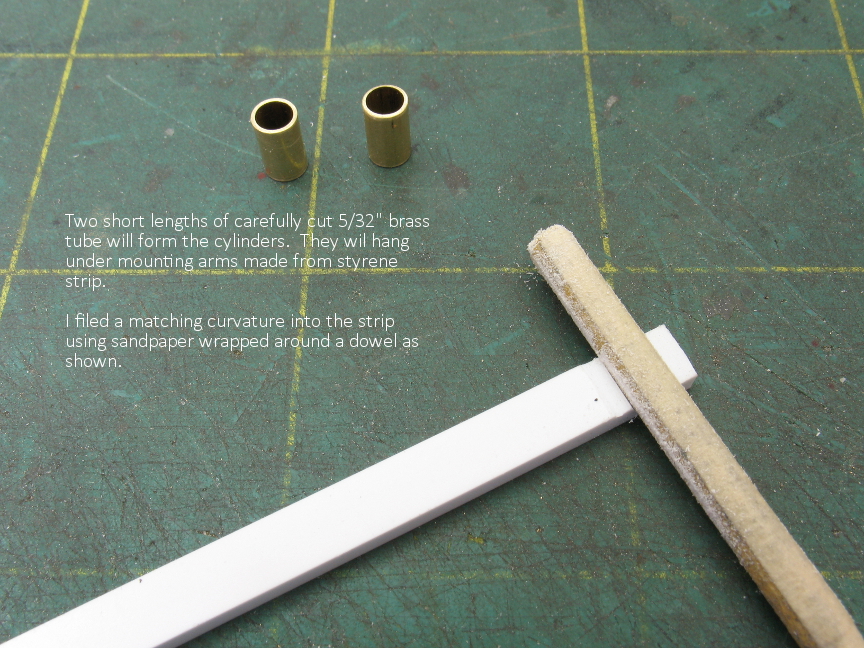

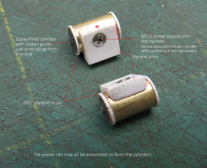

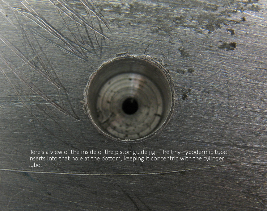

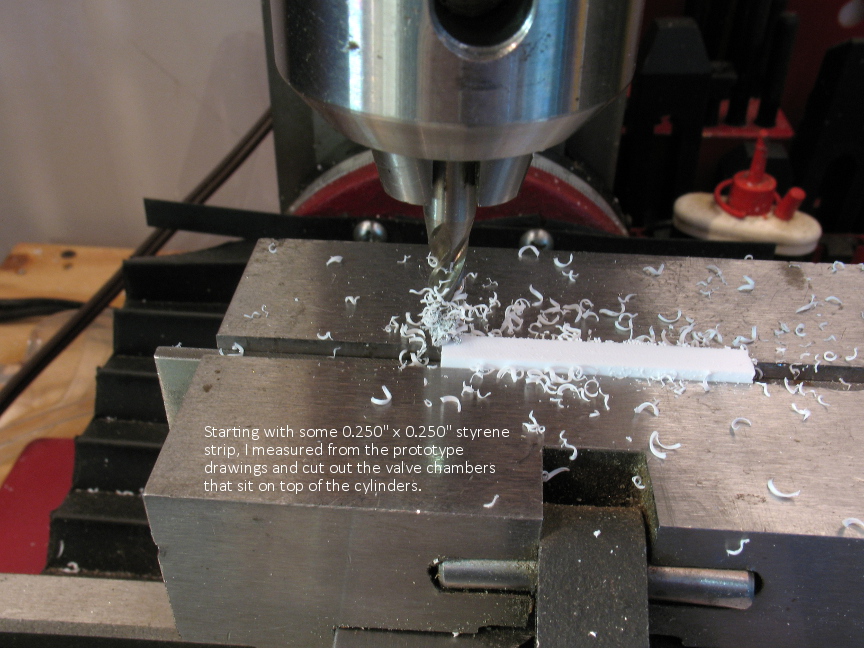

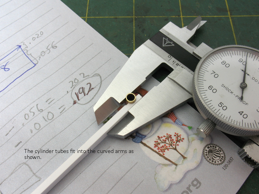

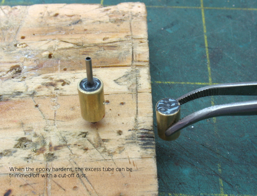

2. The Cylinders
There is a very definite reason for making the saddle and the cylinder supports out of styrene.  Remember, this is a brass split-frame engine.  The driver rods will push in and out of the cylinders, and I was afraid that I would end up with shorts from the drivers, through the rods and cylinders.  As it turns out, the cylinders are full of epoxy and would have insulated the rods just fine.  But I didn't know I was going to make the cylinders that way when I built the saddle.   I say all this just to give you some insight into the way this project is evolving.

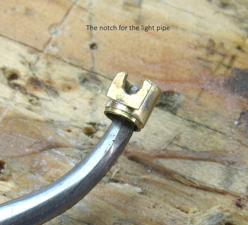

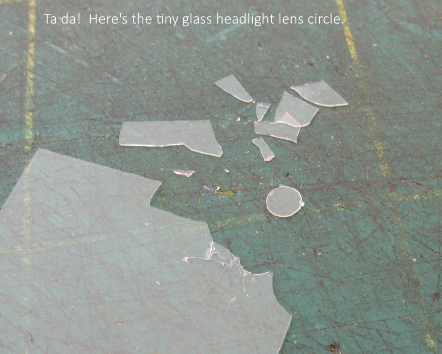

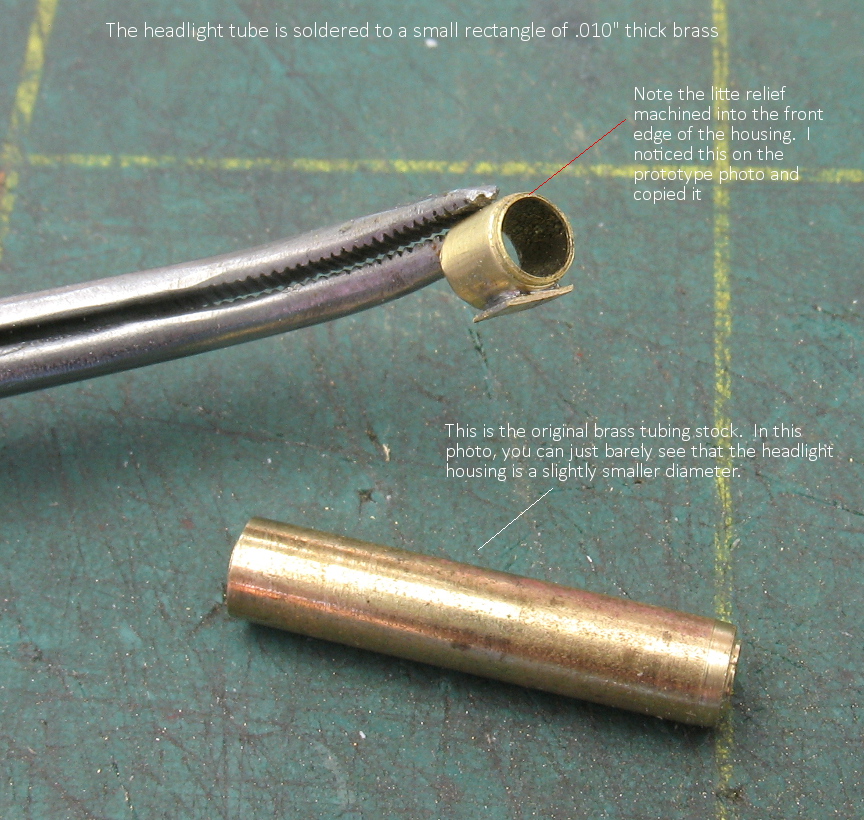

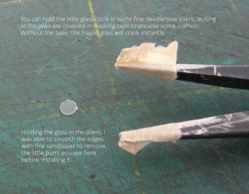

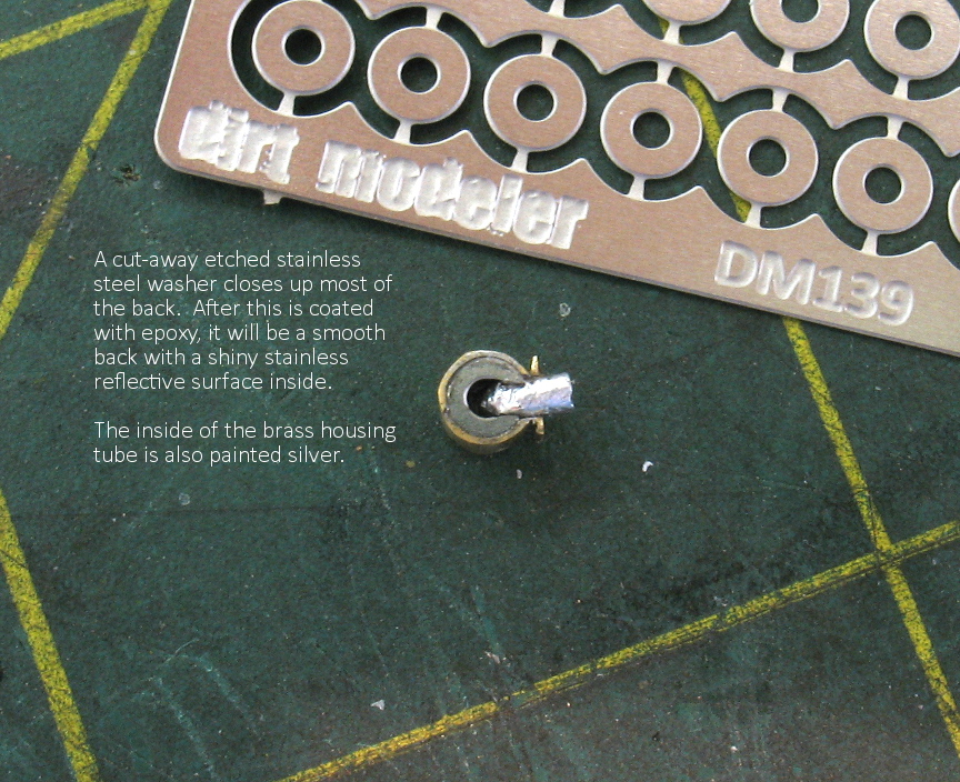

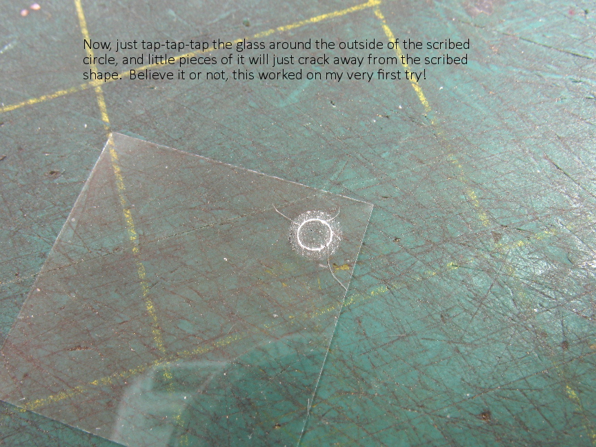

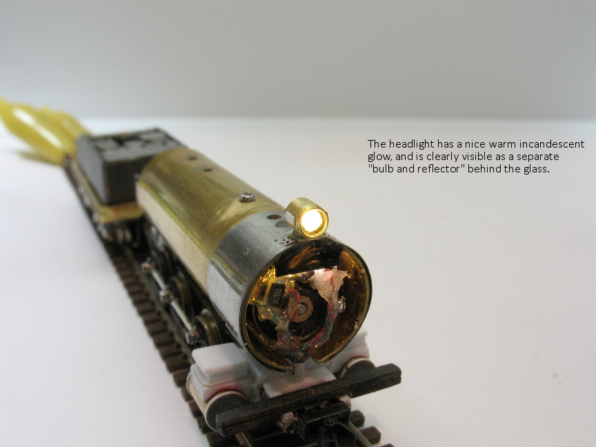

3. Headlight

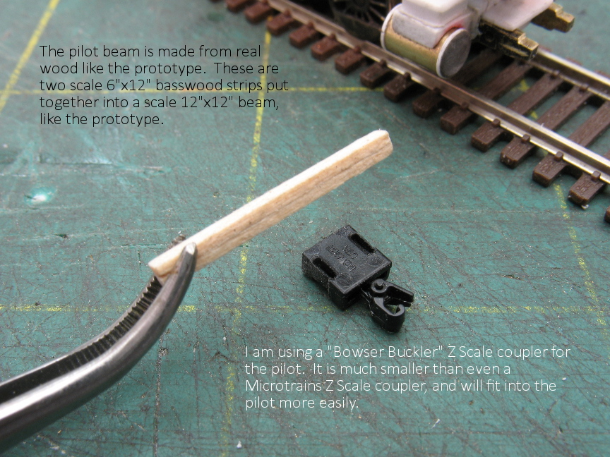

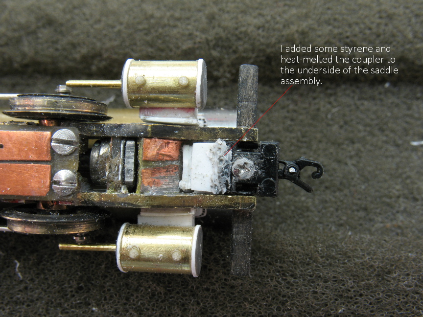

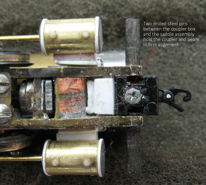

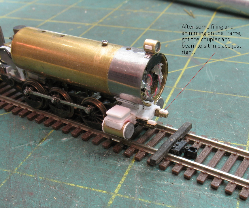

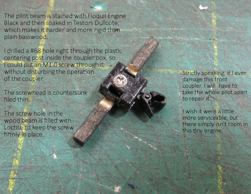

4. Pilot Beam
This is just the functional part of the beam - meaning it has to fit in place on the frame and support the coupler.
I will add the metal brackets that drop down from it and the pilot steps and coupler lift lever details much later
in the project.
