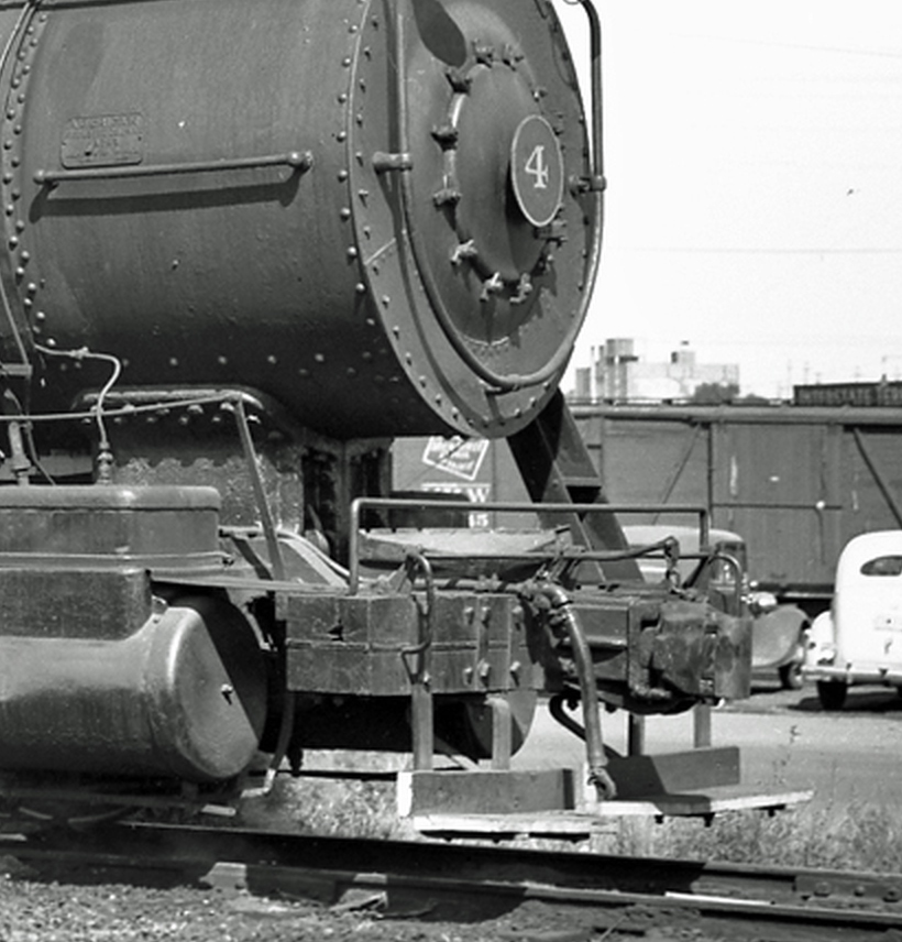

Just out of curiosity, why not move the coupler box back a bit to mount to the saddle itself?  That way, you won't have as much sticking out the front.
  • Posts: 6507
  • Respect: +2025
« Reply #151 on: September 17, 2016, 11:25:47 PM »
Fair question.   It's because the real coupler actually does stick out like that.  If you look at the prototype photo on page 1 of this thread, the coupler actually has the look of a coupler "box" sticking out from the pilot beam.
Here's a close-up of the area in question:
And the coupler box has a slight lip at that point so it was a good spot to put it.  It's probably a little further out than the actual prototype, but remember, it will have pilot steps under it so it will not look so far out when those are in place, and it has to clear the steps so it will work in a practical sense when coupled to rolling stock and on curves.
This engine is tiny, and even using a Z scale Bowser Buckler, which is about the smallest thing there is, the real problem is that the coupler itself is quite oversized compared to a prototype coupler... just something we still have to live with in N Scale.
I'm back... heh heh...

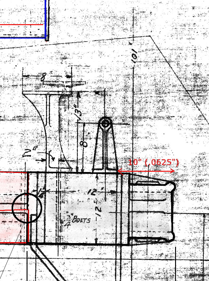

I measured how much my coupler box actually protrudes there (and of course, I will fill in that hole on top of the box where it sticks out!)...   It sticks out .080"
According to the actual drawing, it should be 10" or .062 in N Scale.   Okay, so mine sticks out .018" more than
prototype.  I'm content to let that go in the interest of practical operation.

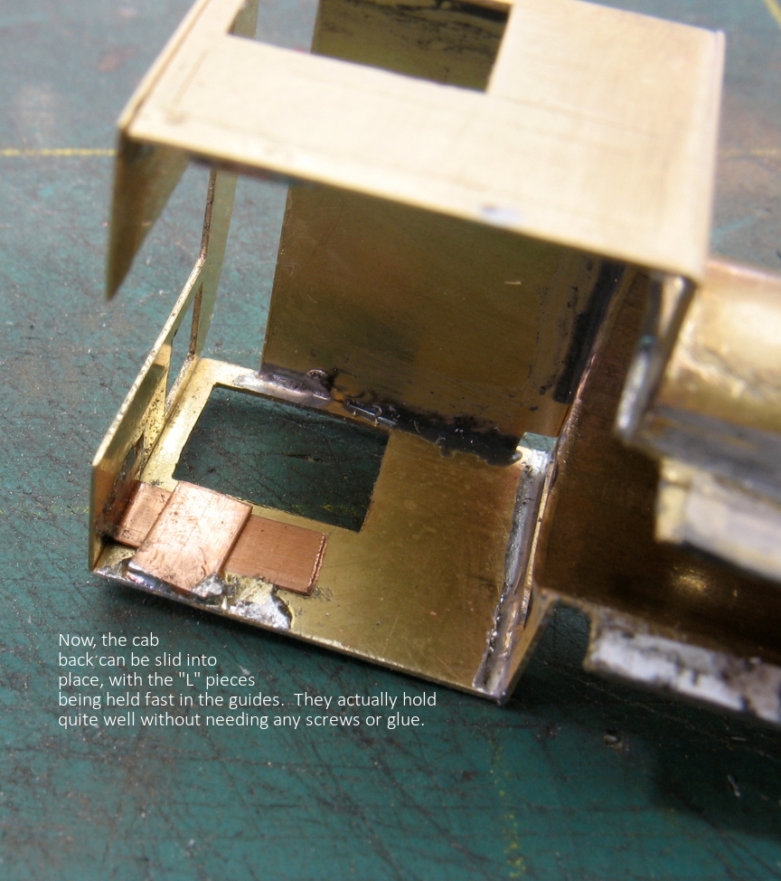

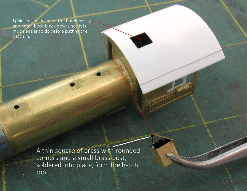

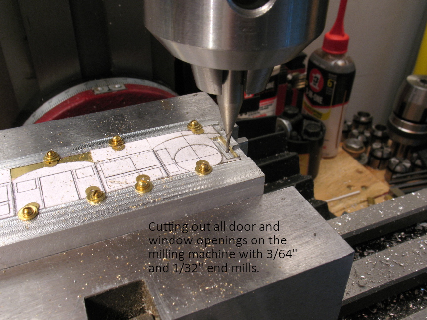

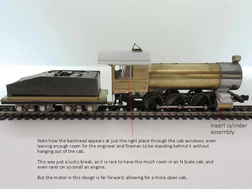

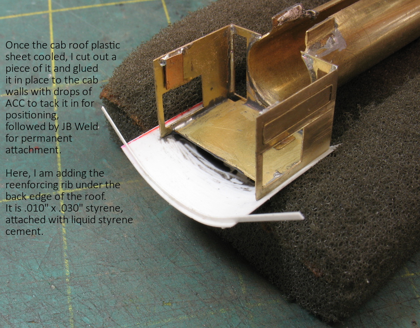

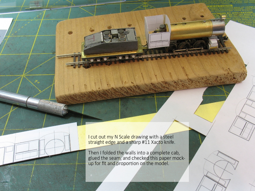

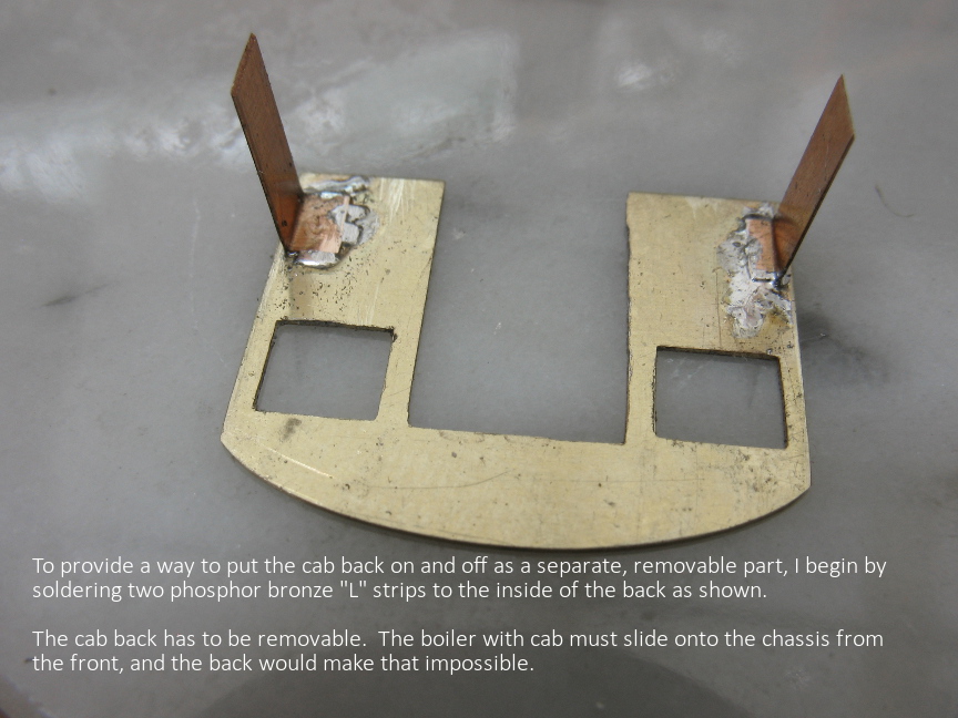

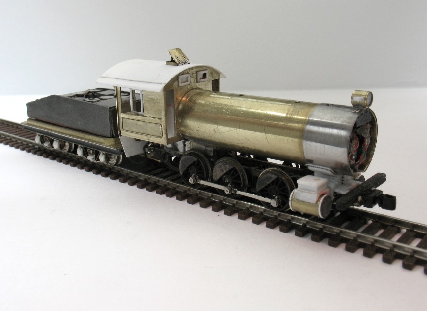

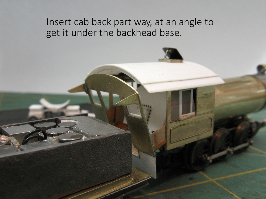

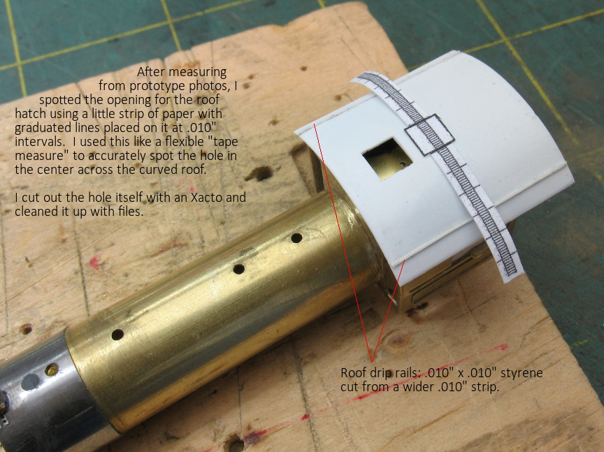

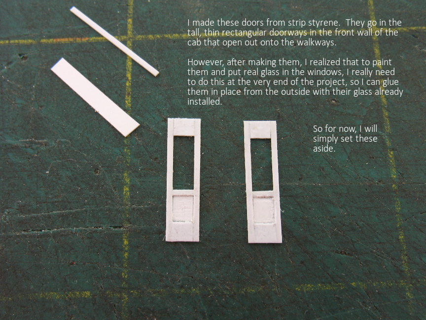

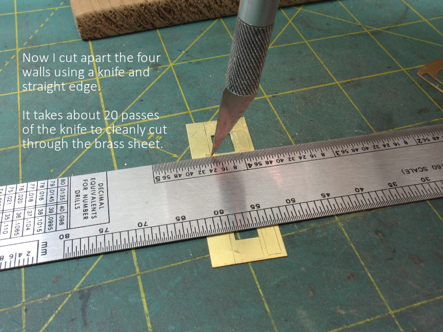

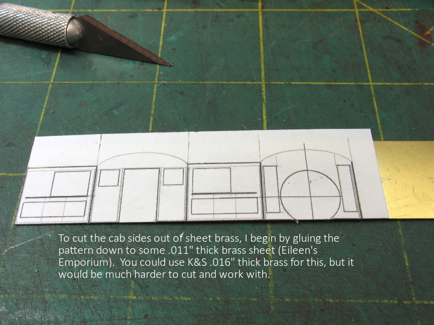

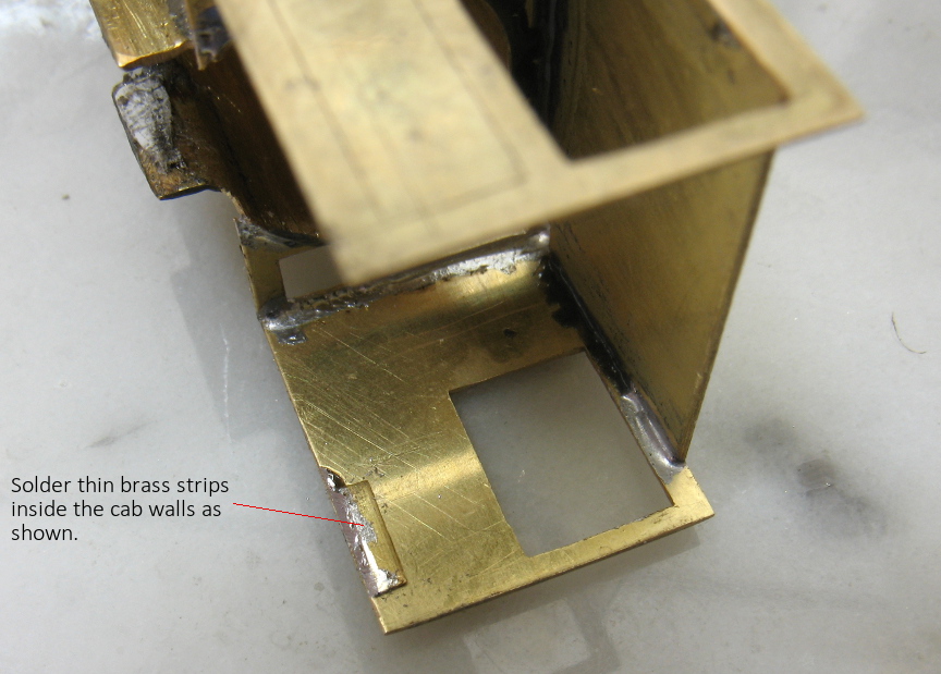

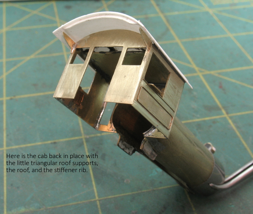

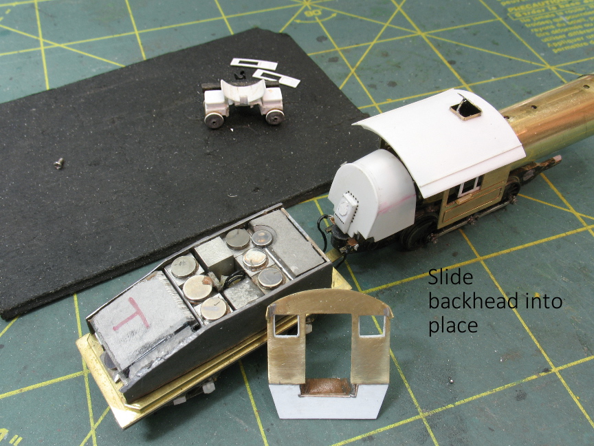

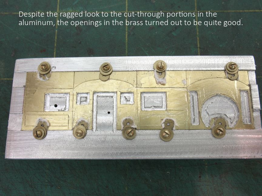

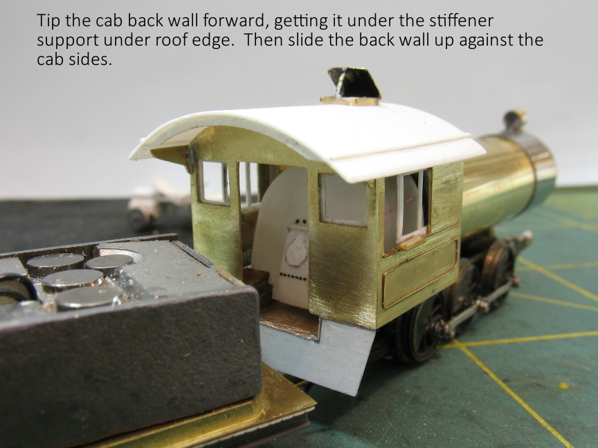

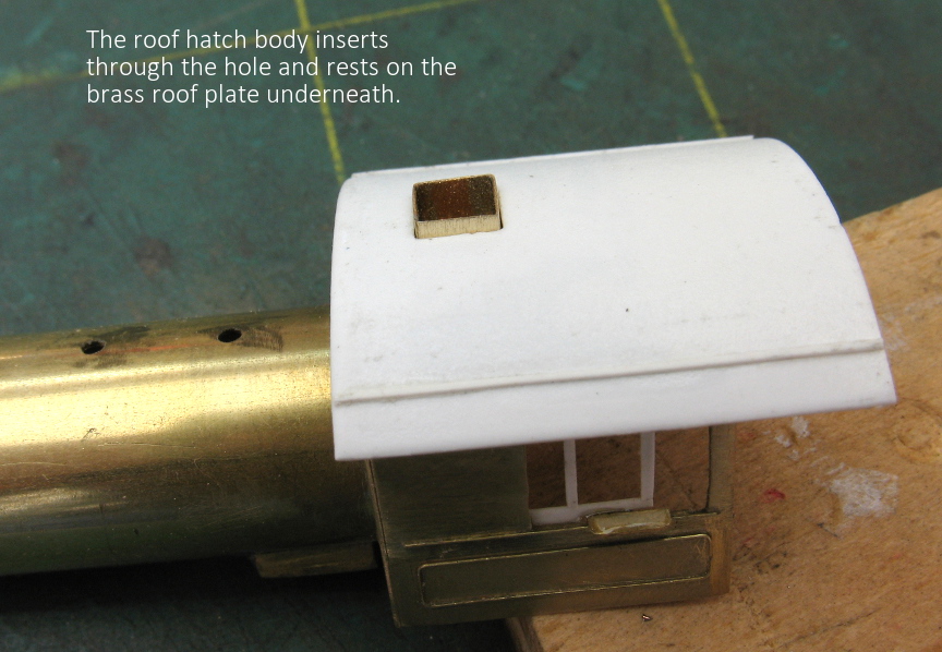

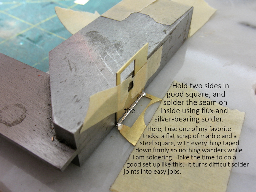

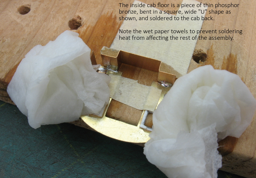

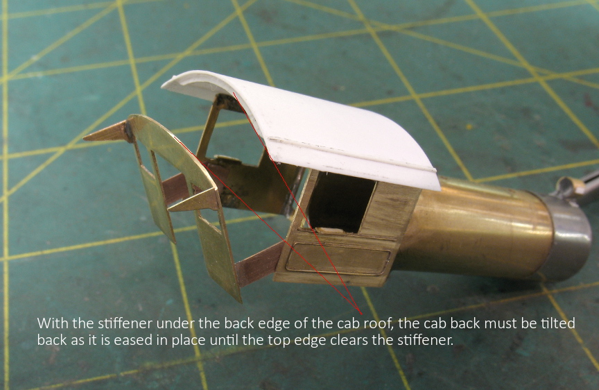

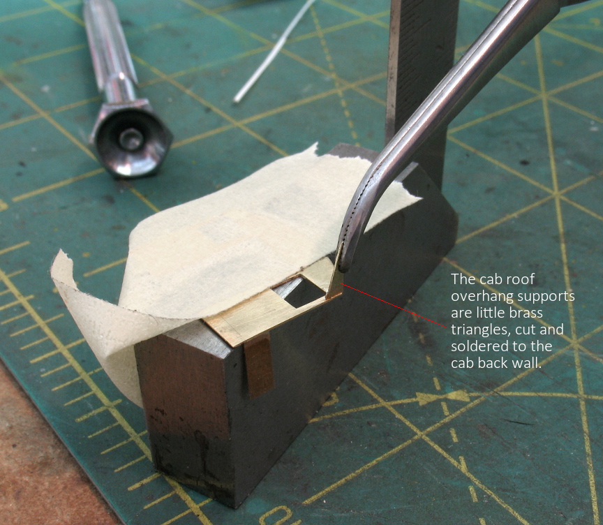

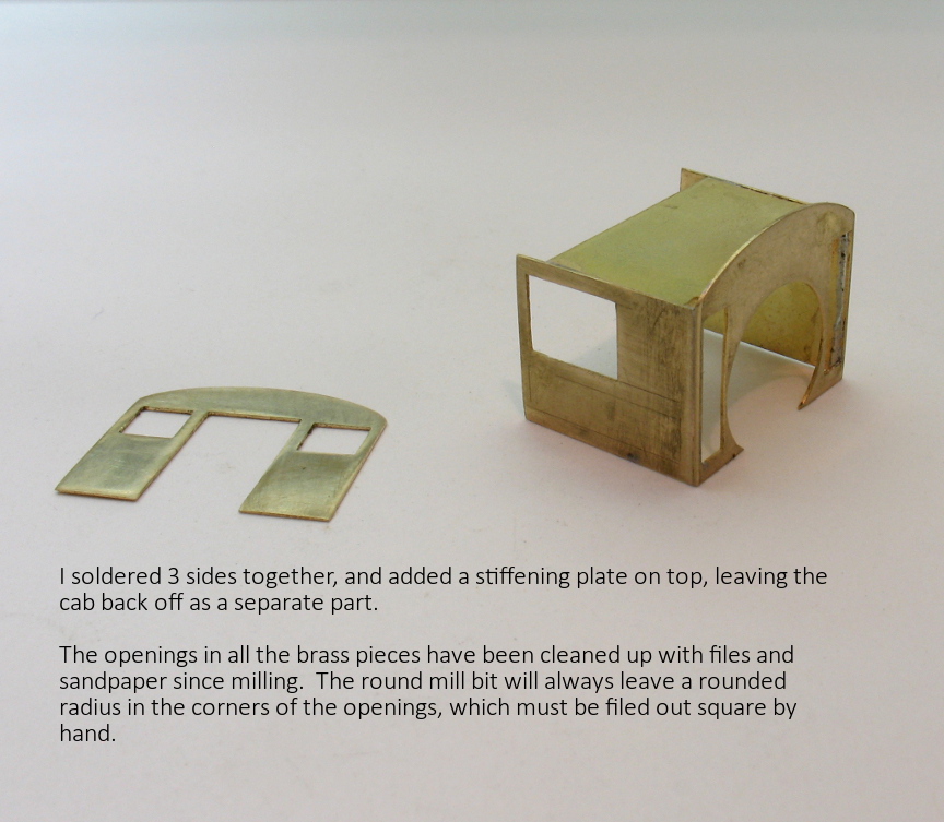

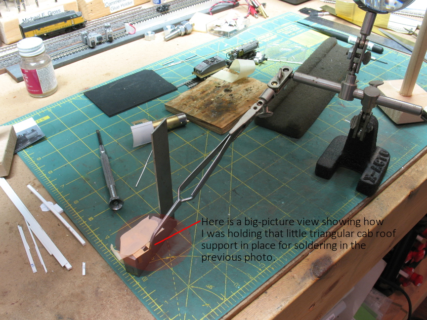

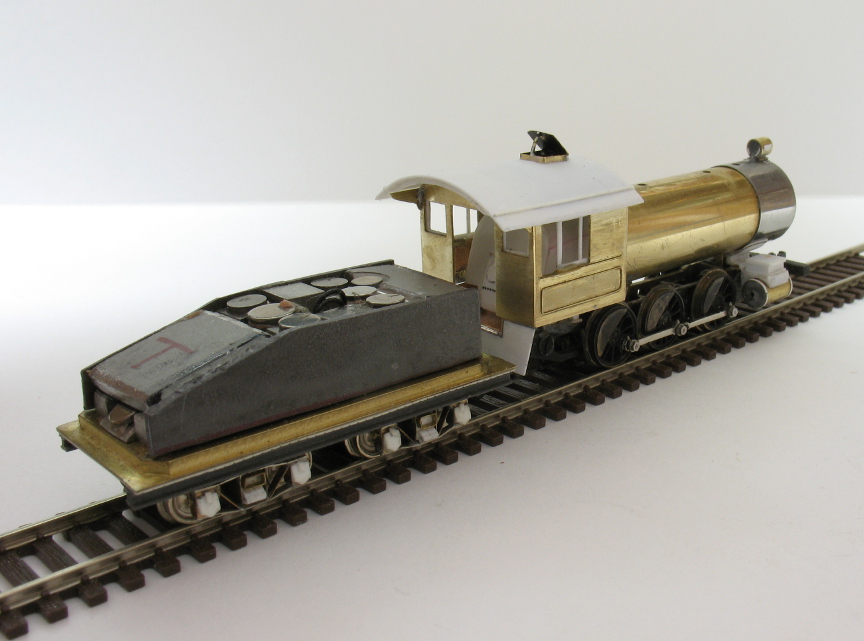

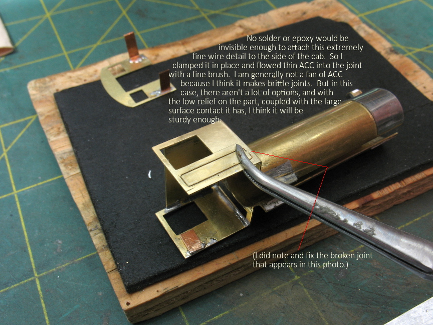

« Reply #163 on: October 08, 2016, 05:39:45 PM »
+9
Happy Saturday, everyone!

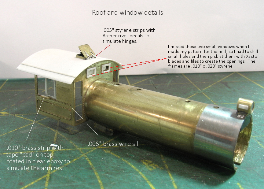

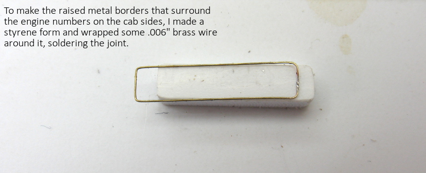

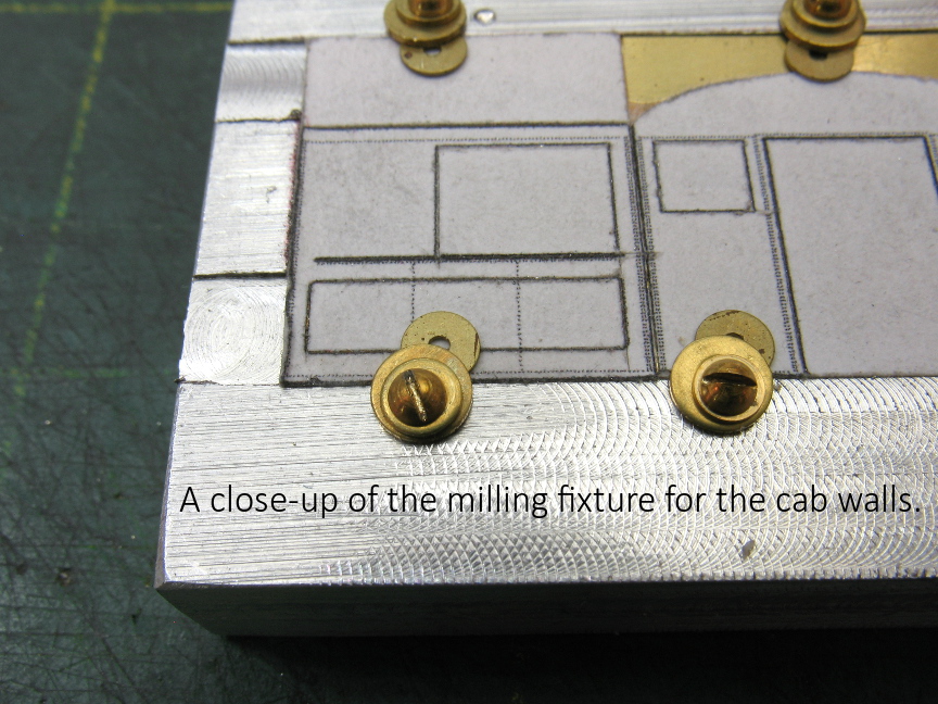

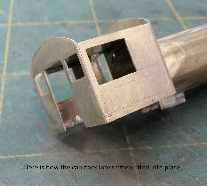

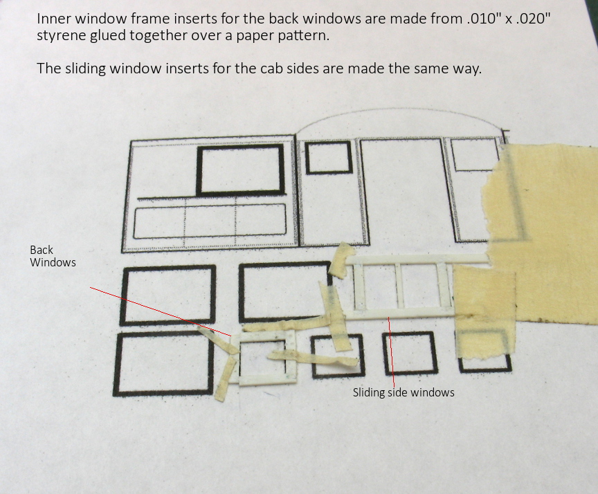

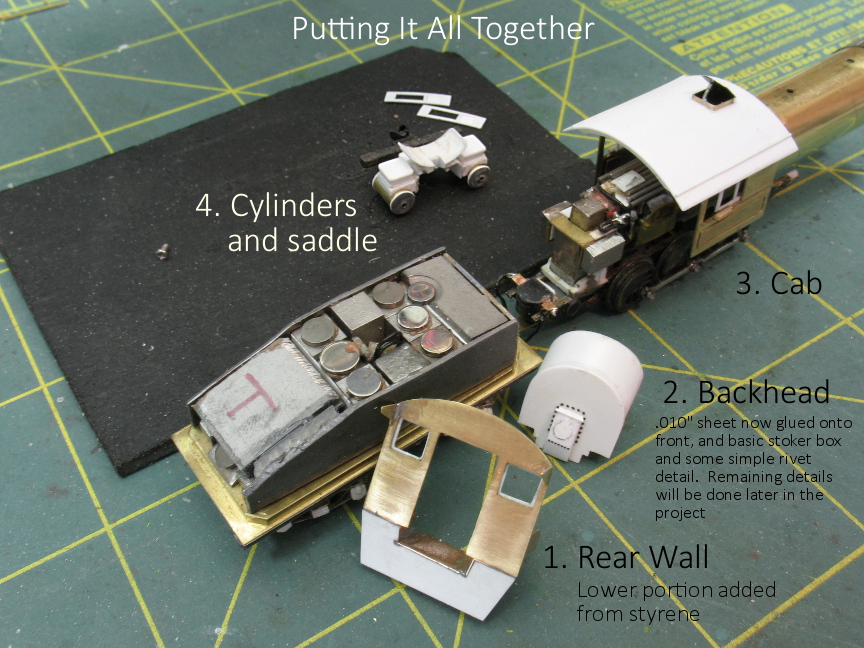

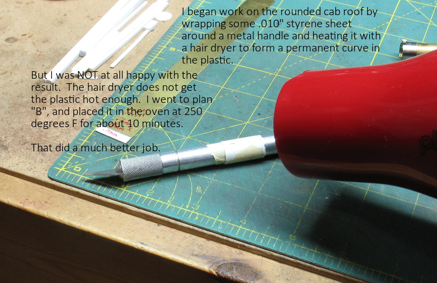

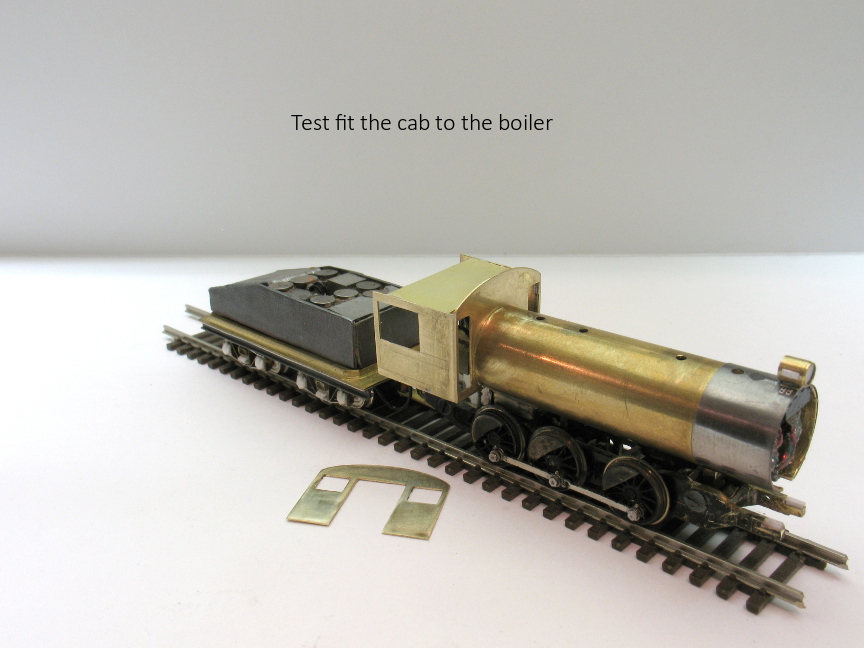

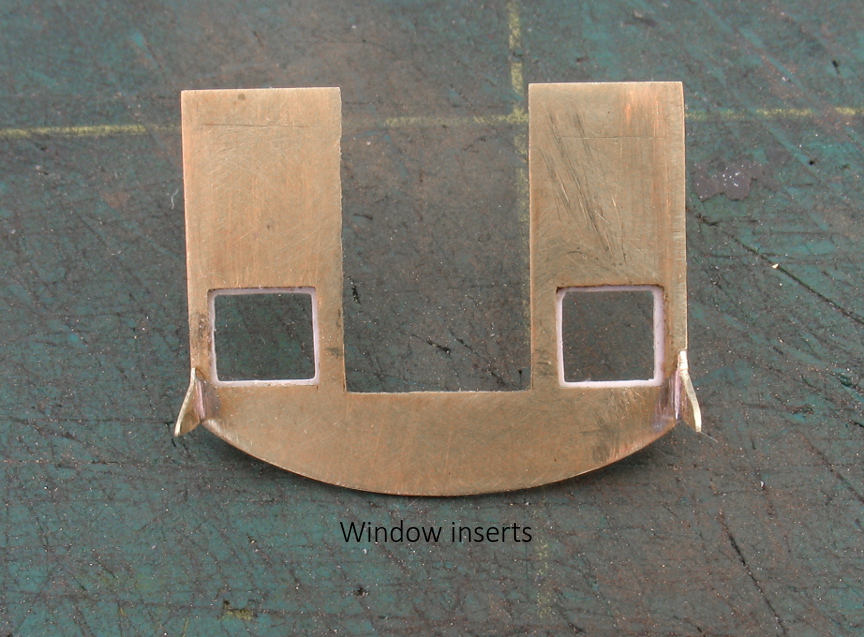

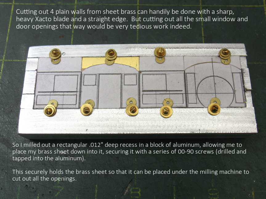

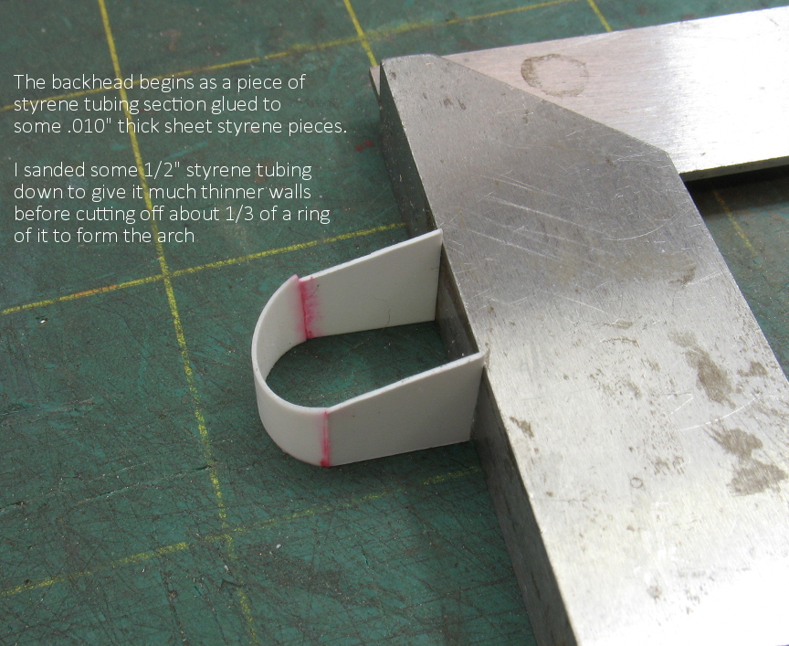

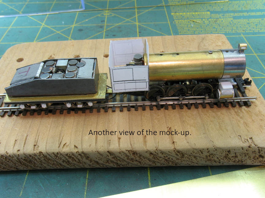

This installment covers the construction of the cab.

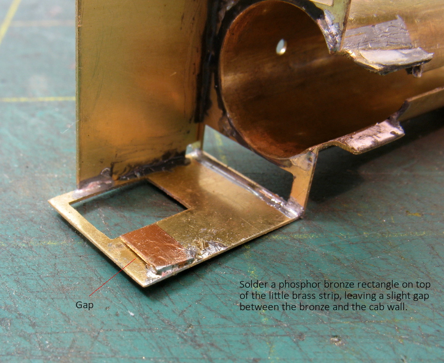

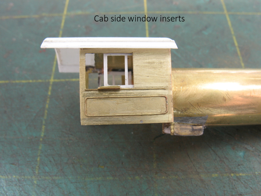

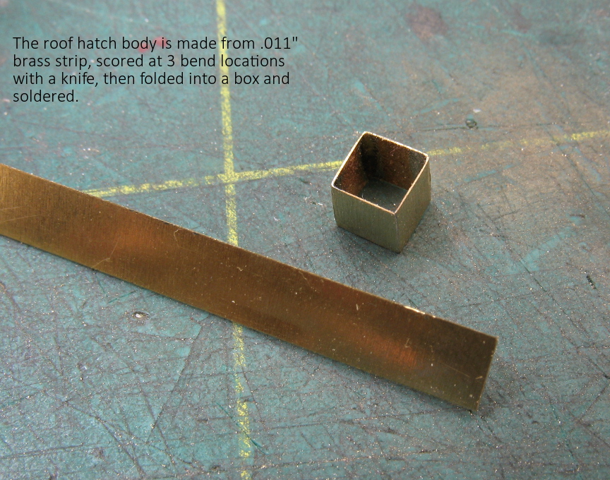

As I am going through this project, I am trying to get as much of the basic detailing done as possible on each sub-element.  But I cannot put on items that might easily be damaged while I am testing and working on the engine.  So while I have applied some rivet detail (Archer decal rivets), I am only doing it in hard-to-access areas where it is easier to get it done now, and when the rivets are being applied to styrene.  For places that are on the outer surfaces, and especially on brass, I am holding off on the rivets because they don't stick as well to brass and won't be durable until I can paint over them.
Other than rivets and superdetailing the backhead, I tried to get the cab as complete as possible.
I had to remove a few grams of tungsten weight in the rear of the engine to make room for the cab, but as it turns out, the cab itself weighs more than those weights, so I ended up with a net gain of +2g anyway.

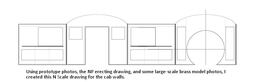

Another nasty complication on these SP&S engines is that while they were largely knock-offs of GN or NP (and this engine is an NP L-9 0-6-0), the cabs were usually changed out while the engines were in service.  In the case of these 0-6-0's, they were delivered with NP cabs, but by the 1940s, they had all been changed over to GN style cabs.  In fact, many got that treatment much earlier.  So it is far more correct to see these engines in the late 40s and early 50s with the GN cab.
No drawings exist that I am aware of for the replaced cabs on these SP&S 0-6-0's.  There are some GN 0-6-0's that look very similar, but while I have GN books with photos and loco "diagrams", they are not scale drawings.   So the cab had to be "gamed" from all the prototype and large-scale brass model photos and diagrams I could find.
On to the photos!
Now that the cab is in place, the next step is the tender body.  I'll be able to make sure I have it at the correct height relative to the cab, and get the cab-tender coupled spacing right so I can add the foot plate between them, and verify that it can negotiate curves.
« Last Edit: June 30, 2017, 03:52:10 AM by mmagliaro »
