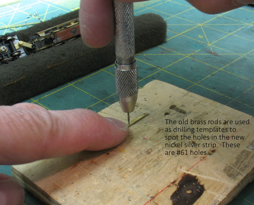

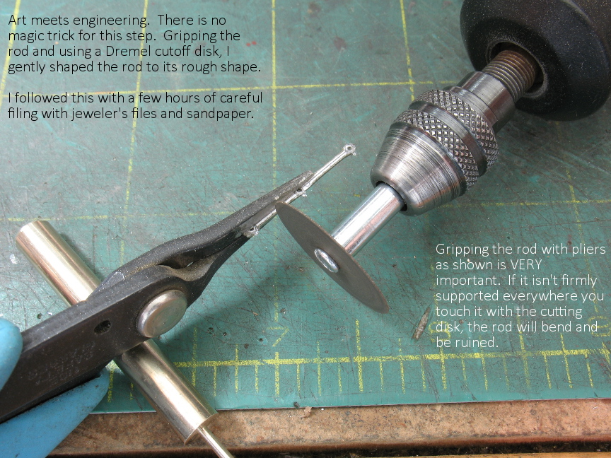

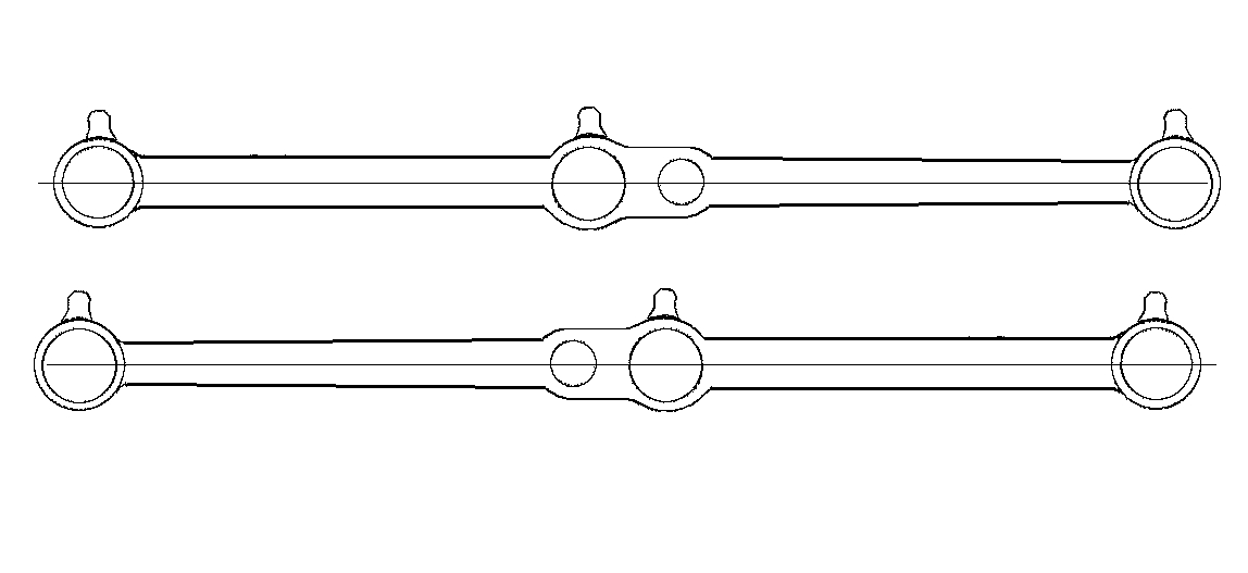

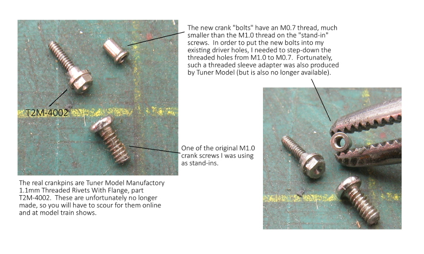

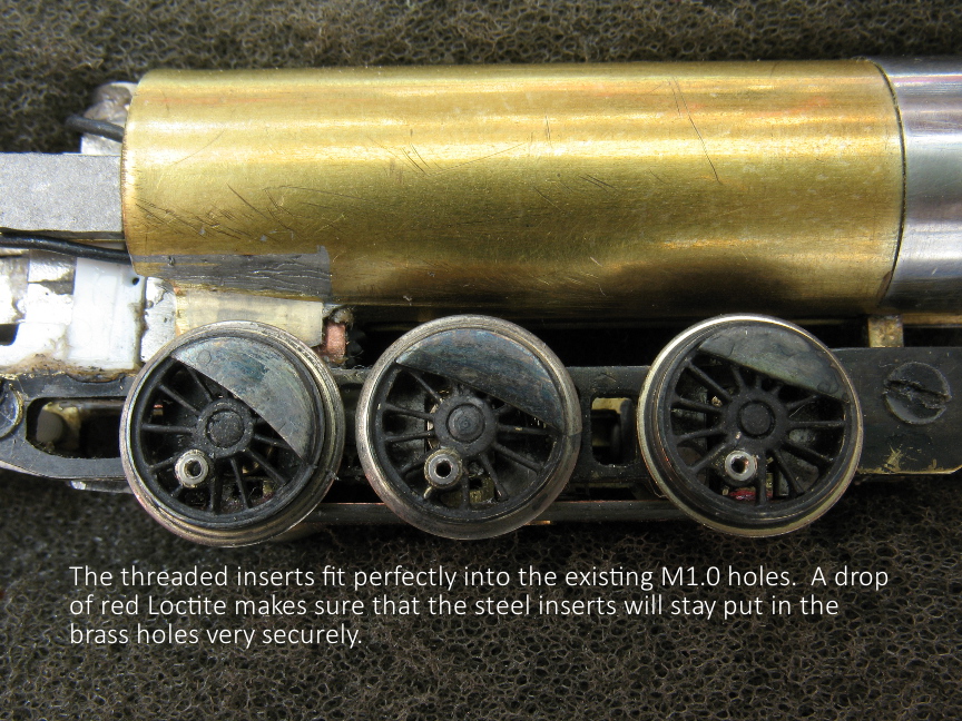

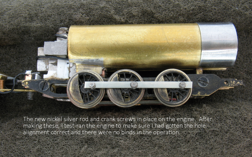

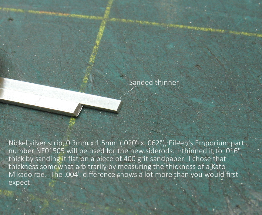

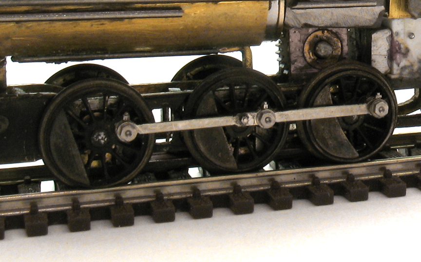

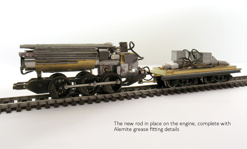

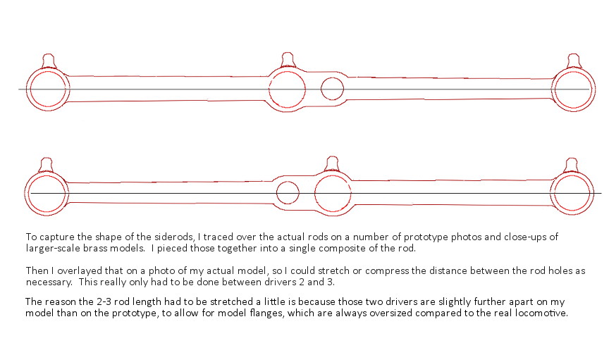

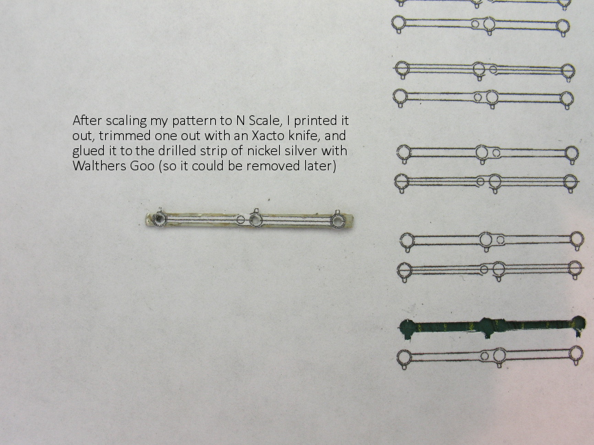

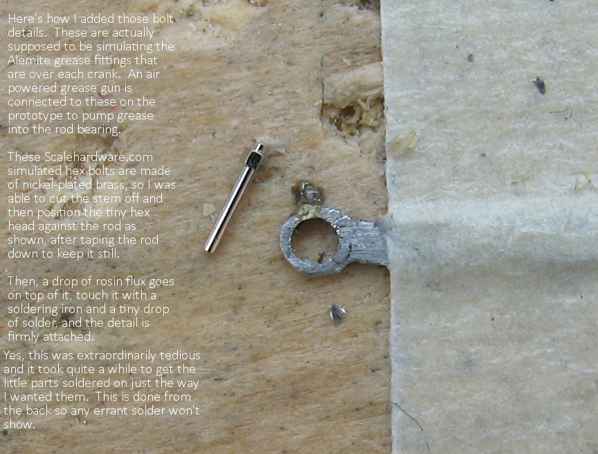

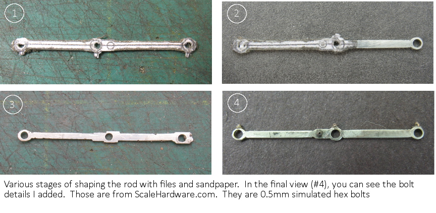

« Reply #115 on: May 18, 2016, 09:52:47 PM »
+14
A quick update.   This installment just covers the new "official" siderods.  I wanted to get this step out of the way before I start on the tender trucks, which will be a major, time-consuming piece of the project.
Those micro hex bolt fitting are completely optional, but... they sure are cool.  Those bolt heads are only 0.5mm across (.020")
« Last Edit: June 30, 2017, 03:41:09 AM by mmagliaro »

Definitely an up vote from me Max...wow, but I'm repeating myself...
Out of curiosity, why not use a wider disk? I'd be afraid I'd sneeze and cut off the handiwork in two :D
Keep'em coming, please.
Otto K.

Holy cow Max!  That side rod looks great.  You are definitely the master.

Max, looking great!  Seeing that Dremel wheel against that siderod brought back some memories.
